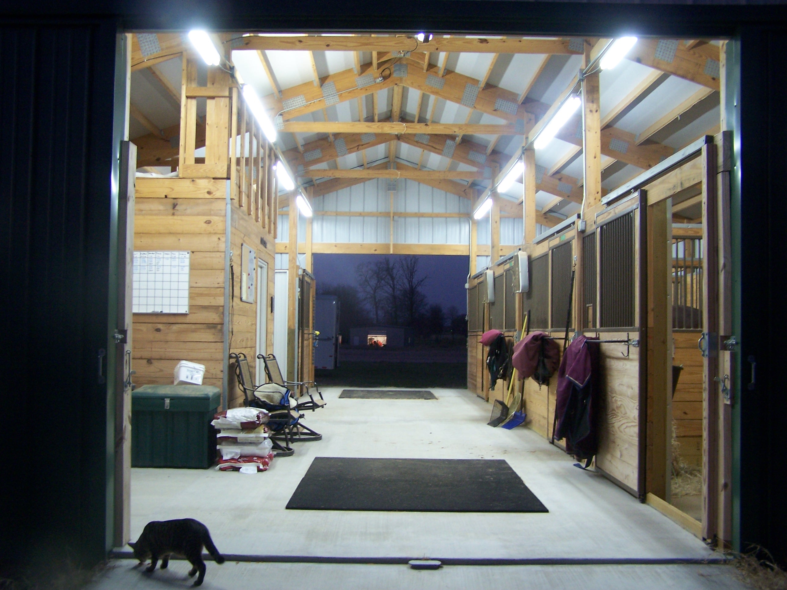

Depending on what you plan on doing it in the garage. If it is just parking and storage you might get by with those lights, each one would be covering a 20'X20' area. If you plan on doing any work I think you might be disappointed. I have 8 8' fluorescent fixtures in my 36'X48' stables. Each fixture has 4 T8 bulbs and covers an 12'X18' area.
Hi, You have a very nice horse barn:thumbsup:

Thank you all for the comments. I wish I could buy and try various options, but that isn't practical. Yes the horse barn looks terrific!!

I don't know the specific brand. They are standard commercial grade 8' naked bulb fixtures from the local electrical supply house. Each uses 4 4' T8 bulbs. They are 14' off the ground.
I measured the output tonight while feeding and cleaning stalls. It varies from 85 foot candles at the ends of the aisle to 140 foot candles in the middle. I cannot tell that much difference. I used the same fixtures in the garage on 9' ceilings and got from 65 - 120 foot candles.
That looks great Randy. Kind of looks empty too. Do you need more horses? I have too many!!!
   / I need new lights for my garage. What do you have, and what should I get? #35
Thanks for the kind remarks, no thanks to another horse. We have too many as well.
