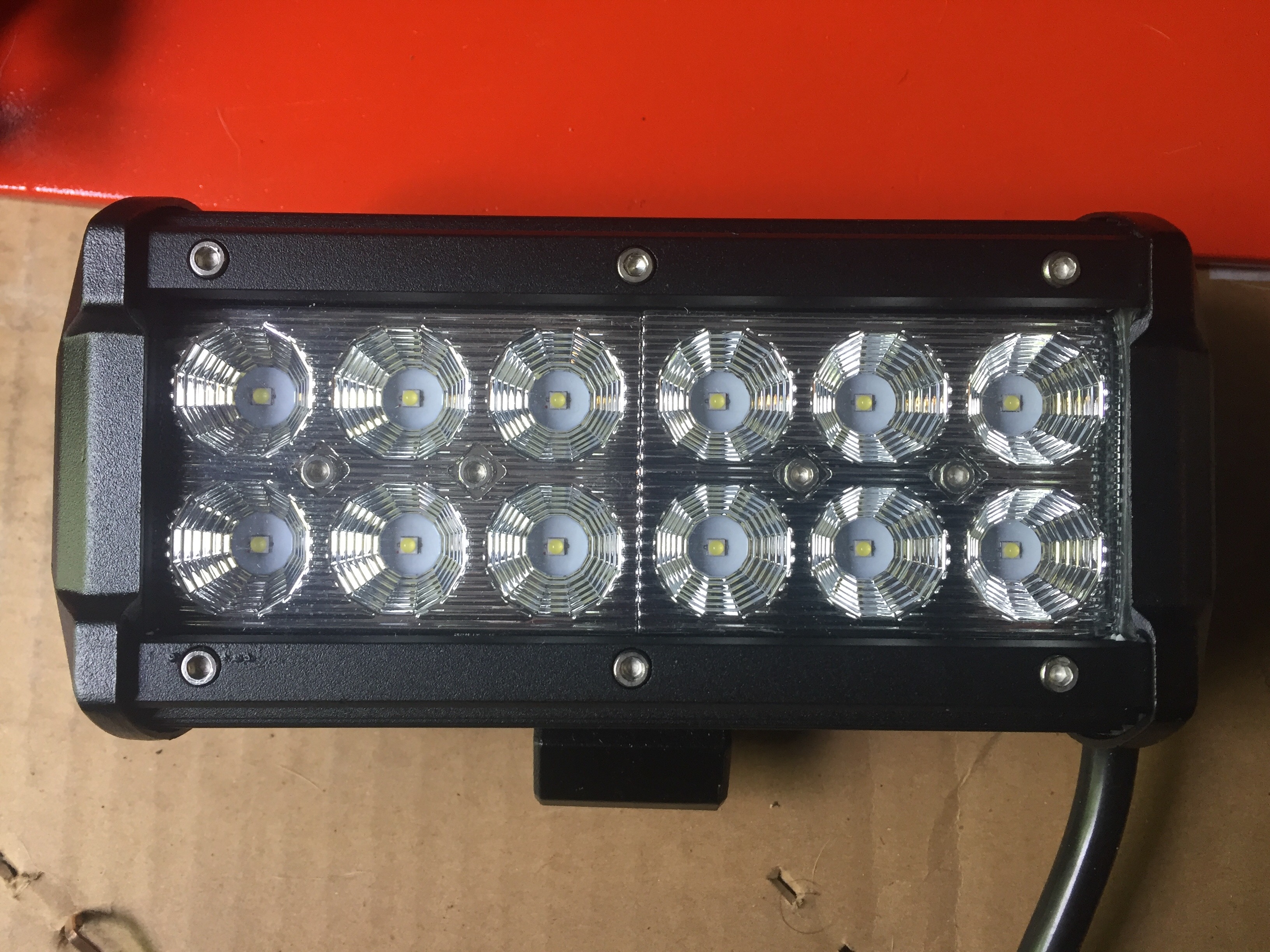

Currently changing the front and rear Kubota cab work lights on a L4740 to LEDs. For the front I am using 6.5" 36 watt flood lights as they are very similar in size to the Kubota lights, but the light output is considerable moret. Example of what I used:

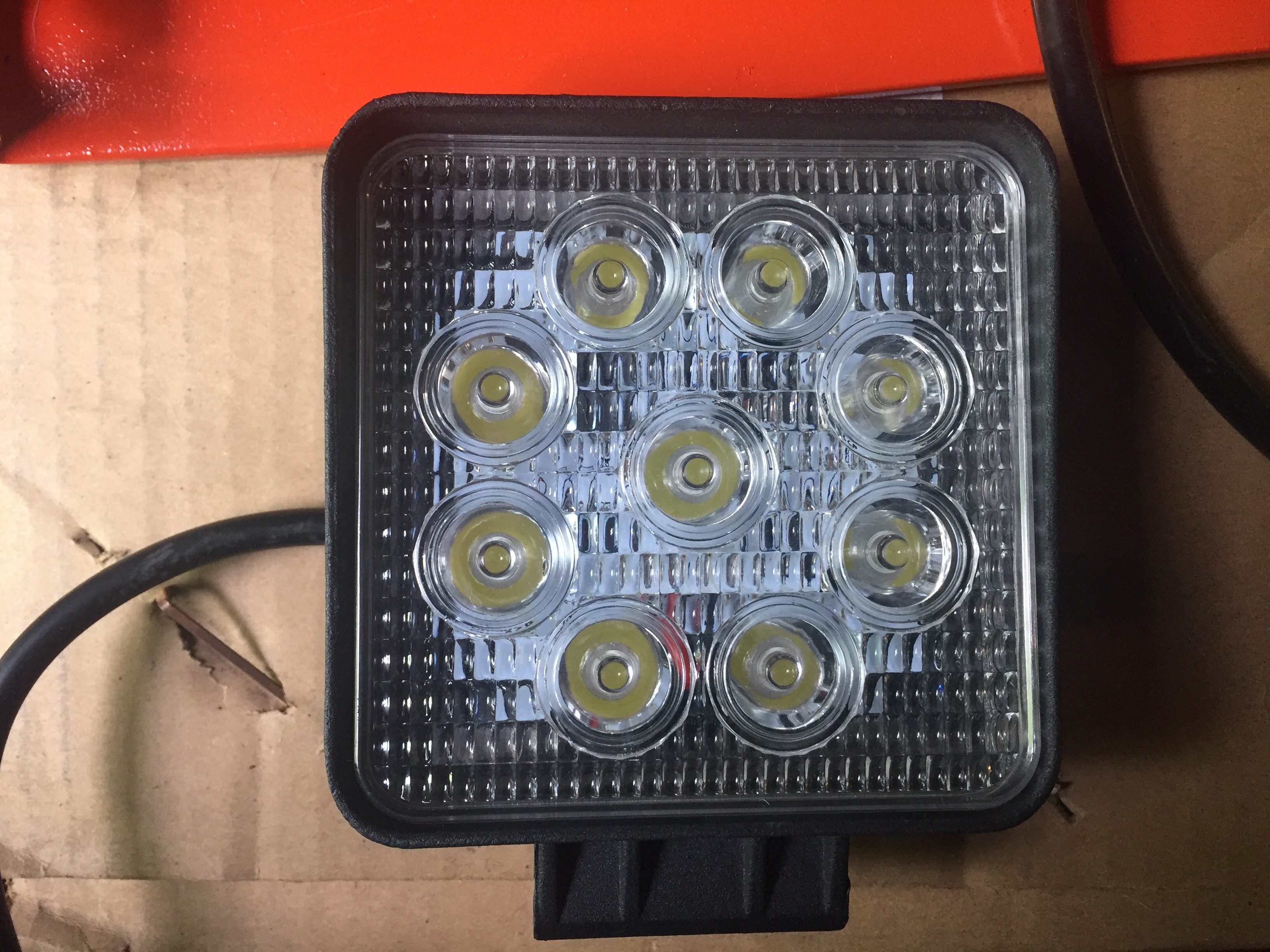

To illuminate the rear 27 Watt 4 square flood units are being utilized.
(Example: Amazon.com: KAWELL 1 Pack 4.5" 27W Square DC 9-32V 6K 18LM 6 Degree Flood LED Work Light Lamp for Off Road High Power ATV Jeep Wrangler 4x4 Rv Trailer Fishing Boat Tractor Truck (pack of 1): Automotive)

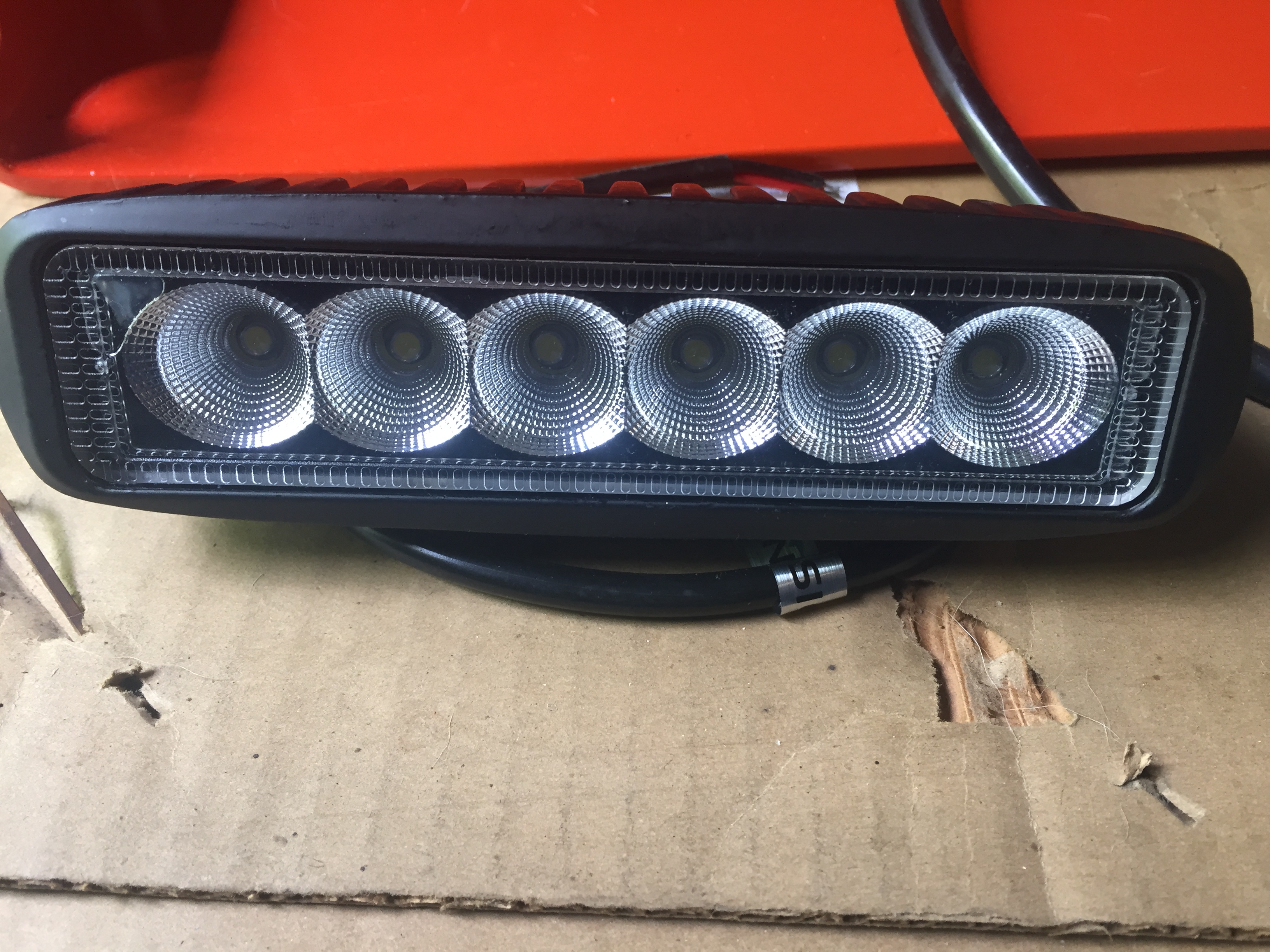

And to illuminate the sides, 18 Watt flood lights.
(example: Amazon.com: KAWELL 2PCS 18w LED Work Light Off Road Led Lights Bar Fog Driving Bar Jeep Lamp (2 Pack Flood Black): Automotive).

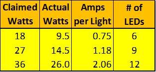

Current draw for each lamp was measured using 12.60 supply voltage. Not surprisingly the claimed wattage fell short of reality. Not saying this is bad as the light output is many times better than stock, but the actual current draw is less. Below are the test results per work light, so if using them in pairs the values would need to be doubled.
Claimed Watts___Actual Watts___Amps/Light___# of LED's
___18_____________9.5__________0.75__________6
___27____________14.5__________1.18__________9
___36____________26.0__________2.06_________12
Over the last two years I have been using the 18W and 27 W units on my JD Gator and as backup lights on a number of vehicles. Out of 10 units I've had one go bad due to moisture and salt intrusion (auxiliary backup lights mounted off the trailer hitch). The failed unit was replaced under warranty.
These lights are inexpensive at <$25 per pair.
Do I believe the claimed lumen output? No way. But the light output is multiple times better than stock 55 watt halogen bulbs.

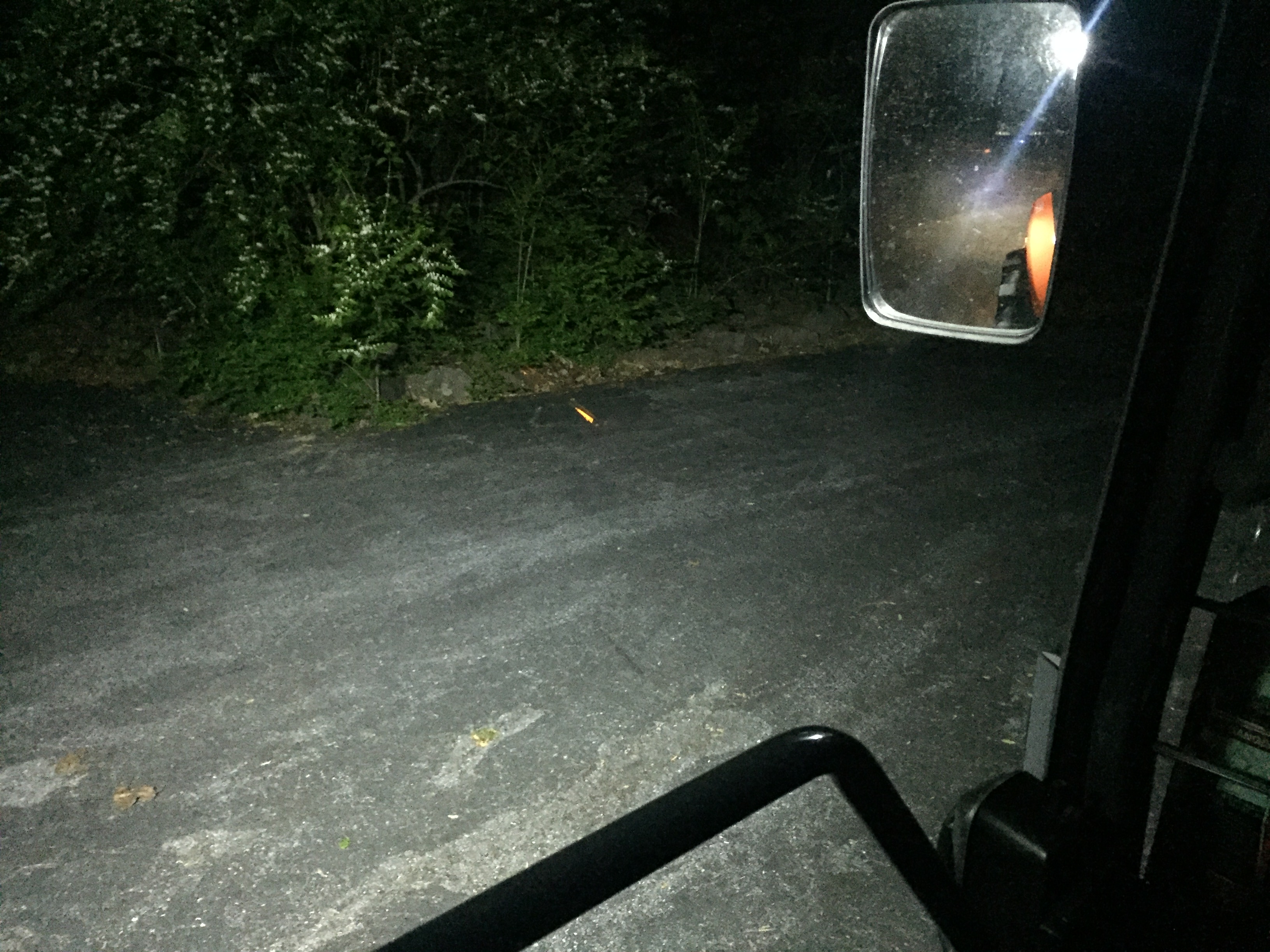

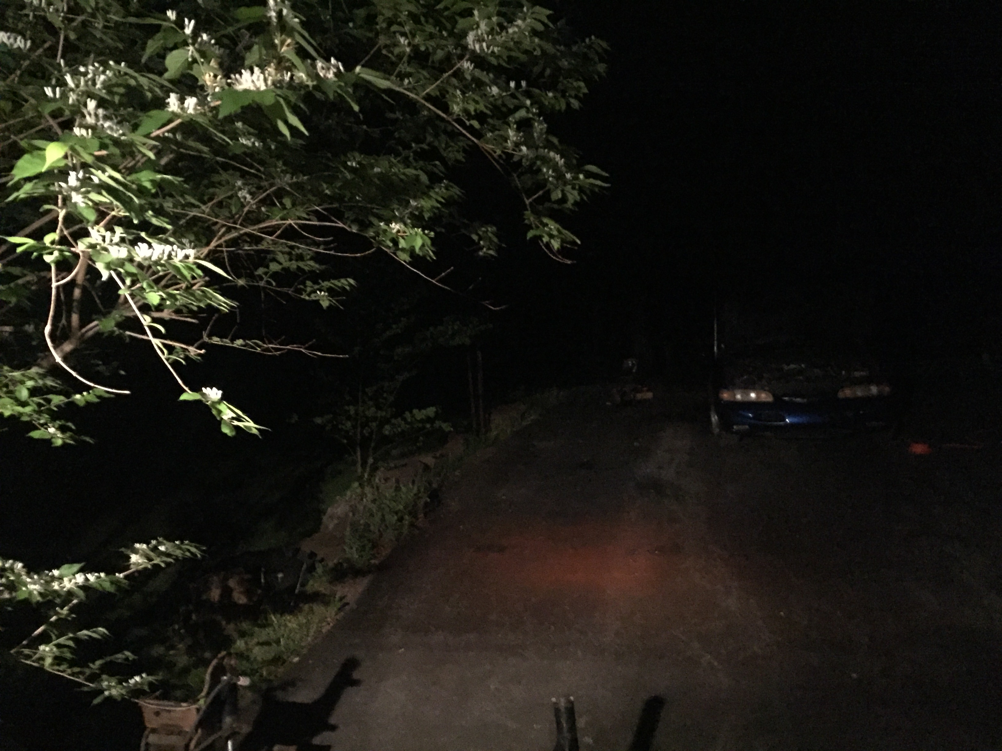

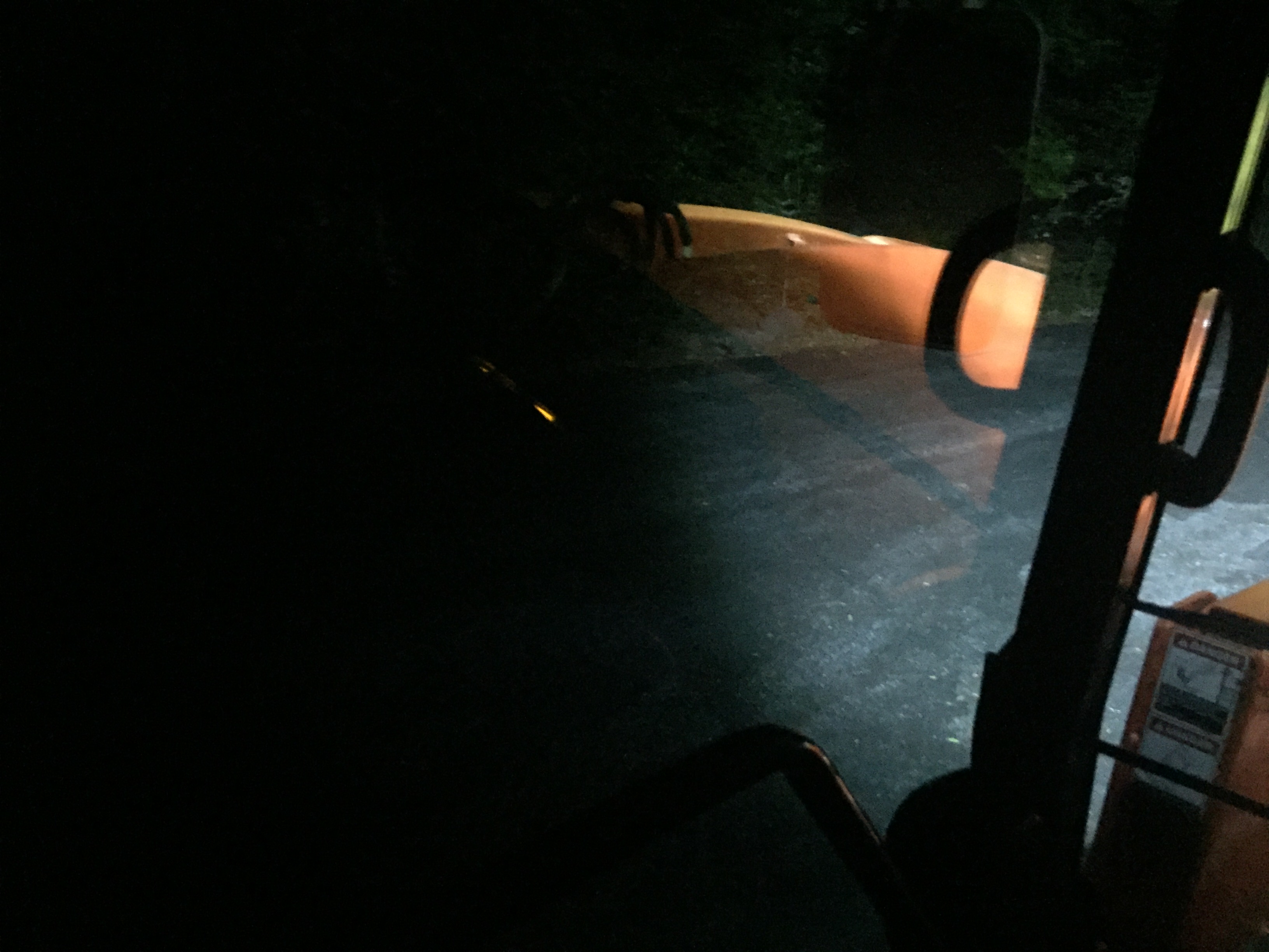

Found some pictures to demonstrate the difference... Not the greatest, but might help.
First is looking out the side with just the front LED's on. You'll notice how dark it is.
Second picture is with the side LED on.

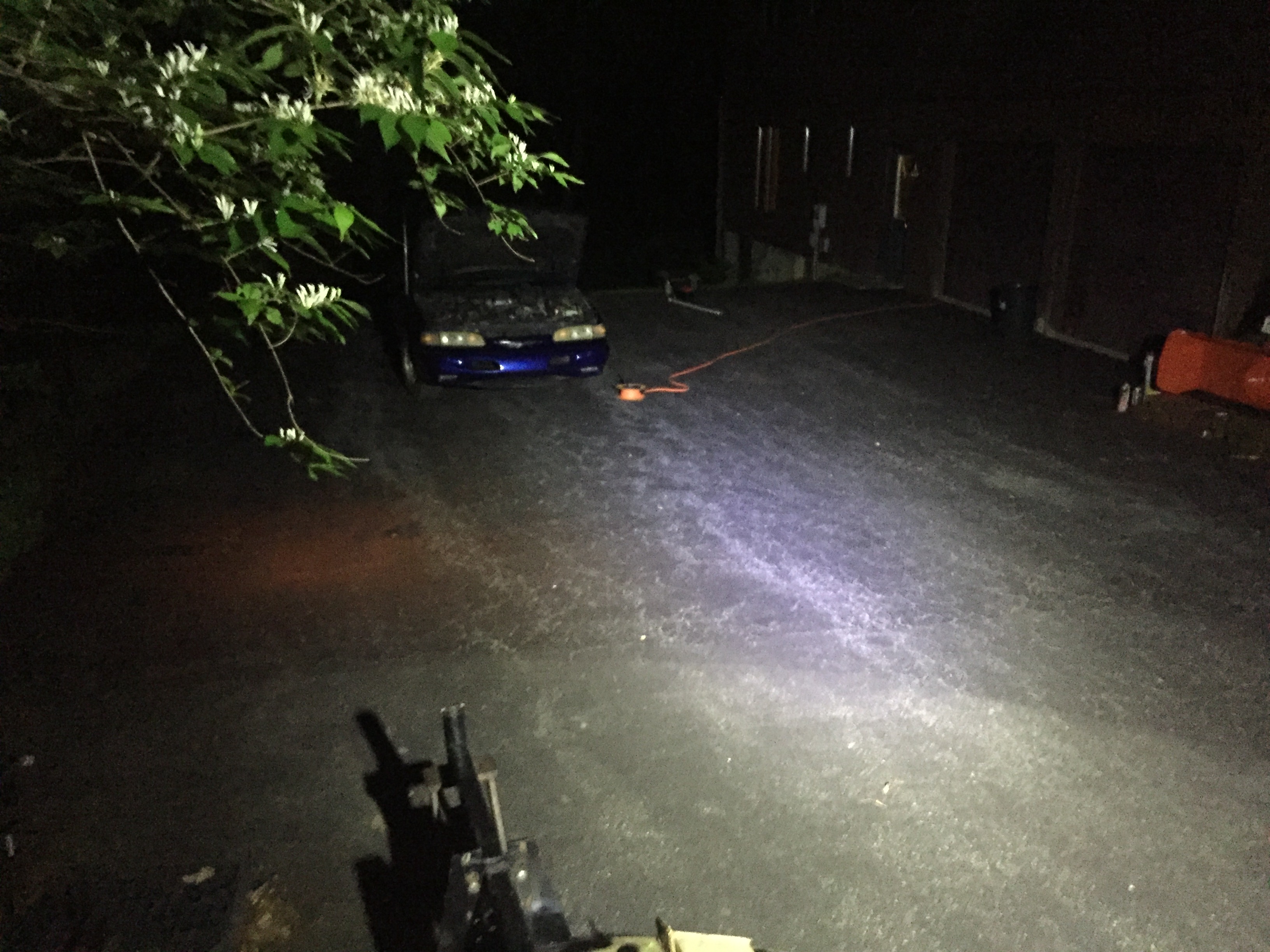

Third picture is the left rear halogen (stock Kubota) on (no light on right).
Fourth is with the right rear LED on.

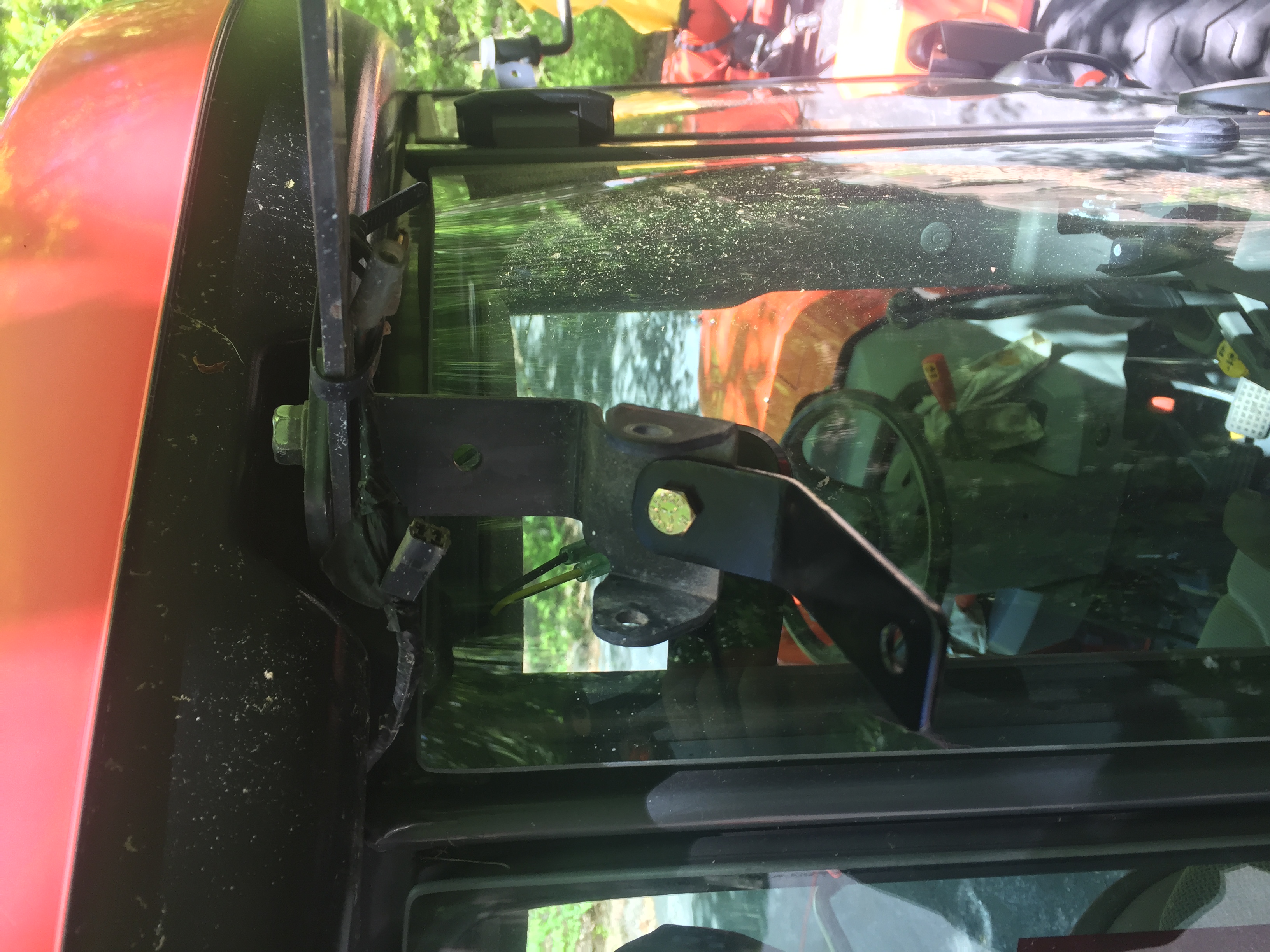

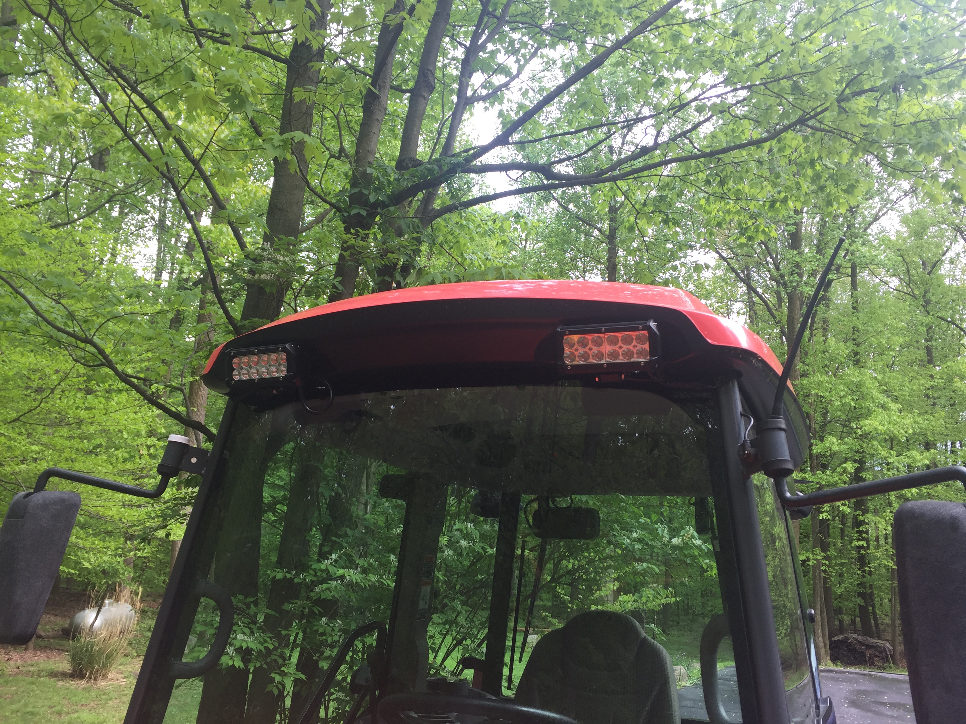

Last picture is of the simple bracket fabricated to attach to the stock mounting bracket from Kubota.

Thanks for the info. What is the width of the mounting bracket on these lights? Same as the Kubota, or did you have to add some spacers? Also, do you have an FM radio in your 4740? I tried one pair of cheap LED lights, they completely wrecked the FM reception. I added a big ferrite and a capacitor to the power lead, it helped quite a bit but still added just a enough interference that I couldn't live with it, so I swapped back to the factory lights. But I need to solve the lighting issue before winter rolls around, those factory lights aren't going to cut it.
EDIT: I just saw your photo, so I see how you handled the bracket situation. Are those LED lights 30 mm width on inside of bracket? (Kubota brackets are 38mm if I remember correctly.)

1. Bracket Width: Not certain of the exact width, but thought they would fit inside the Kubota bracket. Problem was the spacing of the light against the cab. Used 1/8" thick by 1" wide flat stock that was laying around to bend a bracket to obtain the desired spacing as shown in the last photo.
