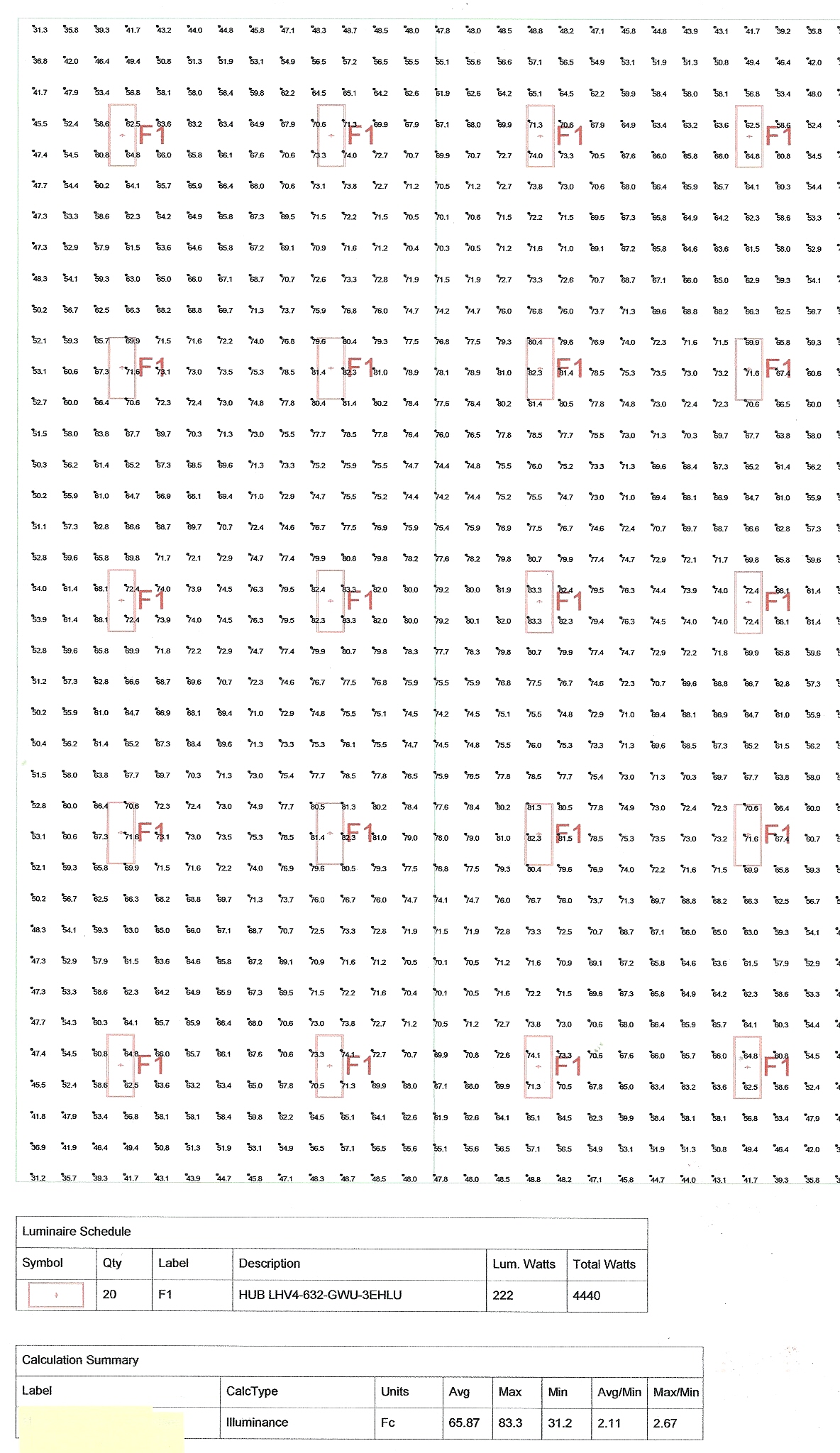

My lighting engineer recommended 65 lumens on the floor for my 64 yr, old eyes doing bench/confined work space work. Here is his layout for a 54X75 tin shed. I have 20 four ft. fixtures with 6 T8 bulbs hung from a 15 ft. ceiling.

So each of you fixtures is 6 tubes? My lighting guy says 70 lumens per sq ft.
   / I need new lights for my garage. What do you have, and what should I get? #26
65 is an average over the entire floor. Also, my 15' ceiling is also an average. the ceiling is sort of the cathedral type. Over 16' at the center and 14' at the walls, so I call it an average of 15'.
