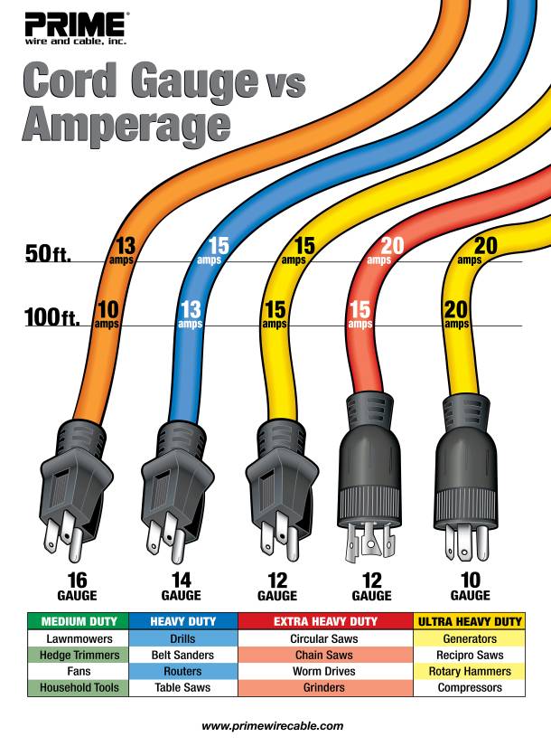

Ok that's not quite accurate, but close enough. I am bringing home an electric soil sterilizer and will be plugging it into a 4 prong dryer outlet. It draws 12 1/2 amps at 240 volts and the electrical rating is 3000 watts. I will be converting from 3 to 4 prong, but that's a pretty straightforward fix... as long as I follow the directions. (Hook 3 wires up the way the old ones were... ground the green to the appliance.) I do need the cord to be longer than a standard dryer cord though so am not sure what size wire to use; 20 feet will allow me to set it up in a trailer or the back of my pickup, and do multiple batches of soil.
My question is, can anyone tell me what wire to use; or send me to a chart which will give me the info I need?

12 amps is "chump Change", 14 ga wire will do. but because you are "outdoors", I would use 12 ga SJO cord.
Now you didn't say if you needed any 110 Volt service at the end of this "stretch". Dryers usually do, heaters usually don't. A four wire conductor is "Two hots, a neutral to return any 110V, and a ground"
So a red, a black, a white and a green. If your heater has no place for a white or neutral, either purchase two counductor SJO cord and tape the white conductor with red at both ends, and make no connection to the neutral. OR Use three conductor wire, (plus ground) but don't make a connection at the plug.
On line sources will detail any plug and cord caps you might want to use. At 12 amps, you have a wide selection.
Take a look! It's not hard. then high step down to your local hardware store and pick up the materials and devices.

Hot to hot, hot to hot, ground to ground, leave the neutral disconnected in the wall end of the extension cord.
Then you can use a 3-wire extension cord rather than a 4-wire extension cord.
As for wire size, I believe you would want 12 gauge wire for up to 50 feet per this chart from: Cord Gauge vs Amperage - Prime Wire and Cable

Remember, #12 wire will burn before it trips the dryer 30A breaker. #12 will burn before the 30A dryer breaker trips on a overload, instead of an instant grounding. I would use #10 wire, 3 wire cord.

First two replies are good. I just want to be clear, since your first post wasn’t, that the neutral is abandoned in a 2 wire 240v USA circuit. A 3 wire 240v USA circuit would have the neutral.
Your comment about taking the extra wire and grounding it to the machine isn’t technically the correct thing to do.

I’m pretty sure it’s against code to use a wire too small for the breaker. If this is a one time deal used in an application where a fire is unlikely I’d probably cut cost and use a smaller wire. If it’s in everyday service use the bigger wire or wire a new circuit.

I don’t know where that ridiculous chart came from but usually you’re using dollar tree tools it’s wrong. It’s pretty stupid to make a generalized chart like that anyway. Making a chart based of wire gauge, length, and amp draw would be way better.

How much current can a 14 gauge wire carry for .03 seconds without "burning"
The rational of the above comment precludes plugging appliances into wall outlets.

Googling how long can 14 gauge carry 40 amps didn’t bring up anything. I’m guessing the load in .3 seconds on a dead short is a lot more than 30 amps.

Receptacle circuits and 15A outlets are predicated on that normal plug in devices are rated closer to 15A rather than 20A and there may be more than 1 device plugged in. Devices that require more than 15A have a 20A plug and you need to have a 20A receptacle to receive them. I always use 20A receptacles in my shop or areas where I may need a 20A plug in.
