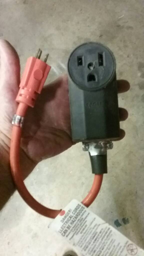

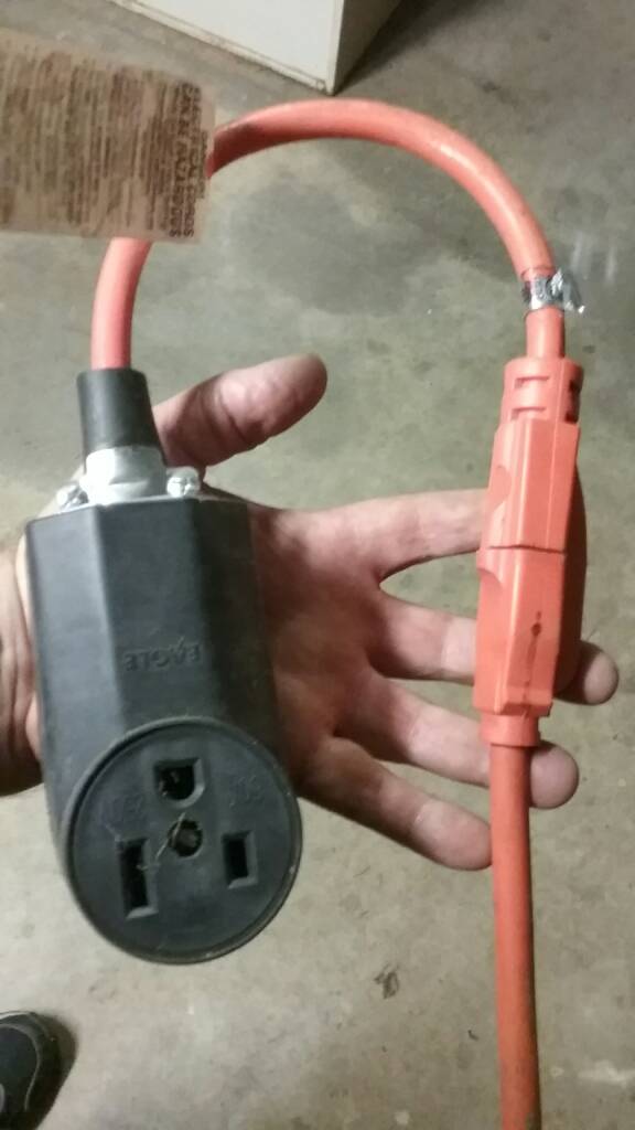

I didn't read all replies but this is what I made years ago for a Lincoln stick welder.
I rarely use it, but it's 10 gauge 25ft. 120v.
I cut the one plug about a foot from end, wired to a 220v female dryer outlet. The longer end wired to male 220v plug.
Now plugging the 120v ones together I have an 220v extension cord. Reversing I have a 120v one plugging dryer 220s together.
