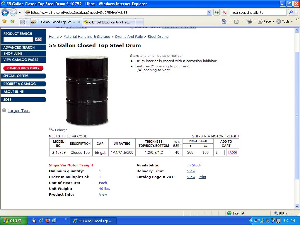

   / I need to purchase a 55 gallon drum for diesel.
Here is a new 55 gallon drum, closed top with corrosion inhibitor coated on inside. $68 new. Used steel 55's run $20-$25, with no idea of what they were used for. Deal?
This place also has a palletized spill container or drum dolly for sale. Pallet may make more sense, easy to lift off of truck bed. I guess a wooden pallet would work also.
Best handpump/filter/nozzle combination? Northern has many to choose from.
