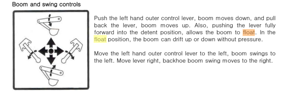

The FEL (LL1100) on my MT125 has a float position by moving the stick all the way up and it pops into that position. The manual says almost nothing about it though.
The LB1107 manual has this to say about the float position. I didn't even know it had this till I search the manual.
Why was that such an important option? Do you just use both for flattening out a soft surface?
The LS MT125 I tested didn't have FEL float, but after I made my decision I was at a LS dealer for something else, and looked at what must have been a more recent unit as it did have FEL float. Still, other things outweighed choosing the LS. I suspect either some units got a non-float valve or they changed the build spec.
Yes, float works well to spread material w/ the FEL, and to re-fill a trench or hole w/ boom float on the BH.

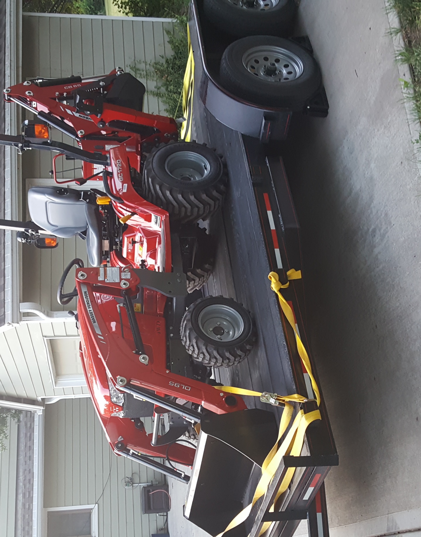

Let's see some pictures.
   / I purchased a Massey Ferguson GC1720 - here's why
#18
here's a quick one after I got home:
   / I purchased a Massey Ferguson GC1720 - here's why #19
Congrats, I love my little tractor as will you yours..
