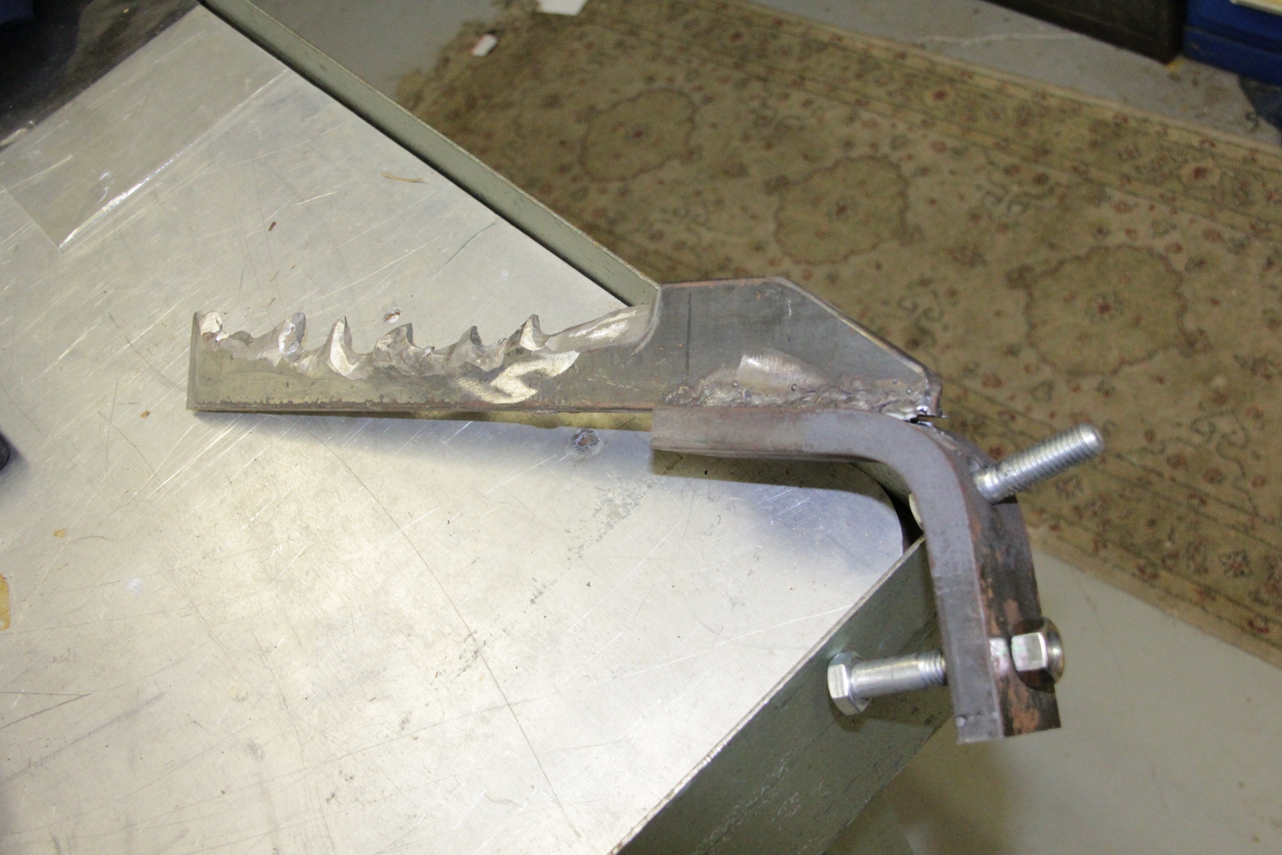

The curl power of that backhoe bucket is very powerful. I made a ripper tooth that I welded to a 5/8inch thick 2" x 8" piece of steel which I bolted to the center of the bucket. The weld didn't totally fail, but the 5/8inch mount, bent 90 degrees when I curled it against a stubborn root. Before I bent the ripper tooth, the front end of the tractor with the FEL came off the ground.:eek:
