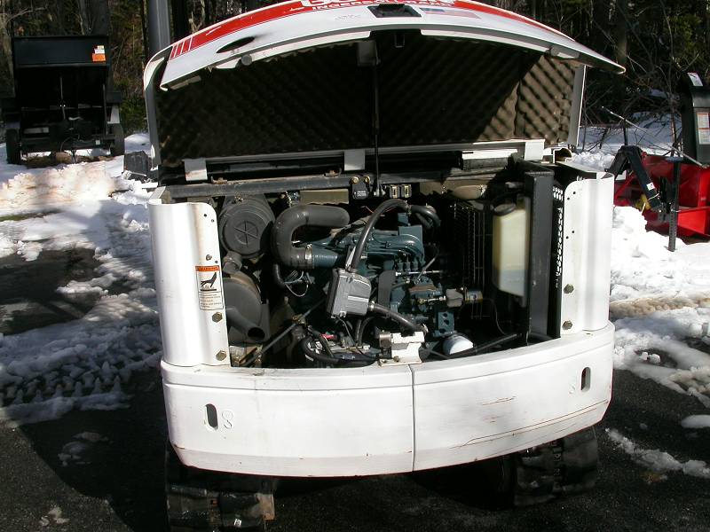

A clean engine (a 40 HP kubota diesel).

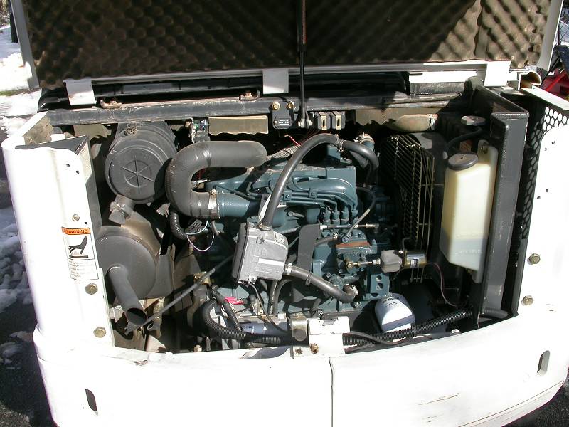

Really clean - even the foam on the hood is in good condition.
