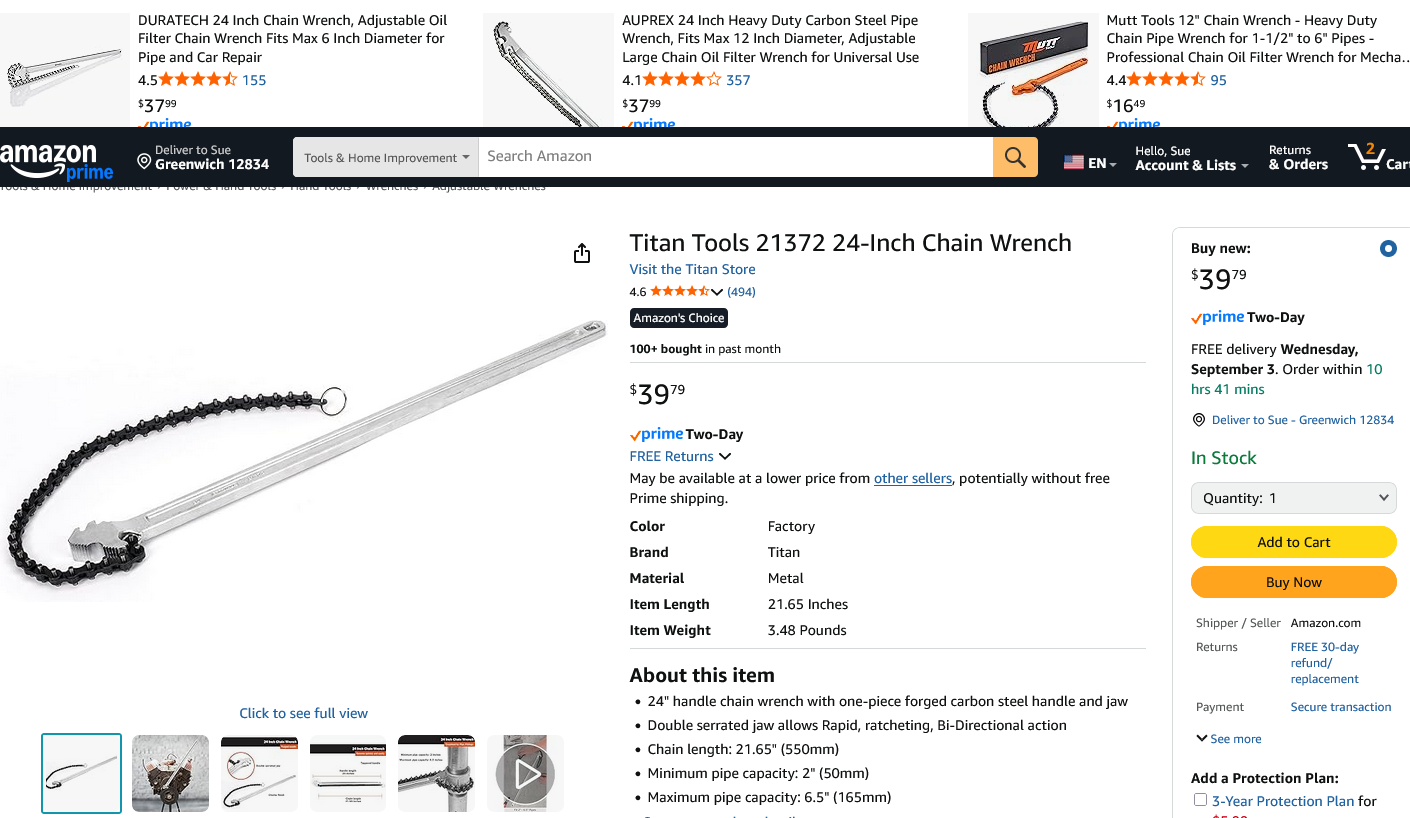

Often there is not enough room for a big set of channel locks, I have a chain wrench which always works well for me, once it's on it requires minimal room for rotation and has good grip.
