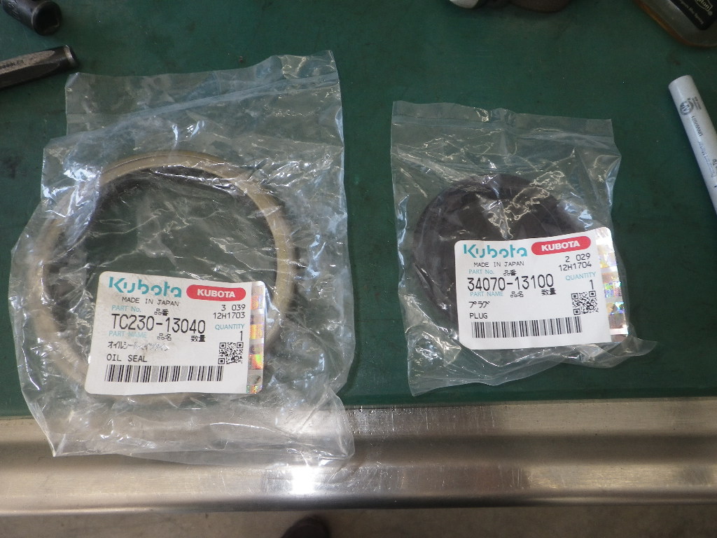

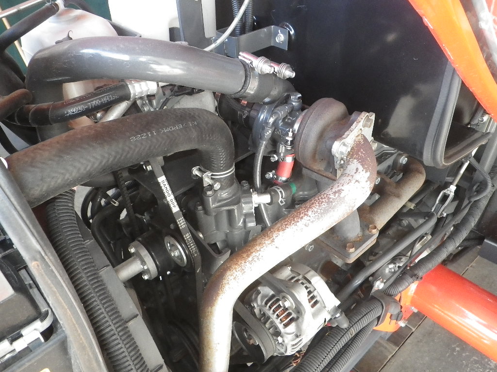

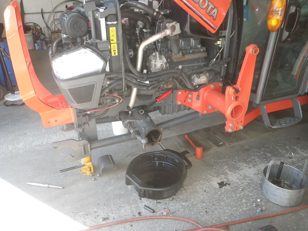

389 hours, turbo still doing it's job nicely.
Popped a front knuckle seal. Everything is oringed these days so all you need are 2 seals and a cotter pin for the steering tie rod nut.
Lots of metal in each lower front end final drive, there is only one way to get it out and that's to remove the lower seal/plug and drain it out, maybe flush it and refill. Then replace the lower seal plug.
Pix below and NO MORE GD PHOTOBUCKET for me, everything got deleted because I refuse to pay Googles blackmail fee!!!
Regards, Fred
And I do STILL HATE MY TRACTOR! 7 payments left and she goes bye bye.
