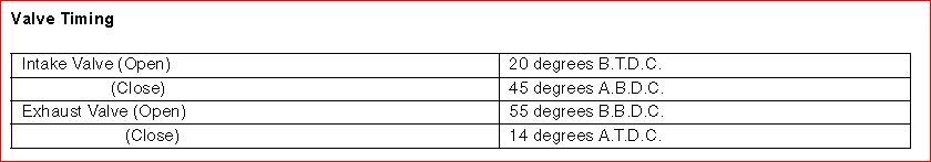

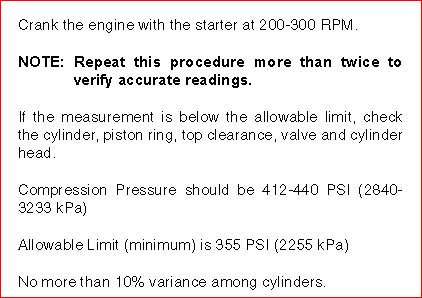

   / I Still Hate My Tractor #196
Fred, This might help some.
Compression test in Bobcat specs. fall in line with your findings:
Here is valve timing the V2003T;
Here is valve timing on the V2203;
Injection timing on both is 18 BTDC.
Turbo will definitely add more power but might as well check everything while you are at it.
Thanks for posting this information , it is helpful looks like they added a small amount of duration on the turbo cam...
I was thinking a new camshaft might be required myself.
It's typical to do that to promote scavenging of the cylinders, since the intake manifold is under pressure any time the engine is loaded. Once the intake opens, air under pressure rushes in and carries spent gases out the open exhaust valve until it closes, after that the cylinder is pressurised until the intake closes.
