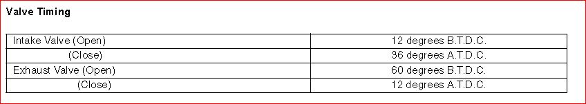

Fred, This might help some. As you are aware, Bobcat used the V2003T (56 HP) in some models but in same frame without Turbo they used the V2203 (46 HP). So I can't be positive of the specs on V2003 aspirated engine. Comparing specs of V2003T vs V2203 almost everything matches (injection timing, compression, valve lash, etc.) except valve timing.
Compression test in Bobcat specs. fall in line with your findings:
Here is valve timing the V2003T;
Here is valve timing on the V2203;
Injection timing on both is 18 BTDC.
A problem I have run across occasionally on Kubota engines with power complaints was governor spring setting. Spring were set so engine RPM had to drop well below the normal 150 - 200 RPM decrease before governor would release the fuel rack. Caused the engine to lug down too far that it could begin to recover, just a thought to check.
Turbo will definitely add more power but might as well check everything while you are at it.

I'll admit I like everything I own to work perfectly and strive to make it like that. I should have tried before buying but didn't. I jumped on this because there were no more larger 40 series tractors around, they are gone. Took 2 hours this morning and set up a degree wheel to the front pulley becuae the loader frame covers the timing port in the clutch housing. Sidenote: I would bet real money that no dealers check the timing and tear thse things apart. What a PITA.
Anyway here's my notes from this morning:
12-7-2013
Compression (cranking) 400 psi. all 4 cylinders (factory spec 520-580). WSM discrepancy?
Wrong manual for the tractor? WTFKnows
Checked Snap-On gauge against Nitrogen tank regulator gauge and both match closely.
Fuel Timing check #1 cylinder 17 degrees BTDC.
Leakdown test : #1 cyl. - 2%, #3 cyl.-3%, #4 cyl.-6%, #2 cyl.- 3%. NO leakage through valves.
Valve adjustment varied from .003"(#1 cylinder) to .007" (most others).
Adjusted all valves to .008".
Checked installed camshaft position, with overlap split degree wheel right on TDC #1 cylinder.
All valves checked at .050" lift.
Intake valve opens @13 degrees ATDC. Closes @170 degrees BTDC.
Exhaust valve opens @147 ATDC, Closes at 19 BTDC.
Intake and exhaust valve lift is .305".
View attachment 349026View attachment 349030View attachment 349031
Any other things I could check? Fresh out of ideas. Other than the timing being of MAYBE 2 degrees retarded and the tight valve adjustment I see nothing wrong with this. Tractor has 50 odd hours running time. Air filter minder hasn't moved. It just acts like more air is needed.
Thanks, Fred
Fred It still looks to me as if that cam MAY be installed in a retarded position.
When I read your post saying intake opens @ 13* ATDC- I read that as 13* AFTER Top Dead Center to make things worse Some Asian and European manufacturers use nomenclature that defines ATDC as in ADVANCE of Top Dead Center-
Either way all the specs I have seen where the words are written out have The Intake valve opening BEFORE or in ADVANCE of the piston reaching top dead center,
Which from what you posted leaves my wondering IF the intake is IN Fact opening IN ADVANCE of Top Dead Center - THEN the Camshaft is Installed in the correct position
BUT If it is opening AFTER or BEHIND Top Dead Center then there is a problem and the cams centerline is in fact installed in a very Retarded position- and would result in low cranking compression and a very poor running engine, unless it is running near wide open- because retarding cam installed position (results in shifting the power band higher in the REV range)
With the way you have described how this new Kubota runs I am actually hoping this engine was built with the cam being installed in the wrong position Because it would at least solve some of the problems you have reported .
