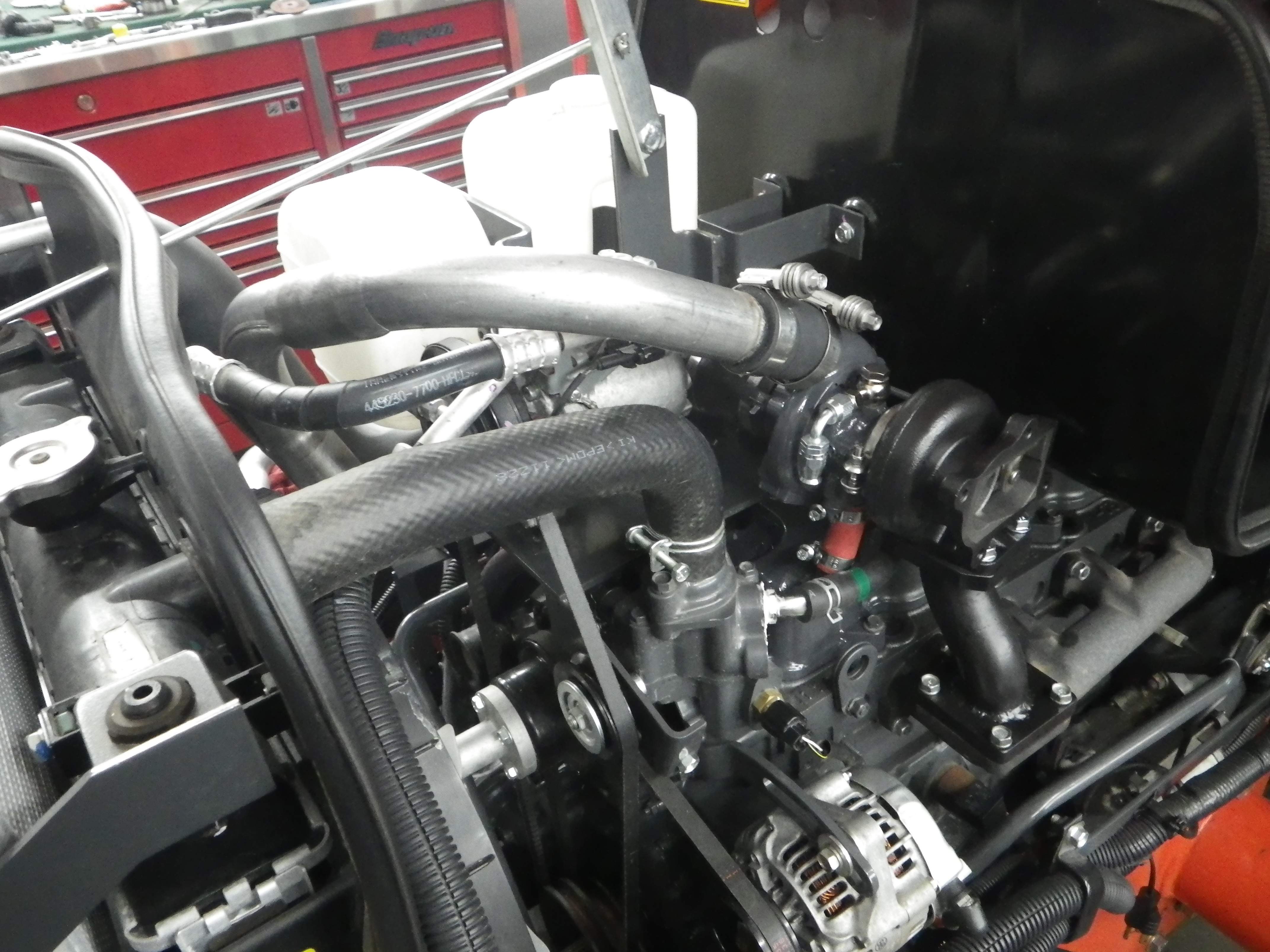

Let's talk cranking compression vs. leakdown test which I did both. Since the leakdown test showed almost no leakage from the cylinders through the valves/rings then cranking compression can only be low due to lower compression pistons or larger chambers in the cyl head.
I am happy for this as the turbo will only help. I would much rather turbocharge a lower compression engine than a higher compression engine.
NO fighting you guys, NO FIGHTING. If Aaron decides to pull posts again you can bet you'll never see the outcome. I have done lots of hot-rodding over the years, some results are good some just lackluster. I have a really good feeling about this one. Everything is coming together, I painted the turbo and assembled for the last time. I still need to make my 4AN oil feed line and build the high pressure pipe to the intake, and a makeshift exhaust until I figure that part out.
Thanks for watching
Photobucket is down so I'll give ya a little taste from tonight.
Fred

I would be interested in seeing what the compression specs are on the turbo version of this engine... Could you have turbo pistons or heads already for some reason? Hmm..
   / I Still Hate My Tractor #428
How is the turbo drain plumbed? Any chance the restricted banjo bolt belongs on the drain side, to hold pressure IN the turbo?

Agreed, that's been my own personal experience from Saab, and other foreign autos like Mercedes, and Volvo, with the VW diesels,:yuck:, (speaking of gutless dog engines!). Lower compression when turboed VS. normally aspirated engines, gas or diesel. You definately can't go wrong on that issue.
