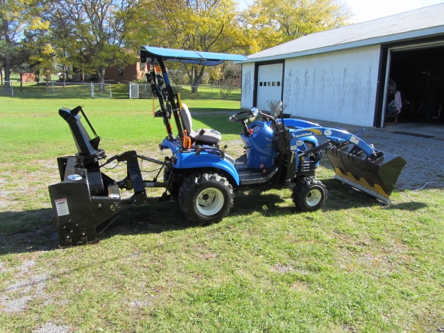

My set-up. Minimal signs of wear on the replaceable edge after 5 winters. ( even though I bought a spare )

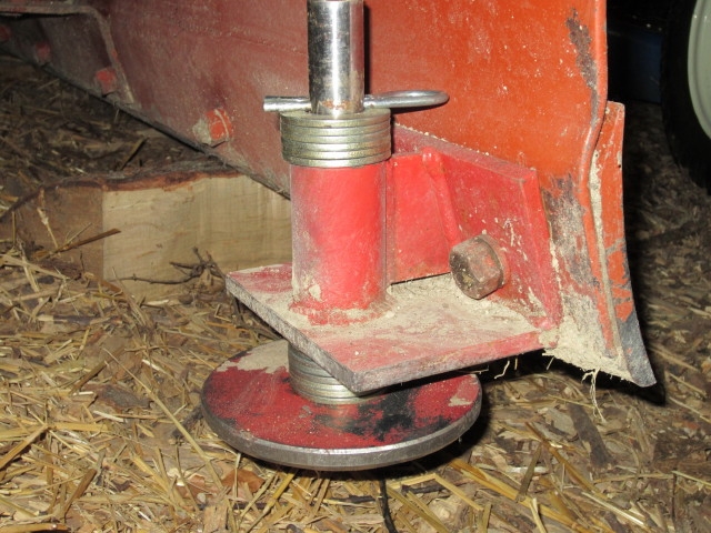

I NEVER use the blade in the "forward" position on gravel. Pushing snow with the wrong side of the blade won't dig in, as you say. (y) I did make shoes for the blade which works too.
I’ve never had shoes work on soft gravel. They just dig in and make 2 trenches.
Well, yeah.....before the ground freezes, nothing really works good. That is when I just drive on the snow to pack it down. I really hate having to clean gravel out of my yard in the Spring. Grrr
   / I Stink At Removing Snow From My Gravel Driveway #15
I have a mile long gravel driveway. It is normal that I have to plow snow before the driveway has frozen up and is hard as concrete.
Turn the rear blade 180 degrees and plow as usual. This will keep the gravel in place and do a fair job of snow removal.
I have never needed shoes nor Teflon edges. My eight foot Rhino rear blade is heavy enough to remove all the snow - even reversed.
   / I Stink At Removing Snow From My Gravel Driveway #16
The reversed and floated blade does work with soft unfrozen gravel.
