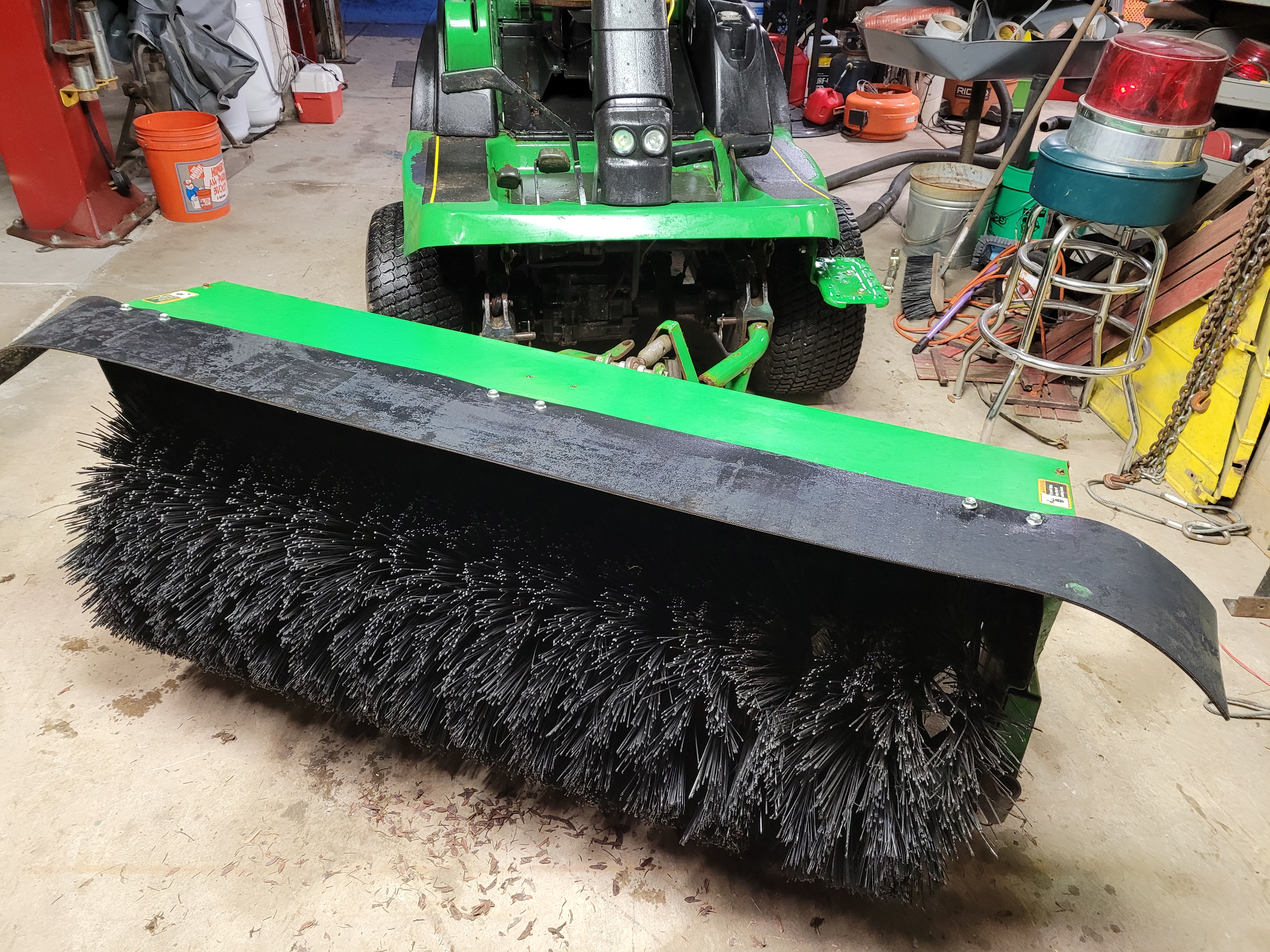

I've done an 8' York rake with a 2x12 clamped on the tines, a 47" front snow blower, an 8' Western plow, a 7' snow pusher, and a broom. Broom by far is the best, fastest and cleanest. Set the tines maybe 1" above the gravel. Never picked up a single stone. Can go as fast as the machine runs. JD1435 goes faster than I can stand the ride. Drive on it a few times afterwards with the broom up to pack it down and I'm done. If more that 12" of snow expected (Maybe onece per season), get on it early.
Rake is ok but rear mounted you have to watch out where the edge is when going forward, (and still picks up gravel). Snowblower WAY too slow, snow pusher: where do you stash the snow ?) Plow is next best but leaves a berm and PITA to mount up (while it's snowing of course). Plus the broom has other uses on my concrete pads, does sidewalks clean, and can even do grass and dirt corrals. Snow (and any other unwanted substance) nicely distributed far away from the source. Sht happens, sht burns, and sht flies now too !!!
