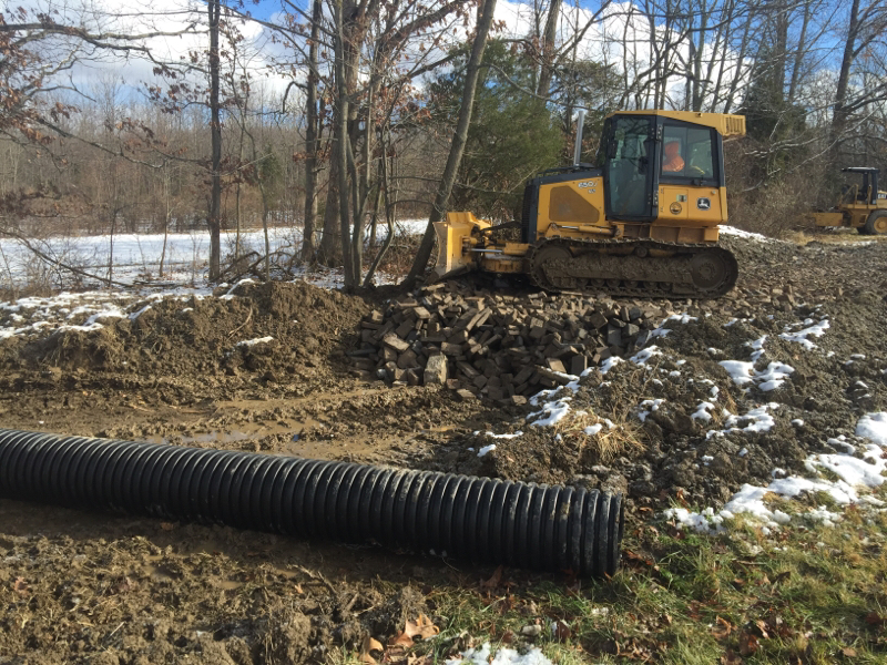

Perhaps a bit overkill, but you may want to put a real base down first, then work in the modified. This pic is in the middle of a field, 300' down and right at the start of our wood line, the ground was so soft our contractor had to keep dumping and packing concrete until it stopped. I have no idea how deep that part of the base is, but it's probably deeper than what's shown here.
These concrete tabs are fairly cheap. You spend way more on the truck and driver than the material.

What exactly is that fill and what did you cover the fill with?
   / I think I have screwed up on my Gravel Drive #26
The base consists of concrete tabs which are the leftover material from concrete castings. When the tabs are knocked off, they go into a bin for disposal. Our contractor buys them, then sells them for $65/load for road base. The topping is 3/4" modified and smaller, if I remember correctly.
Our driveway is 2000' long. If we had to use regular 4" stone, it would have cost us a whole lot more to get it done. Conversely, had we started building a couple months earlier, the concrete might have been free, as the manufacturing place had bins that were overflowing and couldn't get rid of the stuff.

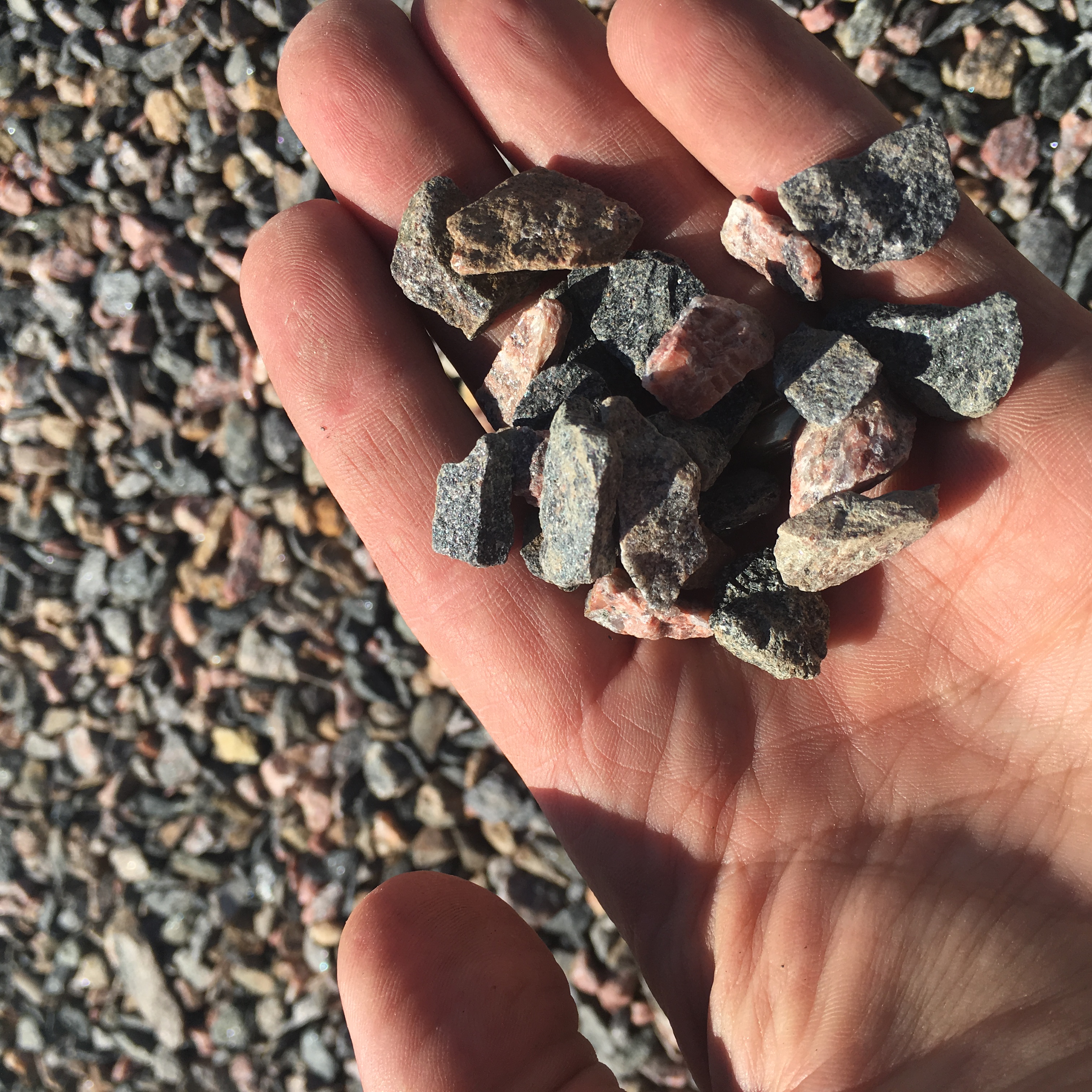

hopefully these pictures come through.

The rock in hand is pretty well equal sized with no fines. It will not compact well. Check out Google for pictures of gravel.

Looks like what we here would call #8's.
Certainly not a packable stone at all. You need fines to pack. THAT is a top dressing. And anything more than about an inch thick, is like trying to drive or walk in beach sand. Certainly not what I would call a 1/2 minus stone. 1/2...yea. But they forgot all the minus stuff

I agree, it makes a good top and makes your driveway cleaner, but just won't pack into place. If its not too thick, it would probably be OK but I bet where you are having problems its a little thicker.
