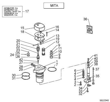

OK I have tried everything... all levers up, down and all valves out and in and still nothing. I am leaning toward it being the switch (lever) that tells the lift to go up or down or maybe the pump. I did dissasemble several areas of the 3pt and when i opened the cover behind teh piston there wasn't any fluid there. Seemed wrong to me.

Got a schematic to that input valve.. or the entire 3pt system.. should be easy to troubleshoot looking at the plumbing..

OK I took the lift off last night and there was one loose linkage so I tightened it up and put it all back together and no luck. Maybe the internal valve itself went bad. Looks like I'll have to disassemble it again.
Here are some pictures of the schematics:

I'm still not convinced draft control isn't your problem. In your website photos, you've got some nice clear pictures of the spring and plunger. The spring is the big folded looking piece of metal behind the operator seat. The plunger is the shiny rod connected to it, when then passes through to the inside of the sump.
Draft control is employed to prevent a ground engaging implement from digging too deep. The deeper it digs, the more the toplink pulls on the back of the tractor. In this case, it's pulling on that spring. The spring in turn moves that plunger, which is connected to the lift valve. When the implement pulls on the spring, the spring moves the plunger, the valve lifts the implement. How HIGH the implement gets lifted is determined by where you have the draft control lever set - that's the outside of the two levers just to the right of the operator seat.
Now. If that plunger linkage is rusted/dirty/stuck, it will be in whatever position the lever was in when the thing locked up. If the lever was down - as I saw in your photograph - you're stuck in full draft. Which means the inside lever has been taken outa the equation.
I recommend you disconnect the plunger from the spring, and see if there's any play in the linkage. If it doesn't move at all, that could be your problem. Unfortunately, I don't know the travel on the Benye linkage, so I can't tell you what "a little movement " might represent. At that point, you're on your own.
