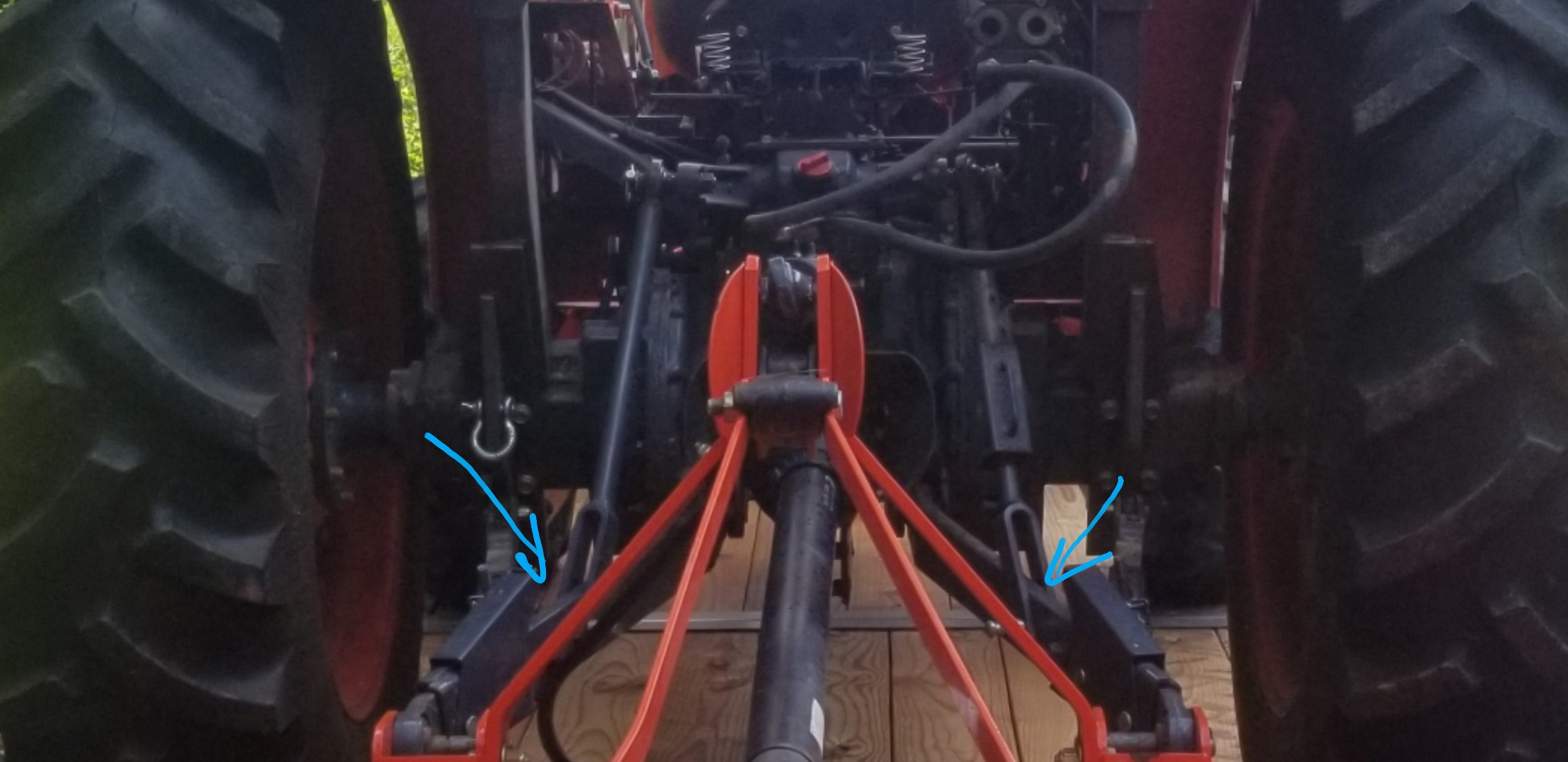

How so? :confused:

Well, a hydraulic side link has either got to have a spherical end, or a loose hole to fit into on the lift arm, otherwise it's gonna make it loose!
Most DIY side links (made several myself) use the solid (rod) OEM link by cutting off the ends and welding them to the cylinder...The process is well documented in other threads here...don't recall anyone ever having an issue...!

Because the lower links, depending on how your tractor is set up, don't have enough play to allow different heights on them. My mx5200 doesn't anyway.

These are the holes that wallow out because they don't have the ability to have different heights;
