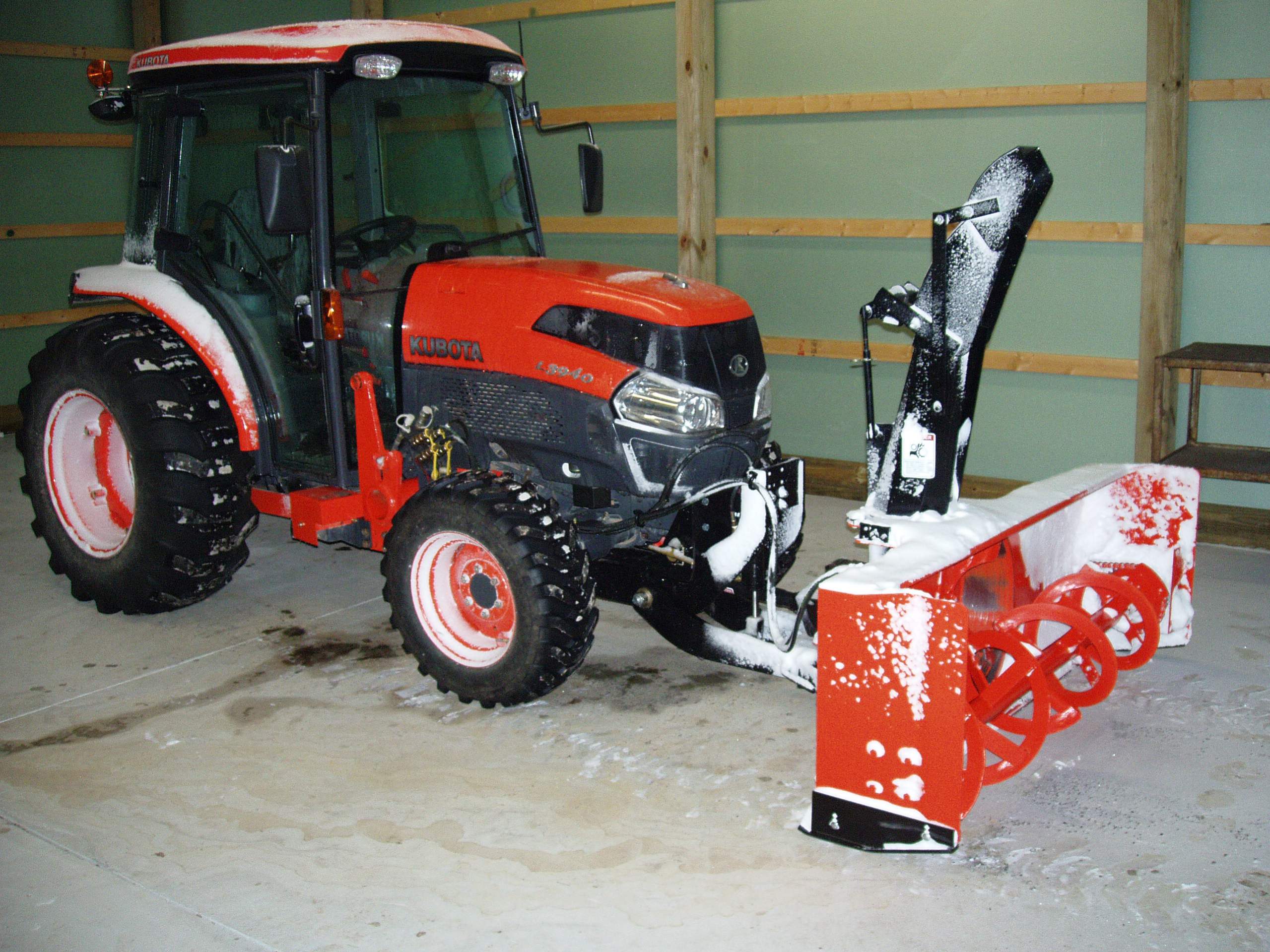

I run a 74" Quick Attach skid steer snow blower on my MX4800. I have a 22 gpm Prince PTO pump and a 30 gal reservoir mounted on my blade. It works great. I have used this since 2015. I use my FEL in the winter to move firewood to the house.

IMG_20150614_165816235_HDR.jpg IMG_20150614_155207613.jpg IMG_20151121_085646749.jpg

so, even with the higher flow of the "M" series tractor, you still needed the PTO HPU? Interesting.
Really nice setup!
   / I want to hear from owners of Kubota front mount blowers #46
Really nice setup!
A M4072 only has 16gpm, a M7132 only has 21gpm picking random Ms off Tractordata.com. those are probably pretty representative of the class though. 21gpm @2,500psi is only 30hp. Well under half, maybe a third of the avalible engine HP. Hydraulics are also less efficient (wastes a lot more energy to heat, friction, leakdown, etc) than direct mechanical drive.
A skidsteer is made to be all hydraulic for control & because there isnt really a way to run PTO up to the boom effectively. Tractors are designed for efficency putting power to the ground or the PTO. More efficient machines for what they were designed for, but they have different tradeoffs.
   / I want to hear from owners of Kubota front mount blowers #47
Hydraulic pumps are exensive. Why put a high capacity pump on a tractor that generally just runs some cylinders? But high capacity pump options would be nice. It would still have to be cheaper than the mechanical equipment for a front mount blower or the aux hydraulic equipment on the back.
   / I want to hear from owners of Kubota front mount blowers #48
My MX4800 only shows a auxiliary gpm of 9.8 gal per Kubota. The blower is a 15-25 gpm if memory serves. I think I paid $450 for the PTO pump. Maybe $250 for the aux tank. All in all, no more than an additional Rear Remote, even if the tractor had the GPM to run the blower.

You definitely need a relief valve in there. Hoses aren't cheap either. You really should have a filter in there as well.
Control valves can probably skipped for this use case as you dont need reverse & can just start or stop things with your PTO. May be needed if you want to use it to power anything else.
A cooling radiator & fans are generally needed for that type of power pack. But extra cooling beyond the tank itself can likely be omitted if you are only using it in the winter.
   / I want to hear from owners of Kubota front mount blowers #51
Hoses are needed if you are using a rear remote or a power unit. I didn't included because they are needed if you are using a rear remote or a power unit. There is relief valve on the blower.
I am source hydraulics for a living and my hydraulic engineers saw no issue with my set up. 22 gpm and 30 gal of fluid.. the volume of fluid (ambient temp) keep the fluid in a safe operating temps. FAR below 200, which is where commercial equipment often runs... I use this for a log splitter too... no issues.
A filter would not be a bad idea.
Control valves... for this application... that is only trying to spend money. This WORKs... KISS (Keep it simple stupid) This is also a VERY economic alternative to a mechanical front mount. What are those, all in??? $10-15k? (for a 40-60 hp tractor)… Including blower.. I am and $7k Blower is $5400 new.
   / I want to hear from owners of Kubota front mount blowers #52
I went with the hydraulic snowblower when I purchased my tractor. It was maybe $2000 more than the mechanical mid PTO blower. It works great, the rear pump is about 80lbs and mounts directly on the rear PTO. I wish it had a PTO shaft for hook up, it would be much easier. I can take the blower off the front like any SSQA attachment, plus 2 quick coupler hydraulic hoses and 1 electrical plug. I like the blower mounted to the loader arms, it eliminates all ground clearance issues and you can pick the blower up as far as the loader arms will reach and blow snow.
