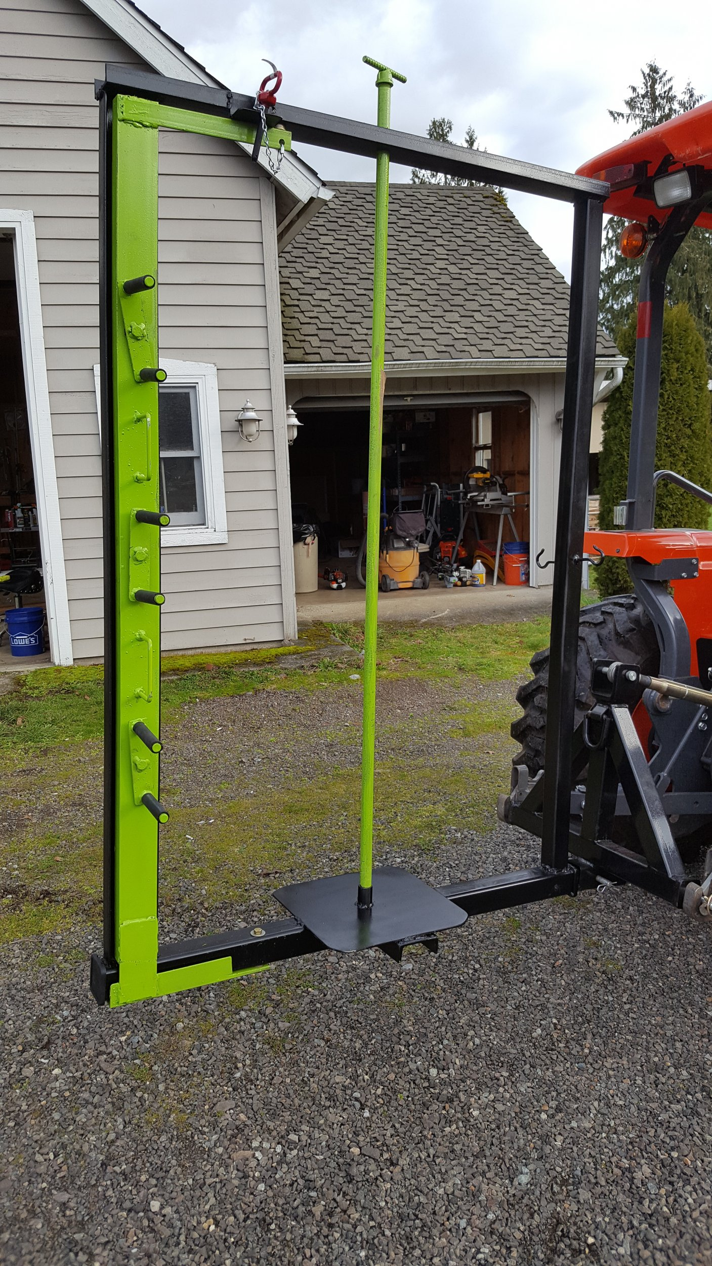

I am getting ready to install about 2000 ft of fencing...I fabricated this to assist in unrolling and stretching the fencing material.

for that much fencing the effort and cost to build that makes perfect sense.
And odds are you will use it more than a few times going forward.
Nice Build BTW
Keep a good eye on that weld at the bottom. I don't see a tab connecting that upright to the top link. If that weld on the bottom is the only thing holding it to the triangle you might end up needing more. even a bit of chain or steel cable would likely do.
Thanks much for the catch on that...I actually used some all-threads and bars to mechanically attached to the 3pt. On the bottom weld, I used trailer receiver extended channel and welded a 14" trailer hitch raw bar to give more strength.
