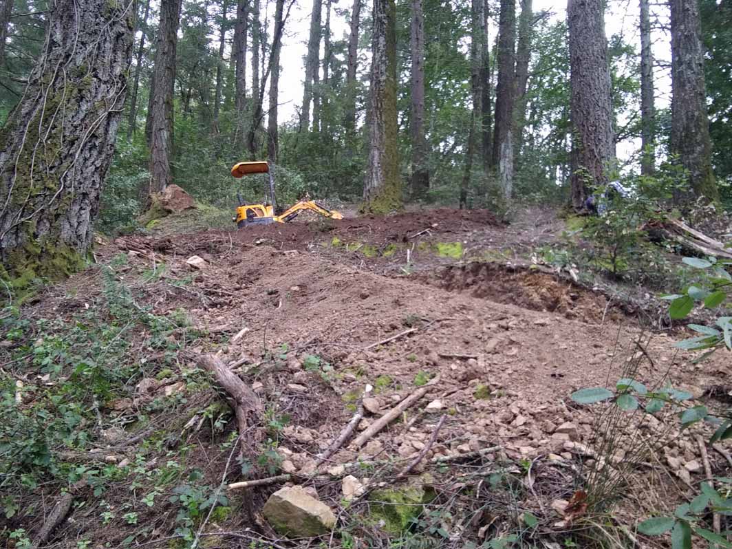

Stop hiking or stop building trails?
In this photo, it looks like your cut-bank is about 100% slope (45-deg). It is really hard to tell what pitch your trail slopes are.
https://www.tractorbynet.com/forums...400-i-told-bad-idea-hold-20190503_122436-jpeg
I have added a bunch to my trails this spring, too. Not with my tractor, as the R4 tires can't really get up more than about 25% grade (3/12 pitch), and they are too narrow to drive on safely anyway. This season, I am using my new mini-X, and it seems to be able to get up about 40% max grade if the conditions are right. I am setting my max trail pitch at 33% (4/12), so I can walk it comfortably and get down safely in an ATV without sliding (new tires & 4x4). I use a 4-ft level and a 16" gauge stick to measure as I go.

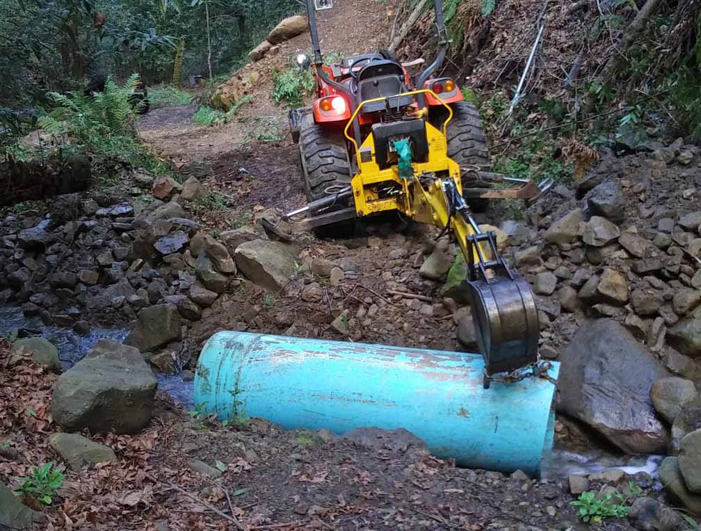

Cross cut trail, I've hit a large gully and not sure where to go. Build a bridge?
I either build a ford, a bridge, or lay culverts. I have all of these on my property.
I just converted the ford over my year-round creek with this culvert. I just scored some 24" PVC pressure pipe. I will prob have to sandbag it next fall, or it will flood.

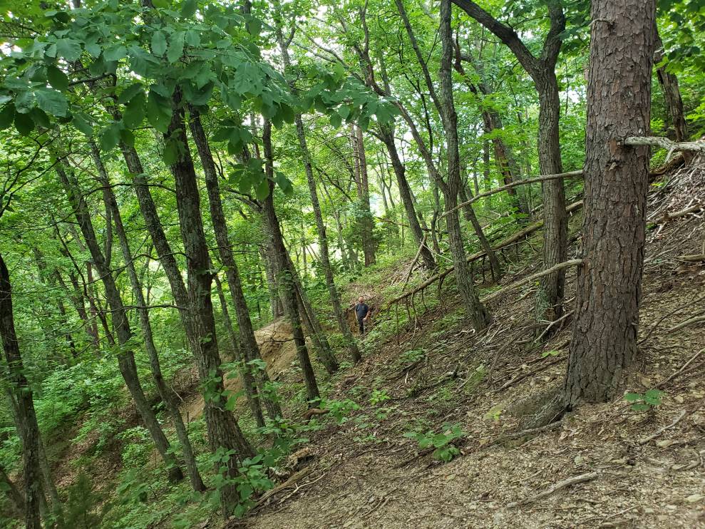

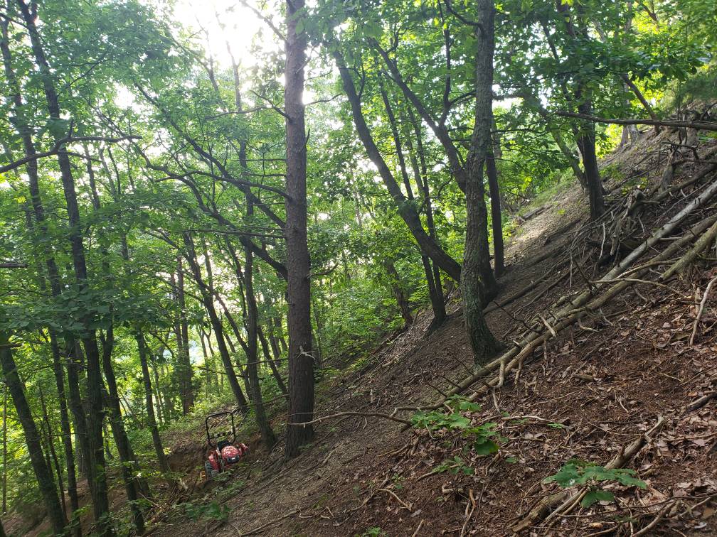

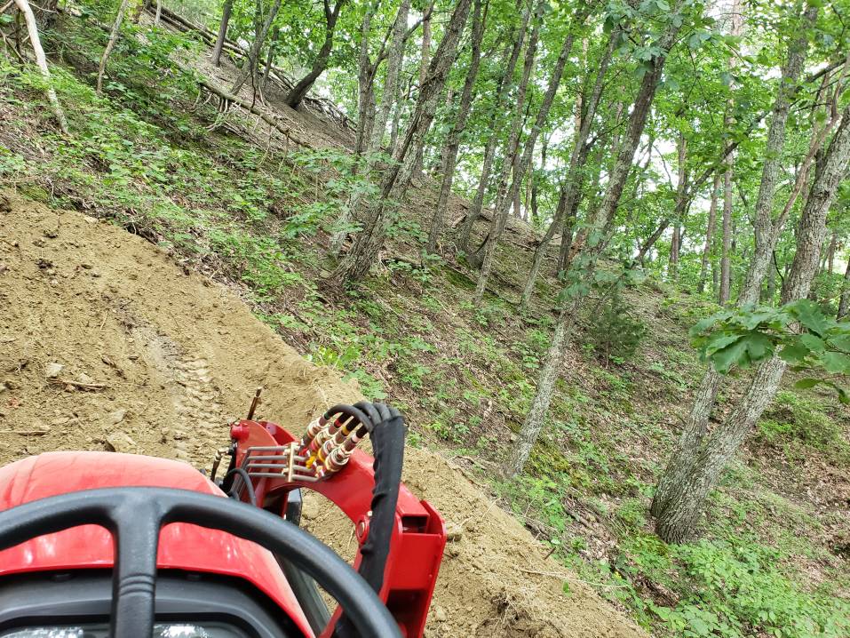

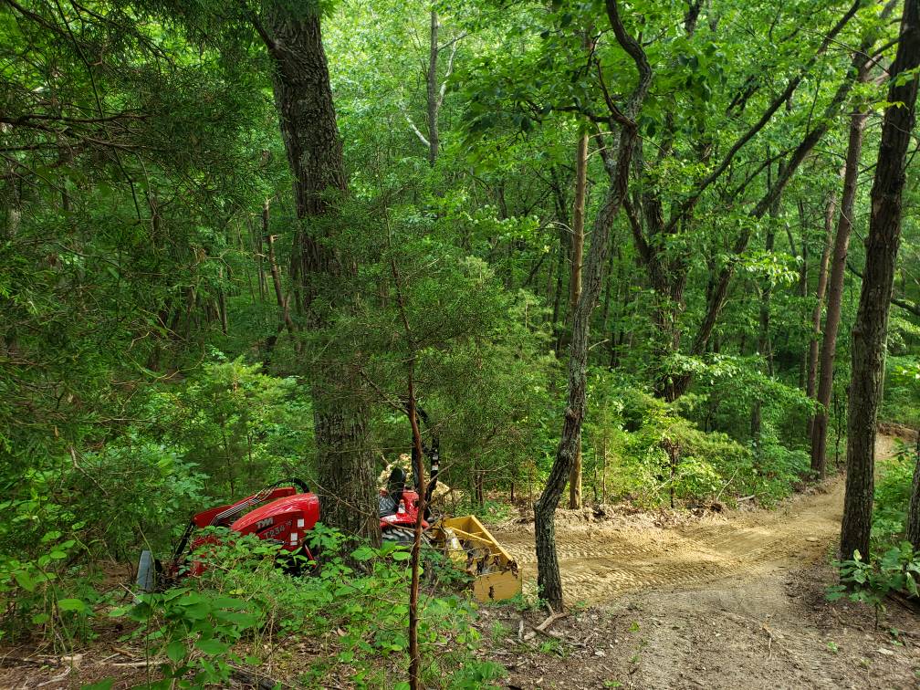

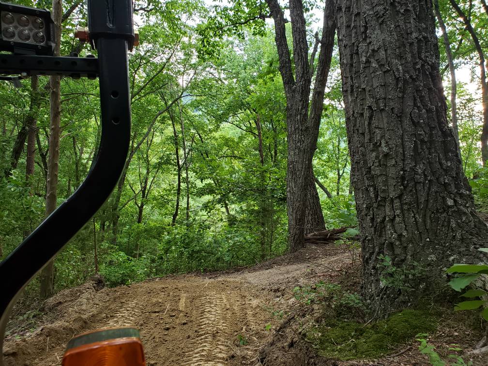

Edging my way around the south side. 20190615_175434.jpeg20190615_190706.jpeg20190617_084151.jpeg20190617_084055.jpeg

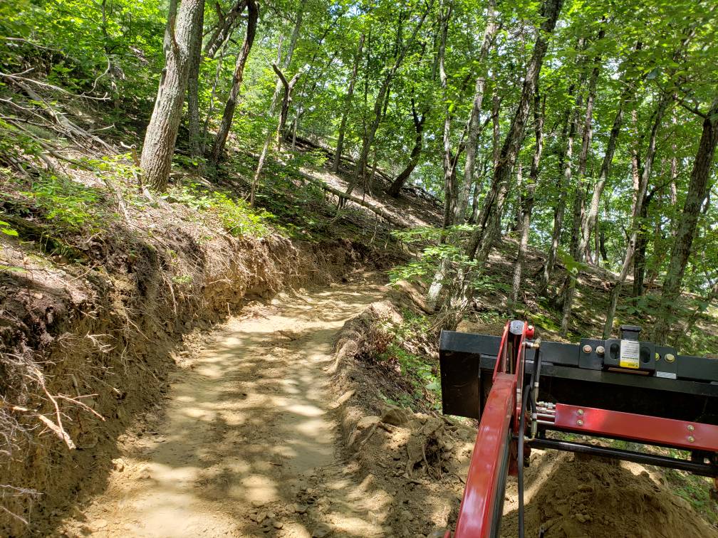

I'm a little farther than this....I just forgot to take more pics after I put 9 more hours digging on the 4th.20190704_184849.jpeg20190704_154008.jpeg

Progress! Good job !
   / I was told it is a bad idea...hold my beer! #228
Yes quite the slope. For those of you flatlands... no disrespect intended, this is challenging work!
   / I was told it is a bad idea...hold my beer! #229
Looking great! Keep being safe - don't get complacent up there.
Did you make it to the top yet? Looks like your getting to a kind of plateau area up there, at least.
