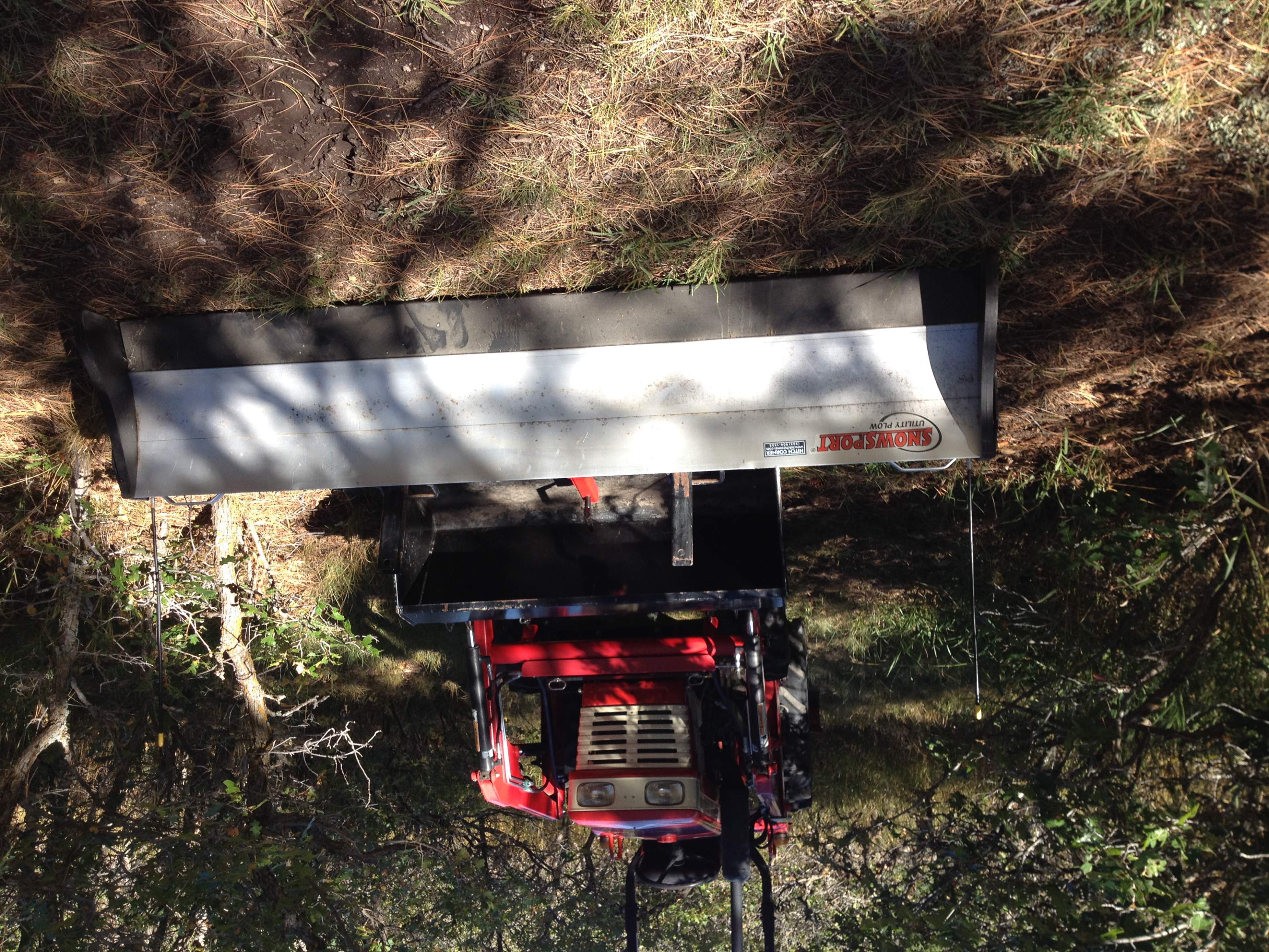

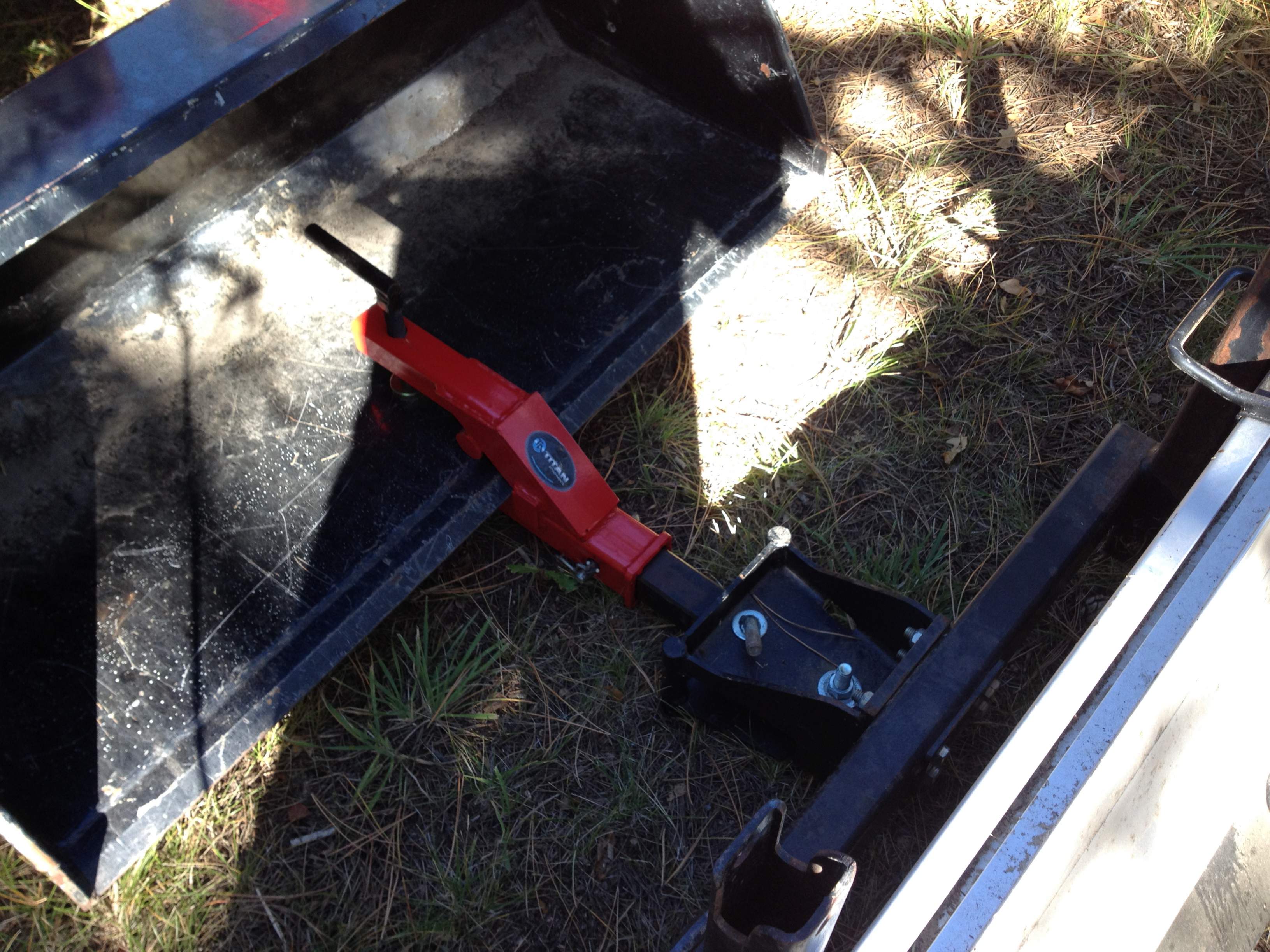

Sorry, can't master the picture attachment process. Anyway, I have a Snowsport manual plow that fits on to a 2" hitch that is attached to the front of my truck. I purchased a 2" clamp-on hitch that is now on the front loader of my Yanmar YM2210d. Hope to move a bunch of snow this year. Plan #2 is a 44" snow blower on my JD X500. Let it snow. View attachment 399746 View attachment 399745
You may have issues with the clamp on hitch turning sideways if you have more load on one side than on the other.

Yeah, that's a concern, only time will tell. I have moved a lot of sand around with this set-up as a dry run, and so far it stays put. I'm hoping the JD with snowblower will do all the work, but if we get a big one, I can use the plow to whittle it down lawyer at a time until the blower can take over. Now that I'm retired, I have a whole new outlook on snow removal. It it looks like too much, I'll go back inside and have another cup of coffee and put another log in the stove. Have a great Thanksgiving.

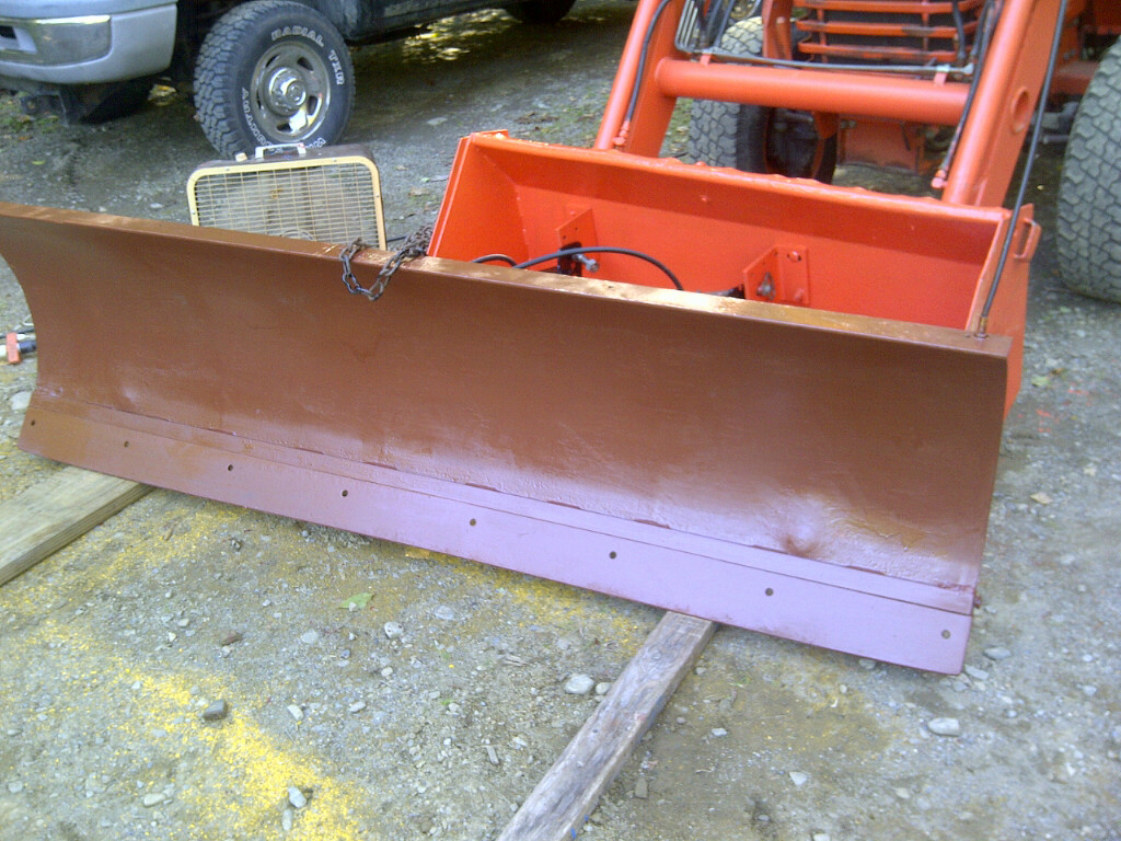

That looks good, wish I could have painted mine before I took the pics.
I have a very small garage that I can paint in but did this outside and then inside with heat on to dry it.
PS the plow is now safety yellow ready for snow. got all my ideas right on this site.
