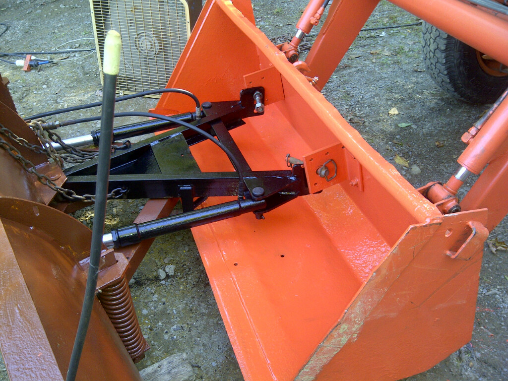

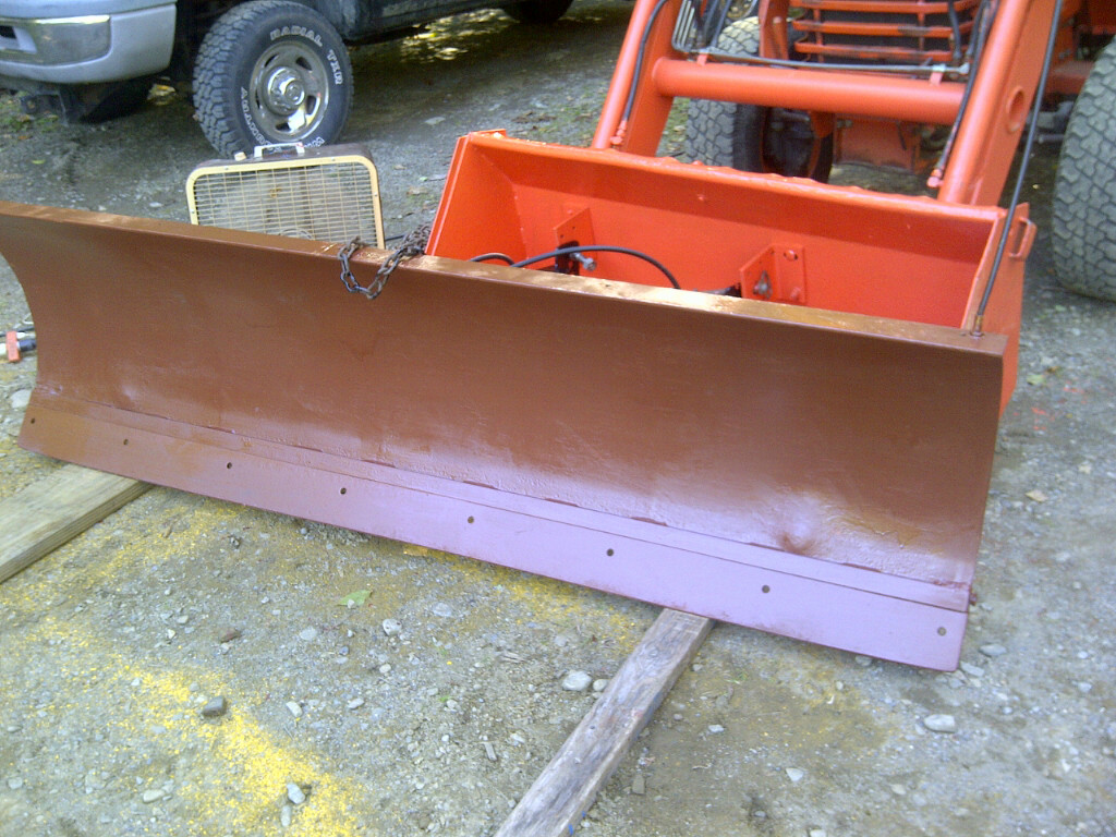

View attachment 399754View attachment 399755
Heres mine I went with 15 foot hoses to rear remotes for power angle, no snow yet but waiting:dance1:
I like your set up. Simple and straightforward. Have you thought of replacing the two mount pins in the bucket in the bucket with a straight rod passing through the holes? It would make it a little more rigid taking out some of the diagonal play.
Well funny you ask that, the pins that you see are temp pins I used just while building it, I now have full 1 inch grade 8 bolts no play at all. as far as the rod goes That is what I had but can't get it in the bucket and slide it through as it was too long, good idea though. thanks for the suggestion though.

if you look careful at my pics the blade is mounted 18 inches to the right I can wing back the snow on my 3/4 mile road after I plow with the truck or plow with the blade. But the big one is you can run it up the piles of snow and push snow another 6 feet high. I also drive down the road on the edge with the bucket up and take the tops off the banks so there is room to plow more snow. after last year we needed every snow weapon we could lay our hands on!! with the power angle you can turn and scoop snow I did last year with just the bucket and this works a lot better for snow, although the bucket comes in handy in some spots so I just pull the 2 pins and ready to go.
