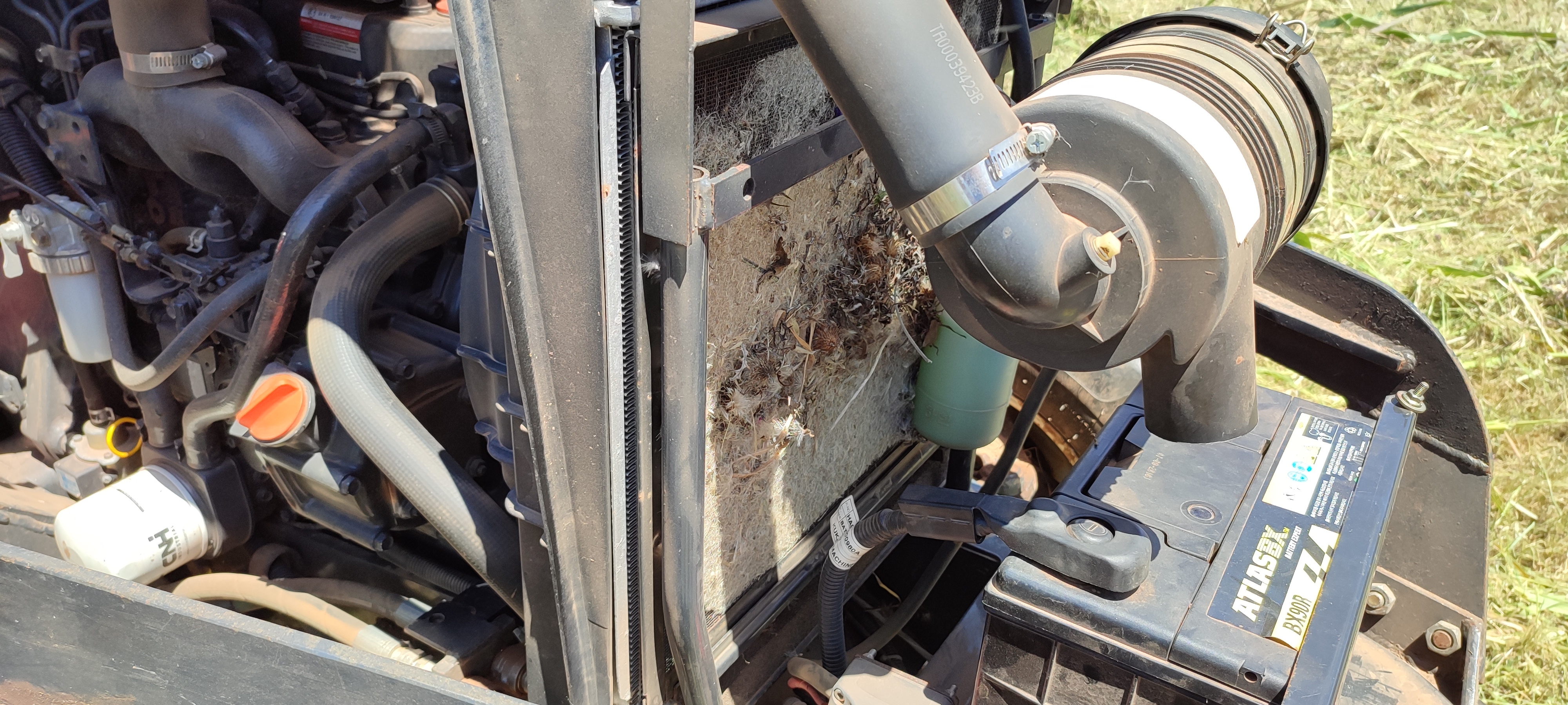

I mean, this picture was only about 30 min worth of brush cutting to get to that point. In this case, it wasn't getting hot. I just knew with the stuff I was mowing, it was prone to happen very fast. It was just a matter of cleaning the screen too and it was good to go again.
A lot of people don't even realize that depending on what they're cutting, they may need to cleaning those radiators multiple times during the job. Then, they found the expensive way that they really should pay more attention to cleaning the radiator. I've seen others blame the manufacturers for using small radiators or some nonsense like that.
This is all part of owning and operating a tractor.
That's the way my radiator screens looked after a couple of hours in mature dove weed last year.
When the temp gauge would start climbing, I'd get down and pull the screen and whisk broom it off, then do the front of the radiator, put the screen back on, and keep going.
