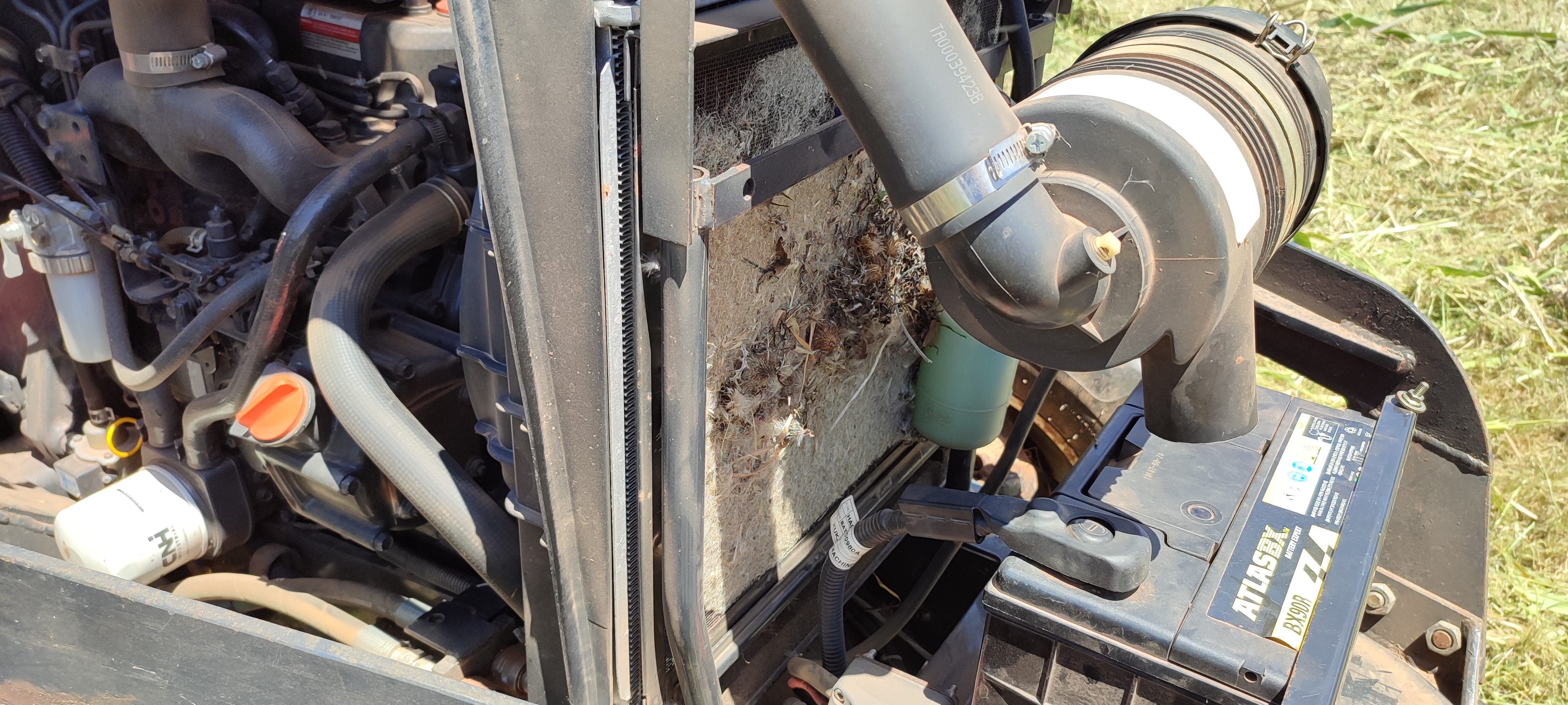

I mean, this picture was only about 30 min worth of brush cutting to get to that point. In this case, it wasn't getting hot. I just knew with the stuff I was mowing, it was prone to happen very fast. It was just a matter of cleaning the screen too and it was good to go again.
A lot of people don't even realize that depending on what they're cutting, they may need to cleaning those radiators multiple times during the job. Then, they found the expensive way that they really should pay more attention to cleaning the radiator. I've seen others blame the manufacturers for using small radiators or some nonsense like that.
This is all part of owning and operating a tractor.
Im surprised there isnt a prescreen before the radiator. My kioti has one. It catches nearly all the crap before it gets trapped in rediator.
There is one. That's what all that cotton stuck too.
That time, I just parked the tractor so the wind would blow from the engine side to the front and tapped the screen. All that stuff came right out.
   / I Won't Operate My Equipment in Wet Weather #38
Ok, hard to tell by that picture.
