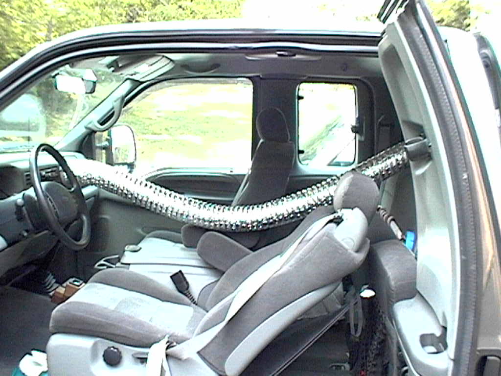

Is that one of those cool boxes like they use in NASCAR mounted on top of the canopy? /forums/images/graemlins/grin.gif Looks like you are all set with your AC and all. /forums/images/graemlins/laugh.gif
   / I would like to get a canopy for my tractor? #13
I had to go back and look at my picture to see what you were talking about. The box is just an old cooler sitting on the shelf. The hose is used keep the dogs cool when we're taking a long trip in the summer heat. Sends cold air back to the camper shell.
