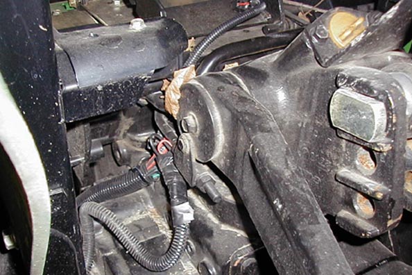

Bob
Attached is a pic of the rear of my JD4300, showing the wiring harness where the connector is for the work light. Sorry I said it was to the right of center, as I found out it was to the left. Just under the left rockshaft arm. There are two enclosed bundles of wires, and I have the connector and connection taped together. The red wire is from the light, and I think John Miller III was right when he said the purple wire in the harness was the correct one. Good luck.
   / Idea for rear work light...
#22
<font color=blue>...Attached is a pic of the rear of my JD4300, showing the wiring harness where the connector is for the work light.</font color=blue>
Beautiful shot.. thanks!
If I go this route rather than wiring in an additional switch, then I would just have to get some wire, connect to the correct (probably purple but I'll test to make sure) lead, find a way to run my new wire up into the ROPS, and then open up the rear work light, undo whatever wiring they did at the dealer, and connect it up. Sound about right? What type/gauge of wire would I need? Should I solder or just crimp?
Thanks again!

You have the right idea. No. 18 wire will work fine. Crimping is fine too. You will have a better idea when you find out how they hooked up the light you have, then see what additional wiring is needed. A short length of stiff wire may be needed to push through the ROPS first, from the light down to near the axle.
