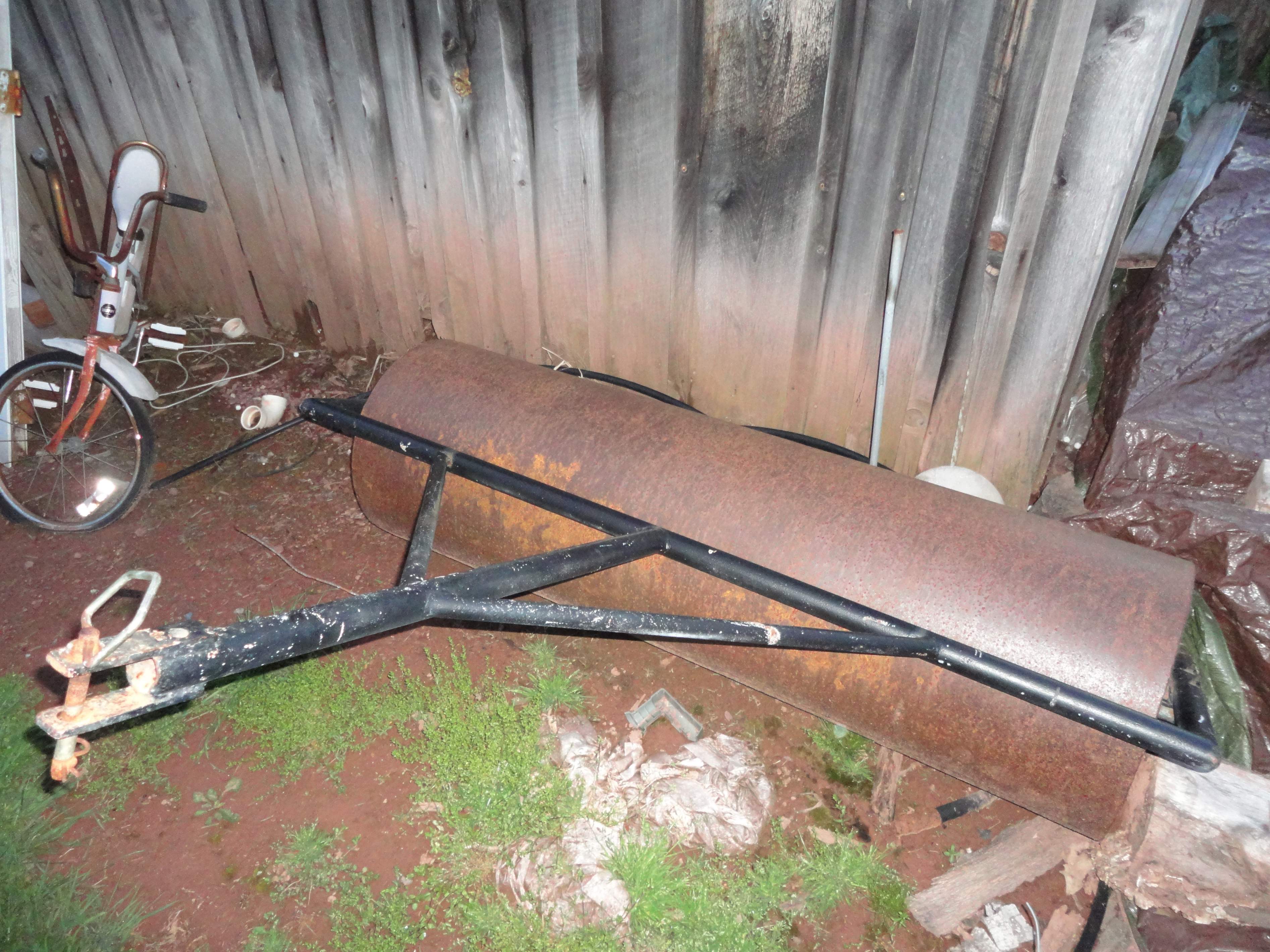

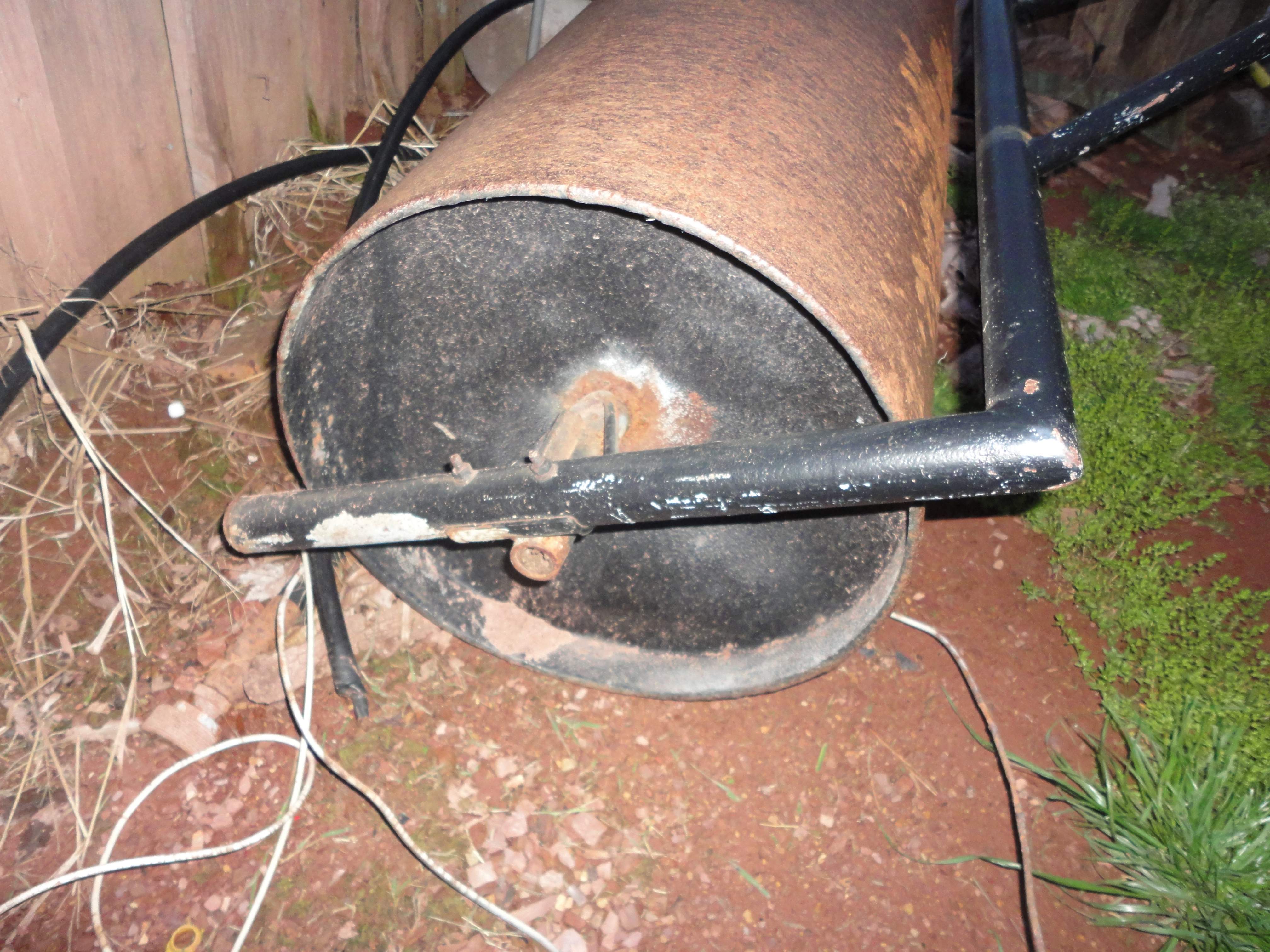

I have a big plastic tank roller I bought at an auction on the cheap but an old friend gave me one that is 30" wide and about 14" across the end of the roller that was built from air conditioner galvanized duct pipe. They took two end caps, drilled holes in the centers for a piece of 3/4 inch pump pipe to stick through extending about 5 inches beyond the ends of the roller. Stood it up on one end with 1 cap installed, stood the pipe up in the center but had it blocked up off the ground the proper height, started filling the duct pipe with concrete and took a rubber hammer to beat on the sides to move the rocks away from the outside somewhat, just like when forming with wood, filled it full and installed the other end cap. He says it's 30 yrs old and is still holding up well. If the sheet metal rusts away the concrete will still work without the outer skin.
Duct pipe it somewhat cheap, easy to work with and is basically to hold the concrete in place til it dries but after 30 yrs mine is still in good shape with the duct pipe still attached. After it dries, build up a towing frame...cheap n easy build.

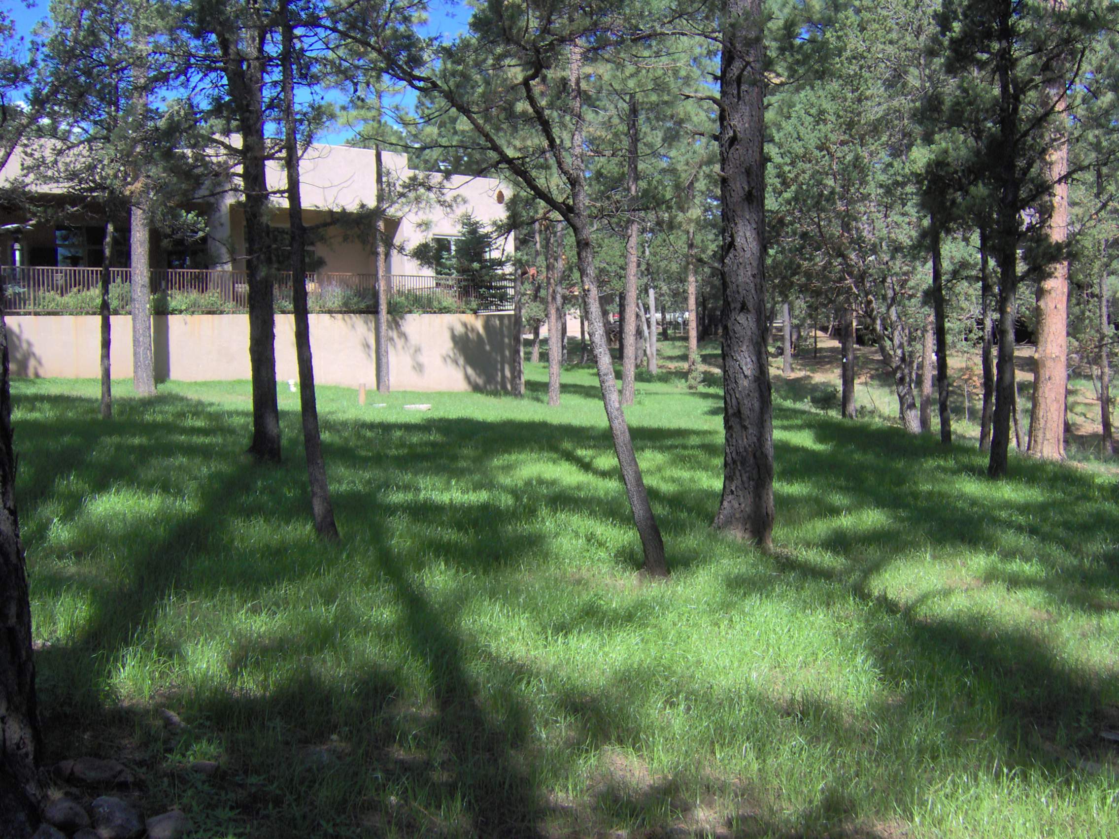

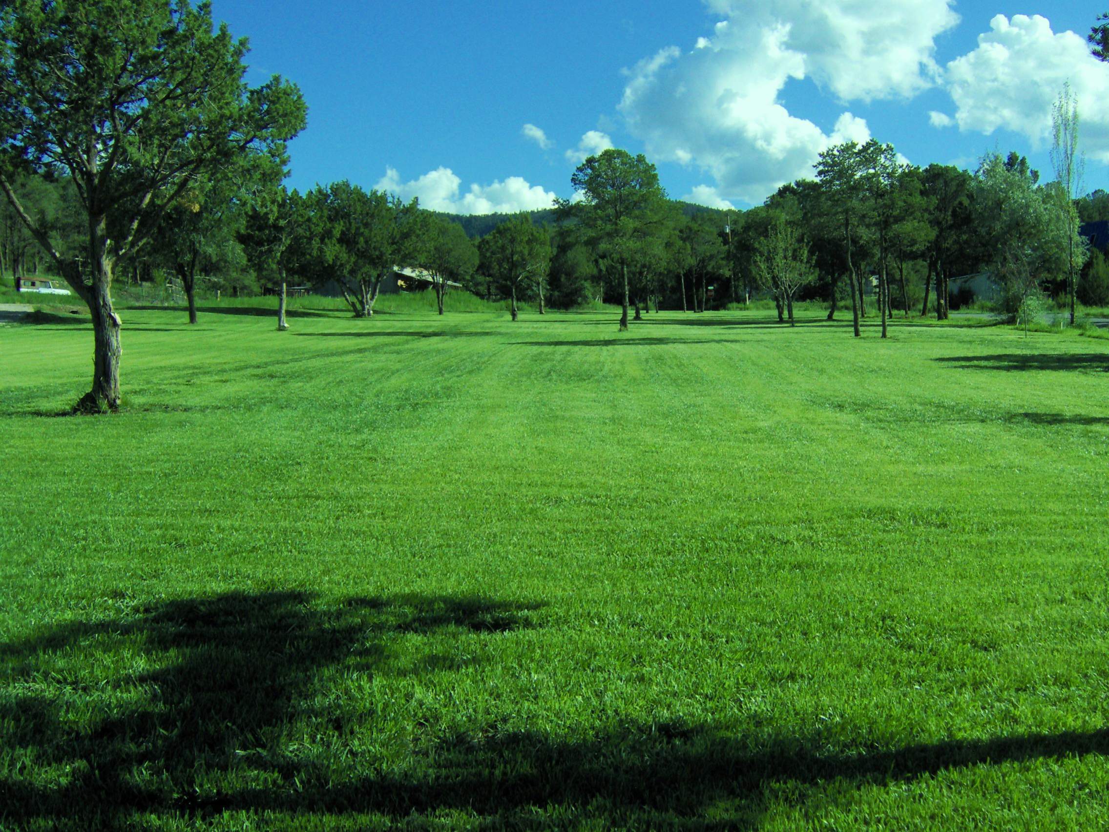

I use a landplane grader scraper to smooth out lawn areas, gets it flat without leaving it overly compacted. Then run a smaller 18" towable plastic roller filled with water to improve seed contact. Best if the ground is slightly damp too. Here's some pics showing the ground after rolling and some where the grass is up later.

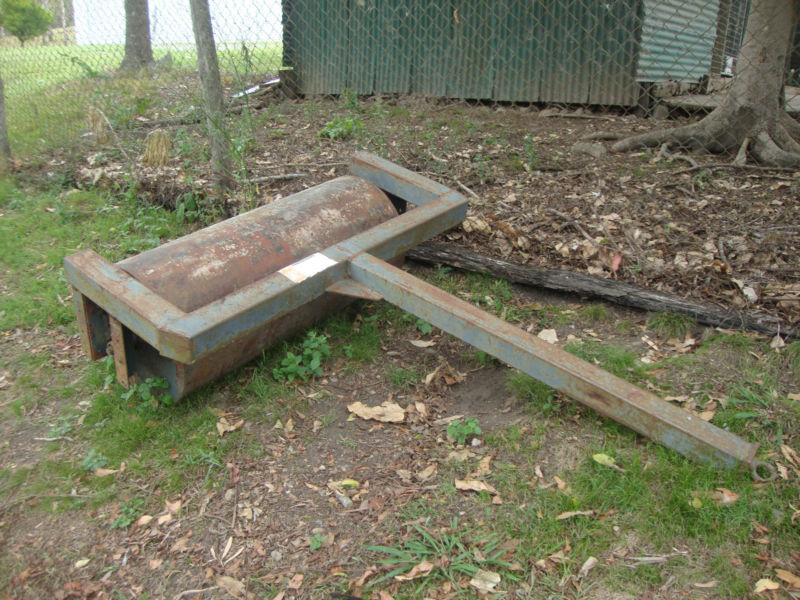

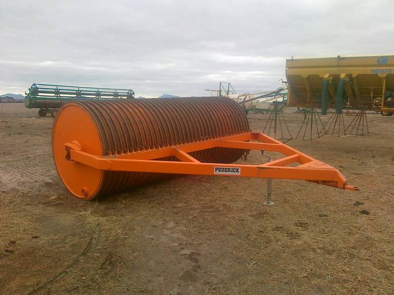

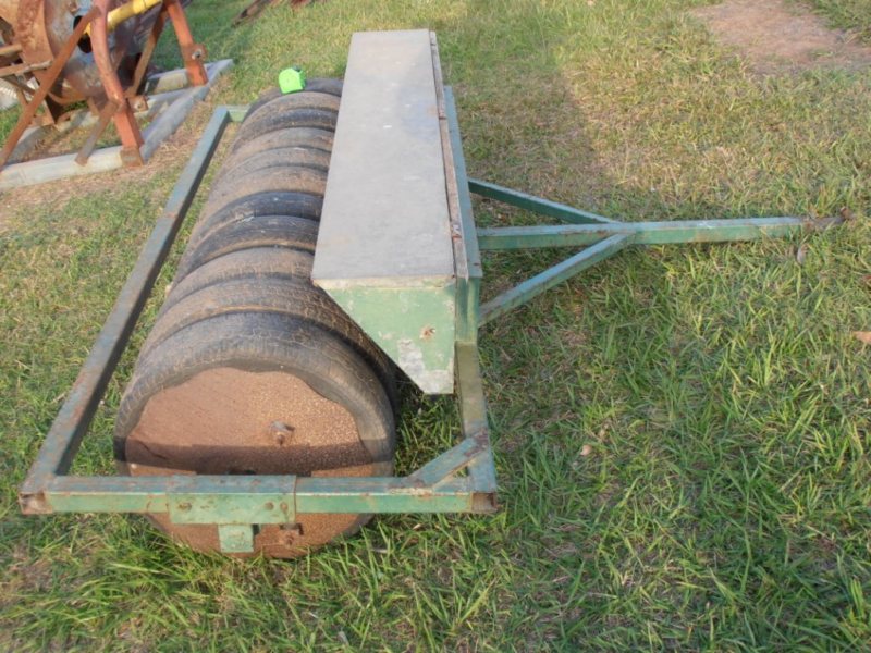

Rollers are reasonably easy to make - pipes, cylinders, tyres all can be used - below is a few we use around the farms:
- c.40" smooth steel pipe roller filled with concrete & capped
- c. 12' ribbed steel drum roller water ballasted @ c.9T/empty c.4T
- c. 6' tyre roller, tyre are low pressure filled with water, rims welded to centre tube & end capped welded to old plough discs/bearing carriers (& fitted with seed box)

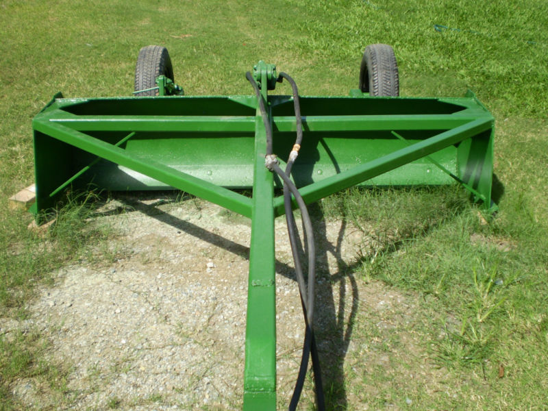

For levelling lawns we built the small carry drag scraper pictured (works much like a small landplane) to take out high spots/fill hollows pulled by c 18hp Kubota/Iseki or in lighter applications a JD415 - The 120" long drawbar assists maintaining levels (& makes for easier reversing), the single hyd ram acting on the rear wheels pivots the assembly for cutting,controls dumping, spreading of material & lifts the assembly for easy unhindered transport/ there's also a old screw adjust 3pl toplink which pivots the RH wheel so the unit can easily be tilted (ideally I'd have fitted another hyd ram but my JD415 doesn't have another remote nor did I have a suitable valve laying around).
With then follow up with the tyre roller which suitable "flex's/bags" with the water filled tyres so no ridges are left by the implement.
