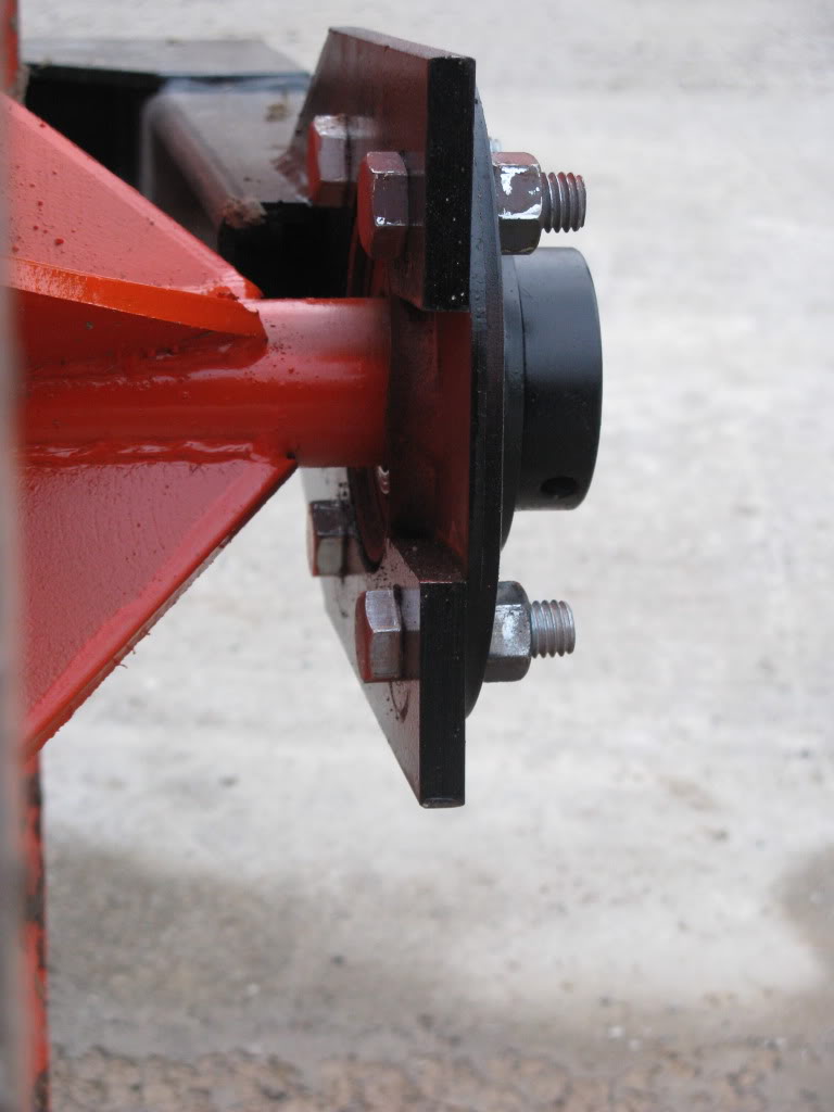

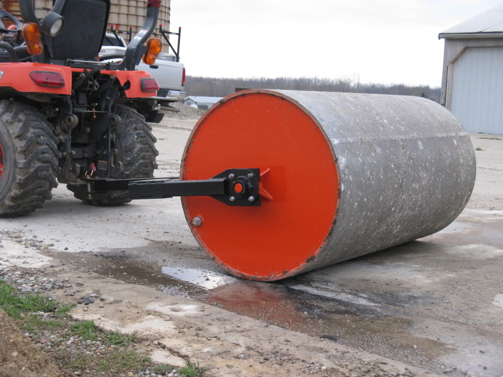

http://www.tractorbynet.com/forums/build-yourself/204021-how-i-roll-lawn-roller.html
