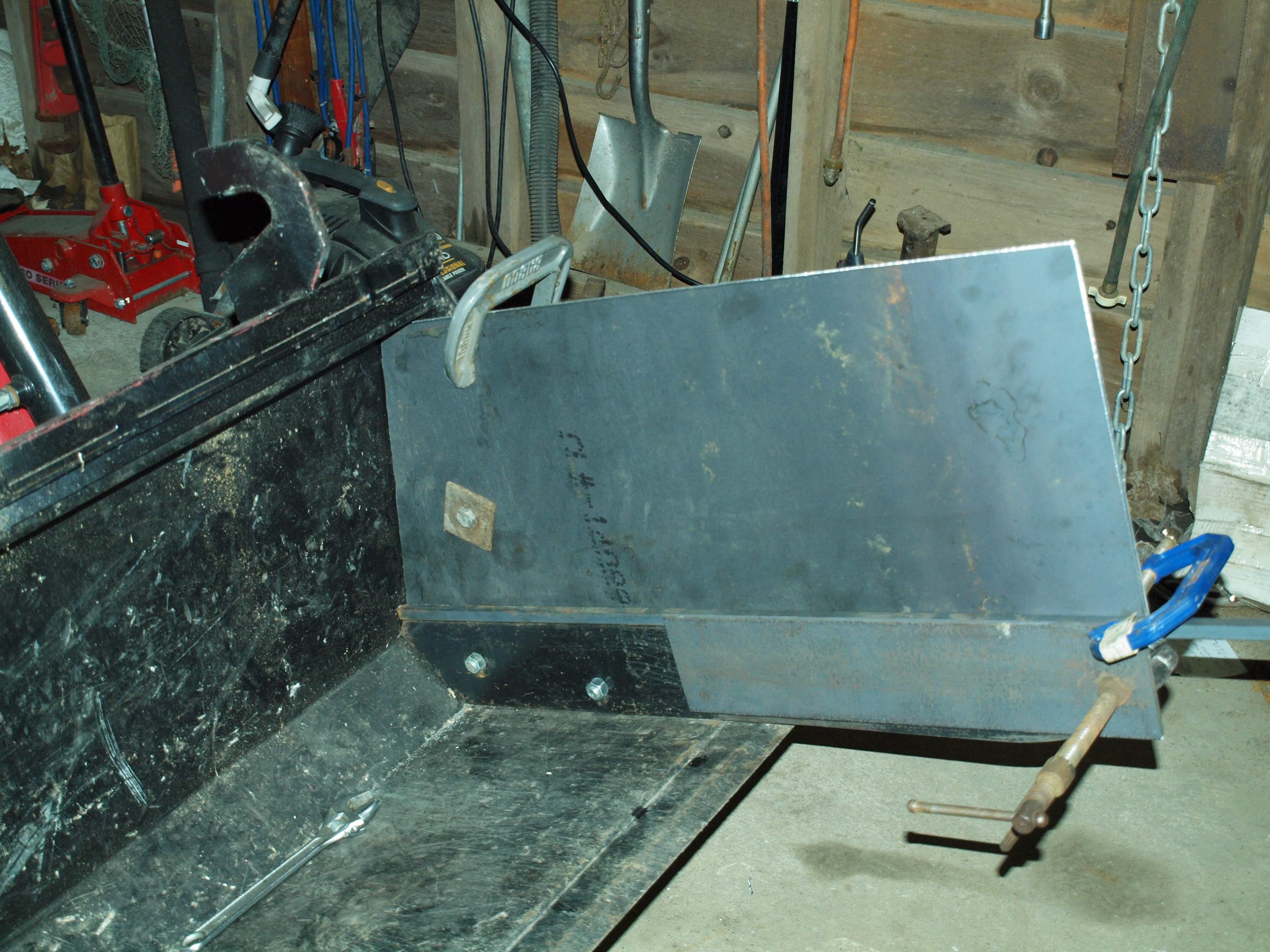

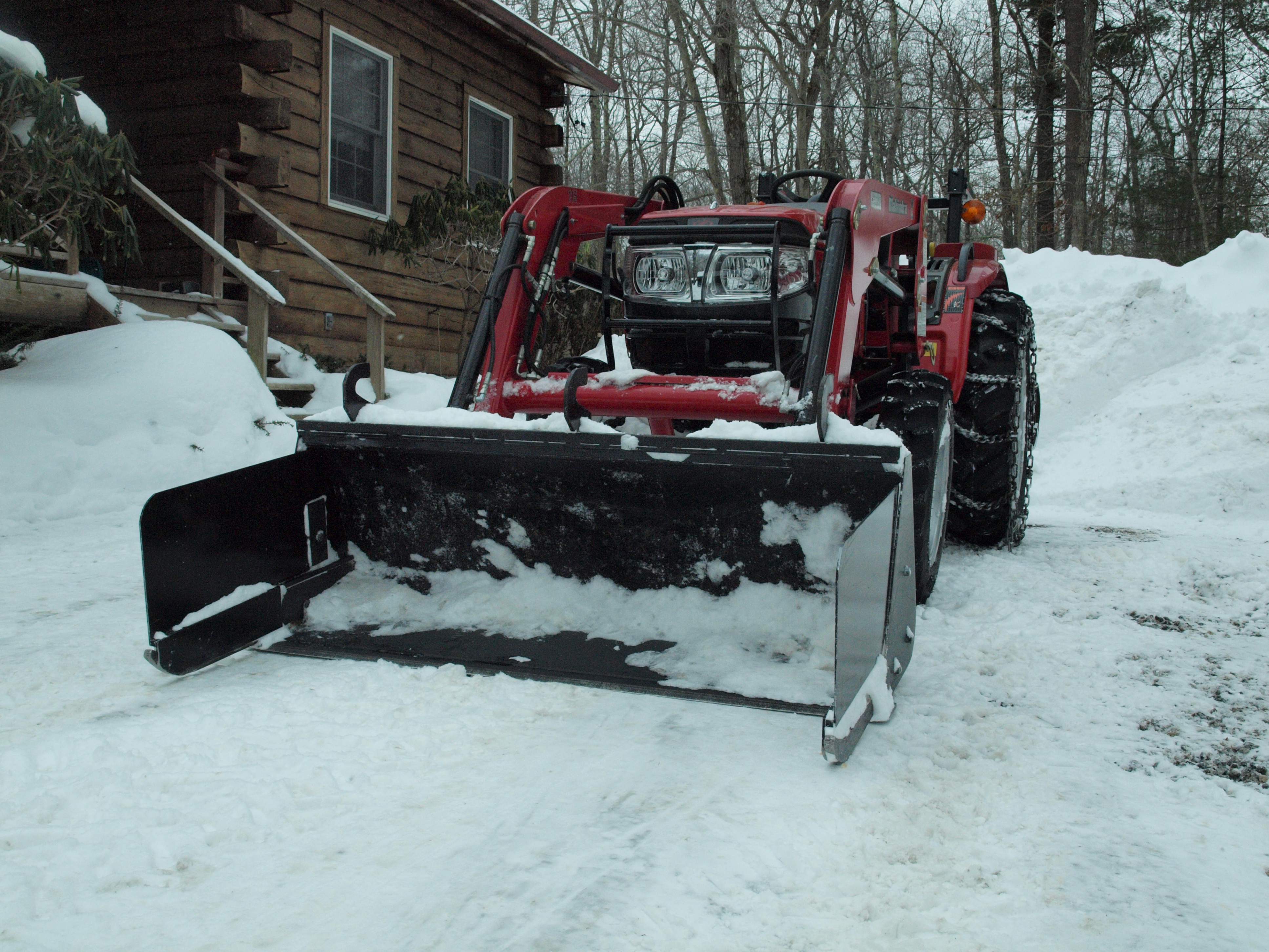

A heavier tractor for one. Snow pushers gather a lot of weight. I do not know if i would consider anything over 48" wide for your tractor. The buckets on these things are so shallow, I simply rigged up sides for my bucket on the 3016. Grand total of $50. It is 60" wide and has cut my plow time considerably.
Thanks! That looks like the way to go. The front sides you made look like they would also help keep the bucket from digging up the ground. :thumbsup:

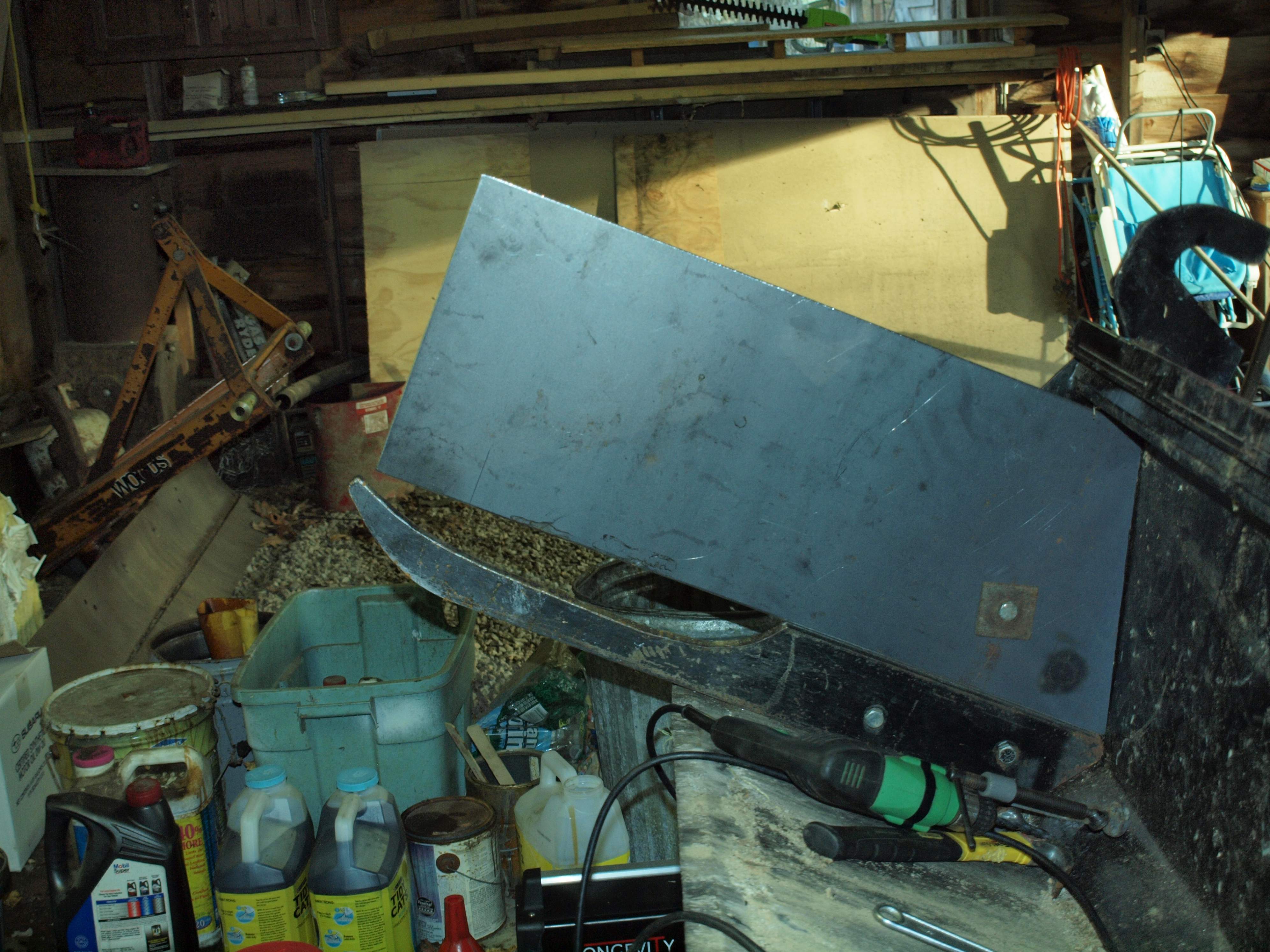

If the sides are long enough, you won't have to dump. I don't on mine unless i have a real long run and want to gather all the snow in one shot. As I stated before, the buckets Mahindra uses on their stuff are of limited capacity. This shallowness is your friend when rigging up a pusher.
I pick up logs with forks on the bucket. The pusher sides are resting on my log forks which have the added benefit of preventing dig in. I'm a believer of "one bolt" on and off's. (well the forks are held on with two but the pusher sides are held on with only one)
