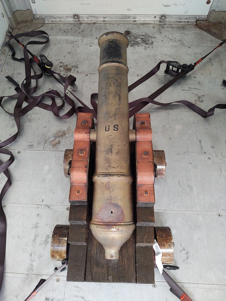

I still don't see a picture of the ignition hole
I guess I "see" it since I know where it is but here's a top view.

Expanding foam crossed my mind too.... for about 32 nano-seconds. I didn't like the idea. I don't know much about how much pressure it would have, but I felt two things.
1. It would be a mess to clean out (though maybe a good reason to fire cannon several times!)
2. There is a flat spot on the ball, so there is a "hole" (gap between ball and bore) where the stuff would just extrude itself out.
Right now my thinking is fix drill. I don't want to use my hand-held as this was putting out some torque. I would not want to hold that back with my wrists. The right angle gives me some leverage to better hold the drill.
Make no bones about it....one way or another, it is coming out. I don't know if I'm at a choke point in the bore or, more likely, the angle of the ball is getting it wedged. I was holding front of cannon with both feet while pulling on drill trying to pull ball out. It wouldn't move forward after a certain point. I THINK, but am not sure, that the ball got bound in there but that might be when the drill chuck bolt snapped.

Why are you resisting cleaning/scouring/honing the barrel which would likely ease, if not solve the problem? Flat spot or no, that ball should travel easily. You're working against years of gunk that's going to have to come out anyways before firing.
And not knowing the last few years of history, do you have any way to have that whole thing x-rayed or otherwise inspected for defects?

Summer heat may be your friend. Get the darn barrel CLEAN. Get some grease or lube behind the ball. Try on the hottest days, after it's sat in the sun, maybe assist it with anything you have that will throw a flame. Then when hot lift it so you CAN drop it with a serious whack on a piece of wood (so as not to damage the barrel), but start off with gentle whacks.

I'd strap the cannon and carriage complete assembly to that dolly you have with 2" ratchet straps. Then pick up the whole package and hang it upside down. Everytime you walk past it give it a shot of PB Blaster in the ignition hole. It'll come out.

Since the OP likes his drill bit, has got it moving and may not be able to hang it with a pulley and drop it down on a piece of wood I would now suggest he get some holes in the ball so he can rotate it to get it out.

I'm not against anything. When I've been out, I've not found what struck me as the correct tool. Granted, I have not spent a great amount of time looking as I don't have time during the week while working.
There really isn't much gunk in there now. The sides are a bit coarse yes....but I've cleaned much (all?) of the gunk out. Don't forget, I DO have a bore cleaner so it is getting anything that's loose.
Regarding X-rayed/inspected.... do I have any way of knowing that it's been done or not? Yes. I can pretty confidently say (as in 100%) it's never E.V.E.R. been done. I don't know the last few years of history, in that, is it possible that my father or his wife were doing something with it? Yeah, I have no clue. But given that I wasn't there, I can be just as 100% sure that they've done nothing with it (as in firing) for years (and years). Wouldn't surprise me that it would be 30 or more. Keep in mind, he's 92 and simply moving it is an act of effort. He lived in Bluffton SC for years, prior to that, he lived on Hilton Head for 40 years so not many places that might like a big bang in their back yard.
