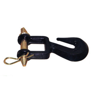

I just wrap a chain around the posts I want to pull and hook it to a grab hook on my pallet fork frame and boom up. If it doesn't pop right up, a little back and forth on the HST pedal and then they usually come right out.
