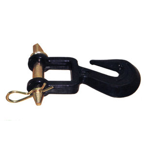

To avoid bending a 3-point drawbar by lifting, use a drawbar hook or two. The drawbar will pivot so the strong side is always facing the load.
Hook For Drawbar On Tractor 3/4 Pin
Bruce

good idea to keep this angled the correct way. OK, so for the most part, it seems the majority agreement is to use the 3pt hitch. I am heading out there sunday. So if anyone else has a dynamite solution, let me know.

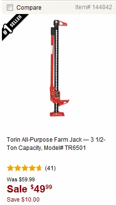

Ken,
Although you asked how to remove the posts with your tractor, there's a non-tractor way. Use a farm jack and a chain. This one will lift 7000 lbs, much more than your tractor will lift. No issues being so close to the swimming pool.
Torin All-Purpose Farm Jack 3 1/2-Ton Capacity, Model# TR6501 | Farm Jacks| Northern Tool + Equipment
Obed
I actually own this jack (hi-lift jack from my off roading days) and tried it on old fence posts years ago. It did work but was a real issue. Almost not worth the effort (unless I was doing it wrong).
I found it unsteady with the chain constantly slipping. I will be takin this with me for an arsenal if necessary on Sunday.

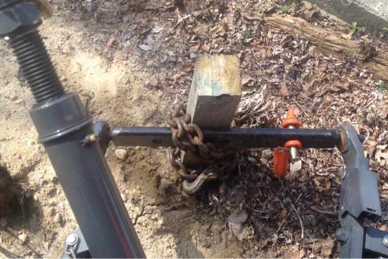

<img src="http://www.tractorbynet.com/forums/files/projects/372120-ideas-pulling-wood-posts-tractor-11962-jpg"/>
Bruce
The hook was a fantastic idea that kept the bar at the right angle.
The wood posts came out with the chain and very easy!!! Thanks for the tips. As for the aluminum, the chain would crush them or slide off. That was until I added a vise (idea from YouTube which had negative comments). Well, that guy was right and proved to work awesome!
