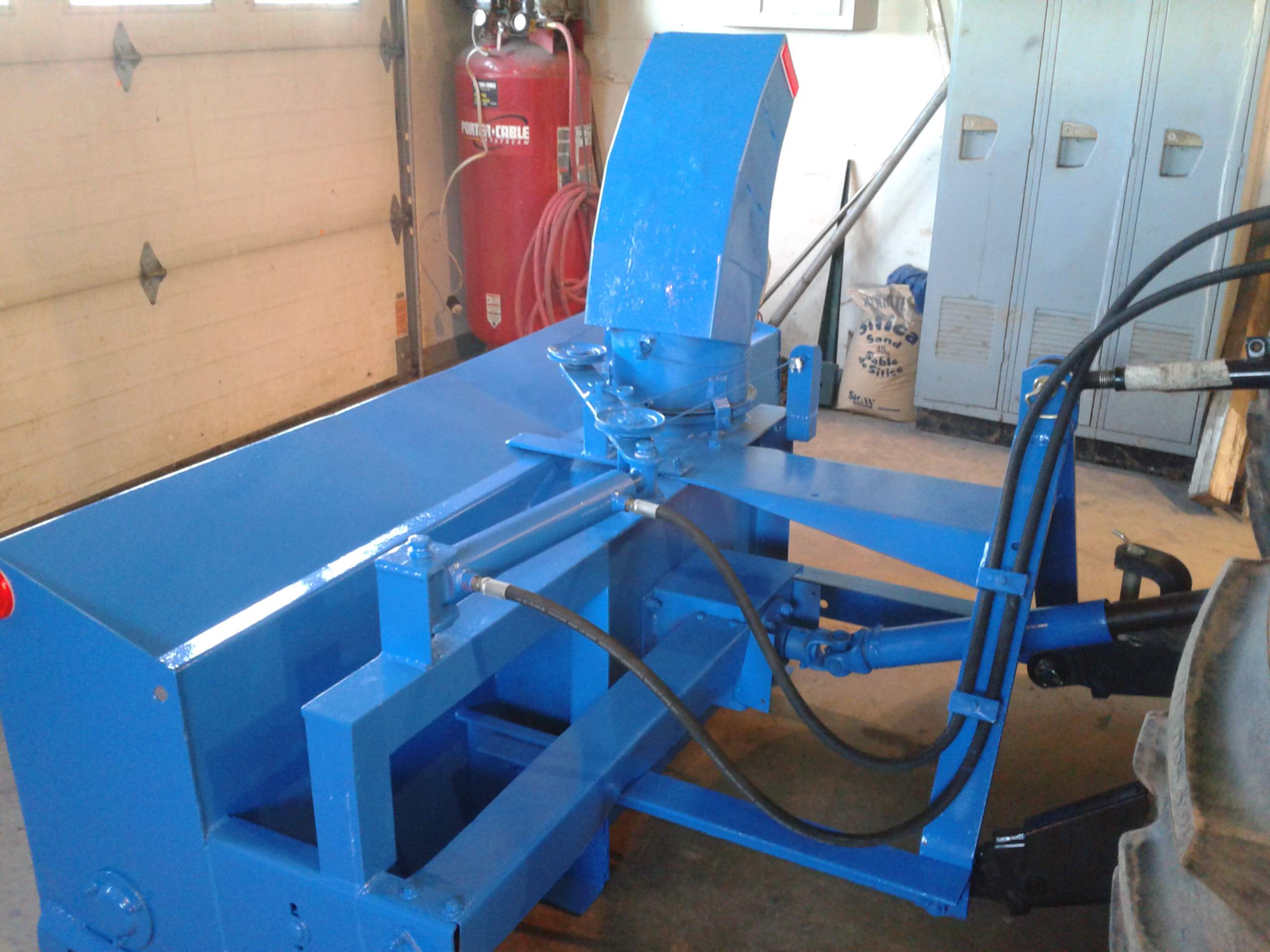

I just switched mine over this winter. Last winter I run the snow blower on the back of my MF 135 so when I put it on the back of my new LS 7010 I put a hydraulic cylinder. Didn't see much since of having to get out of a heated cab. Here is a couple photo's. As long as you have a welder it is pretty easy.
