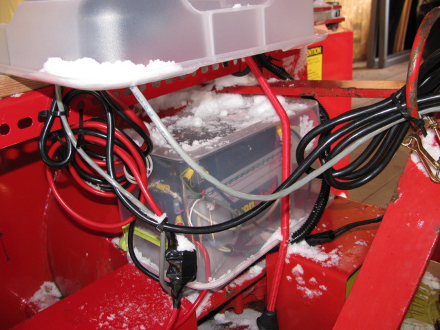

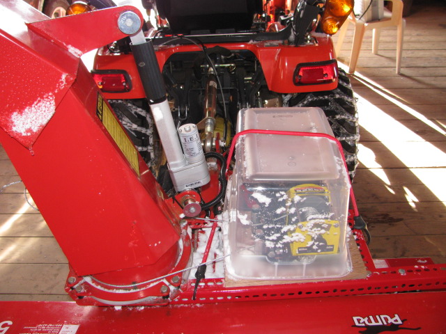

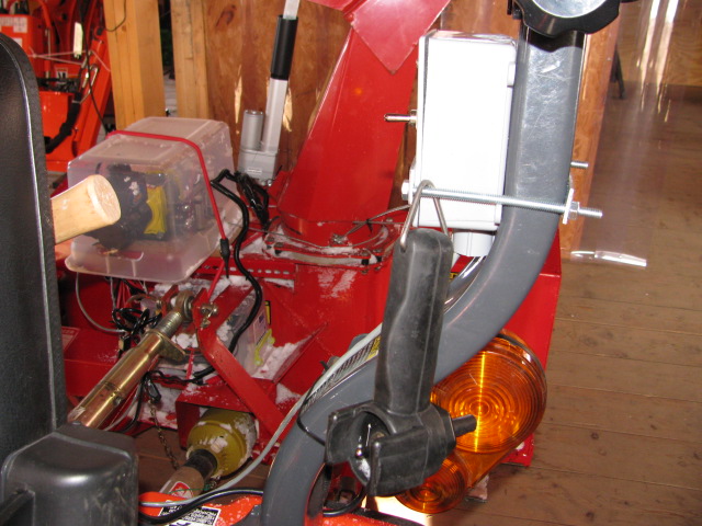

I got a used Puma this year with a hand crank and a fixed position bolted top flap. After seeing this thread just had to copy theses ideas. Used a Superwinch 3000 from Amazon $114 that includes the remote switch already wired up. The actuator for the flap was from speedwaymotors.com $99. Used a separate battery with fuses sitting on the blower. Tried the spring method first but not strong enough to reliably rotate the chute. Covered things up with a couple of storage containers that make it easier to clean off the snow without disturbing the connections. It really helps to keep at least some of the snow off you when it is windy. IMG_0515.JPGIMG_0514.JPGIMG_0513.JPG

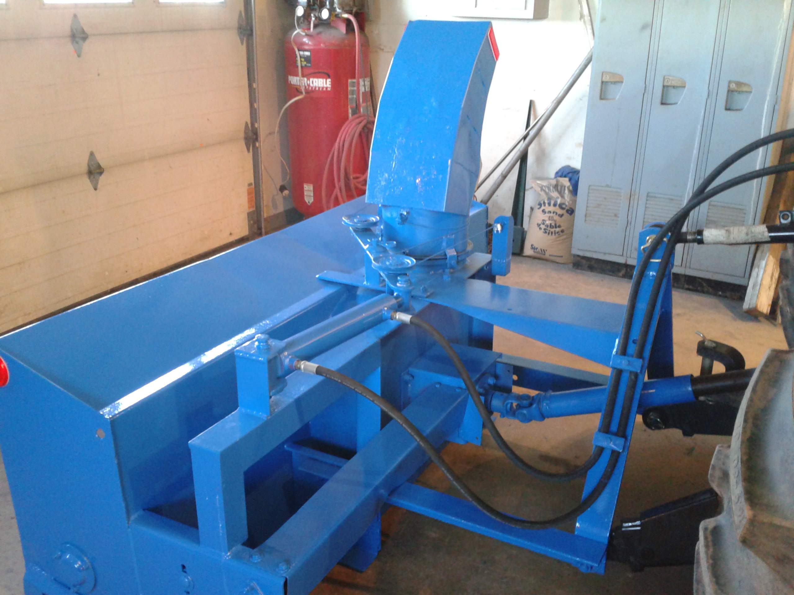

I just built one about a month ago. About the same idea but I used a couple small pullys. Drilling holes and welding up a bracket took the longest time.
