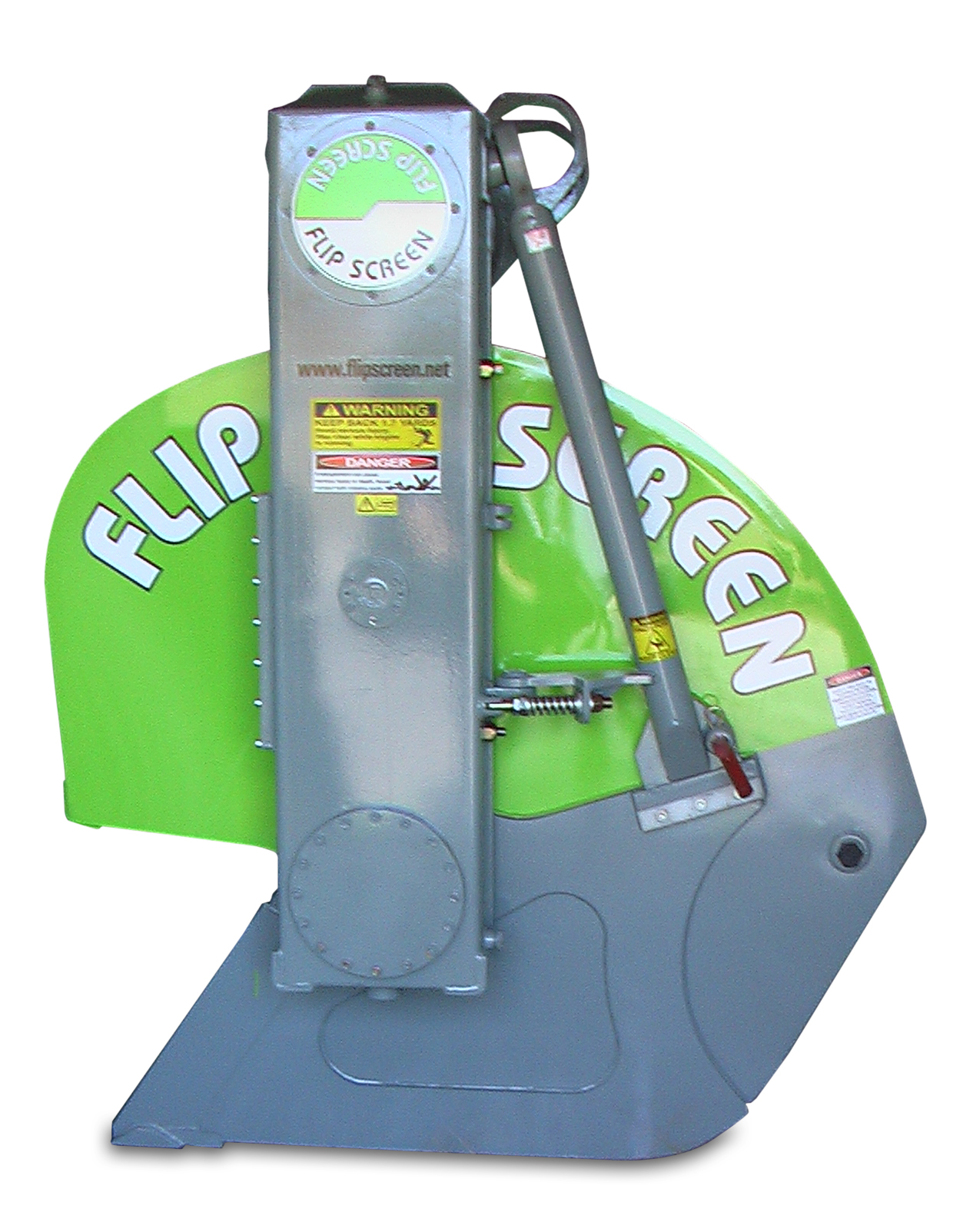

have a moving pin that is attached to a small hydraulic cylinder and the pin extends in to a notch or notches that hold the bucket stationary, when power is applied to the hydraulic motor the pin is retracted by the cylinder, the pin could be spring loaded to engage and even a single acting cylinder tied into the motor circuit would make it automatic,
   / Ideas on how to arrest a rotating bucket #15
If you look at the picture, in front of the arm on the bucket there are two tapered wedges on the bucket with a space between them, I think the rod rocks a dog or pin (as I suggested above) and it locks the bucket in load,
with out a parts list or different view not exactly sure how it is operated, in combination or by it self (one circuit or two hydraulic circuits, one for the motor and one for the dog), there seems to be on each side,

BHD. Upon reading your idea, I liked it, but after thinking about it, I wonder if the shear forces would bend the bin?
All the sizes of Flip screens seem to have this same ROD! This is stressing me out a bit and has caused more then one sleepless night. I really would like to have one of these units or my poor mans version, but don't want to screw it up too badly.

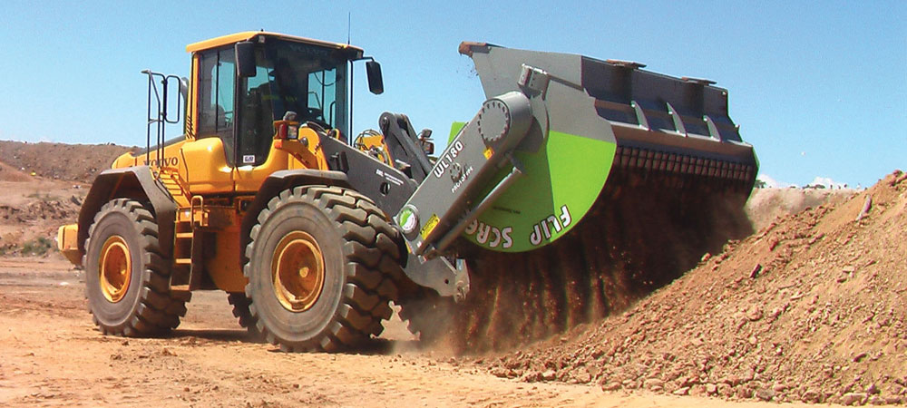

I am working on building a rotating bucket with screening capability. It will be similar to a product called a "Flip Screen Bucket". I have most of the design worked out, but my problem is in how to locate and arrest the bucket for the digging position. I see they have rods going to the bucket bearing location and am sure that this is used to arrest the bucket. I have never seen one in person to be able to see how they did this.
I thought of possibly an electric brake on each side, but this seems too costly, possibly unreliable and maybe too cumbersome. It could have been used in conjunction with electronic position sensors. It would be nice to find some off-the-shelf solution.
Any thoughts or ideas?

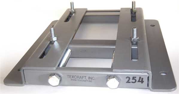

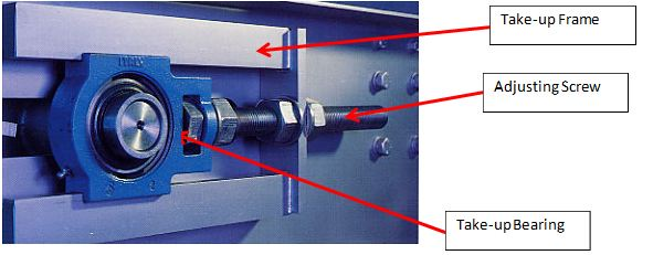

Fix a jack shaft on the back side bearing on each side, and cut a slot (slots) to adjust the unit back for tighter, some bolts weld the nuts to the frame so the bolts can push the bearing back or make a holder that can be pulled like some motor mounts are made, The motor can be done the same way.
taka look at the motor mount, and say the main frame is the side frame of the bucket, and the slide bar is attached to one of the bolts on the hearing housing, to pull it in the slots in the frame,
the second one is more involved.
if the reverse was on the non loaded rotation I do not think even using a idler for a tighter would be that bad of a situation,
also with some half links one could just adjust the chain for stretch and adjustment, with no moving of bearing or motors, #60 chain has a pitch of 3/4" so you could adjust the chain to with in of 3/4".

use a slow RPM motor you would not need a lot reduction on the chain drive.
