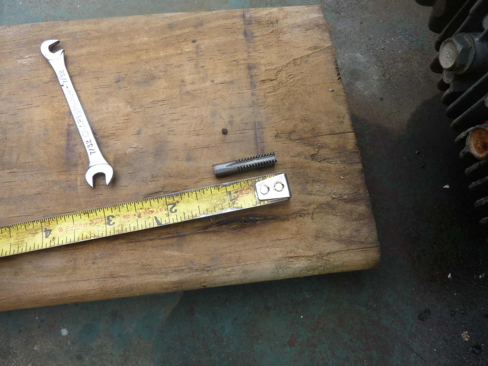

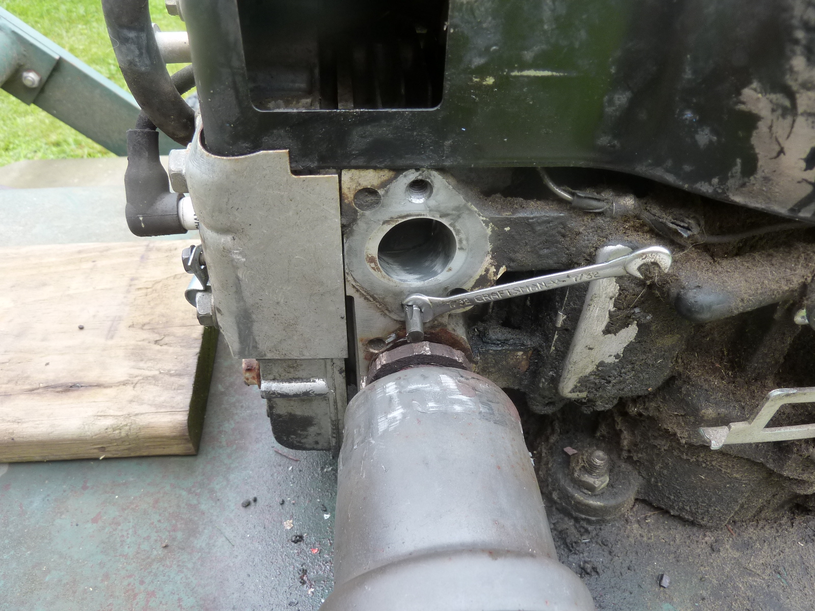

Rather than cut off the muffler and remove the pipe by splitting it and folding it in with a chisel and then having to find a new muffler, I decided to experiment first. Nothing to loose. Fixing it right is a better winter project.
The hole was 3/4" deep but not threaded to the bottom. I made a rough short bottoming tap from a HF tap I had ruined by actually trying to tap a hole with it. Cut it with a disc on the right angle grinder.
I was able to get an additional 1/4" of threads at the bottom of the hole. It is just starting to cut in the pic.
Made a couple SS studs from bolts and reassembled with some high temp loc-tite. It is a lot better than it has been in a while. Now I can mow and do a better fix at a more convenient time.

Congrats, function is beauty !
   / Ideas on Stripped Bolt Hole ??? #14
Nice work Gordon. Gotta love it when a plan comes together!
   / Ideas on Stripped Bolt Hole ??? #16
Yes. Yes he did.
   / Ideas on Stripped Bolt Hole ??? #17
"Made a couple SS studs from bolts and reassembled with some high temp loc-tite. It is a lot better than it has been in a while. Now I can mow and do a better fix at a more convenient time."
I think you just made a permanent fix. If it works just leave it.
