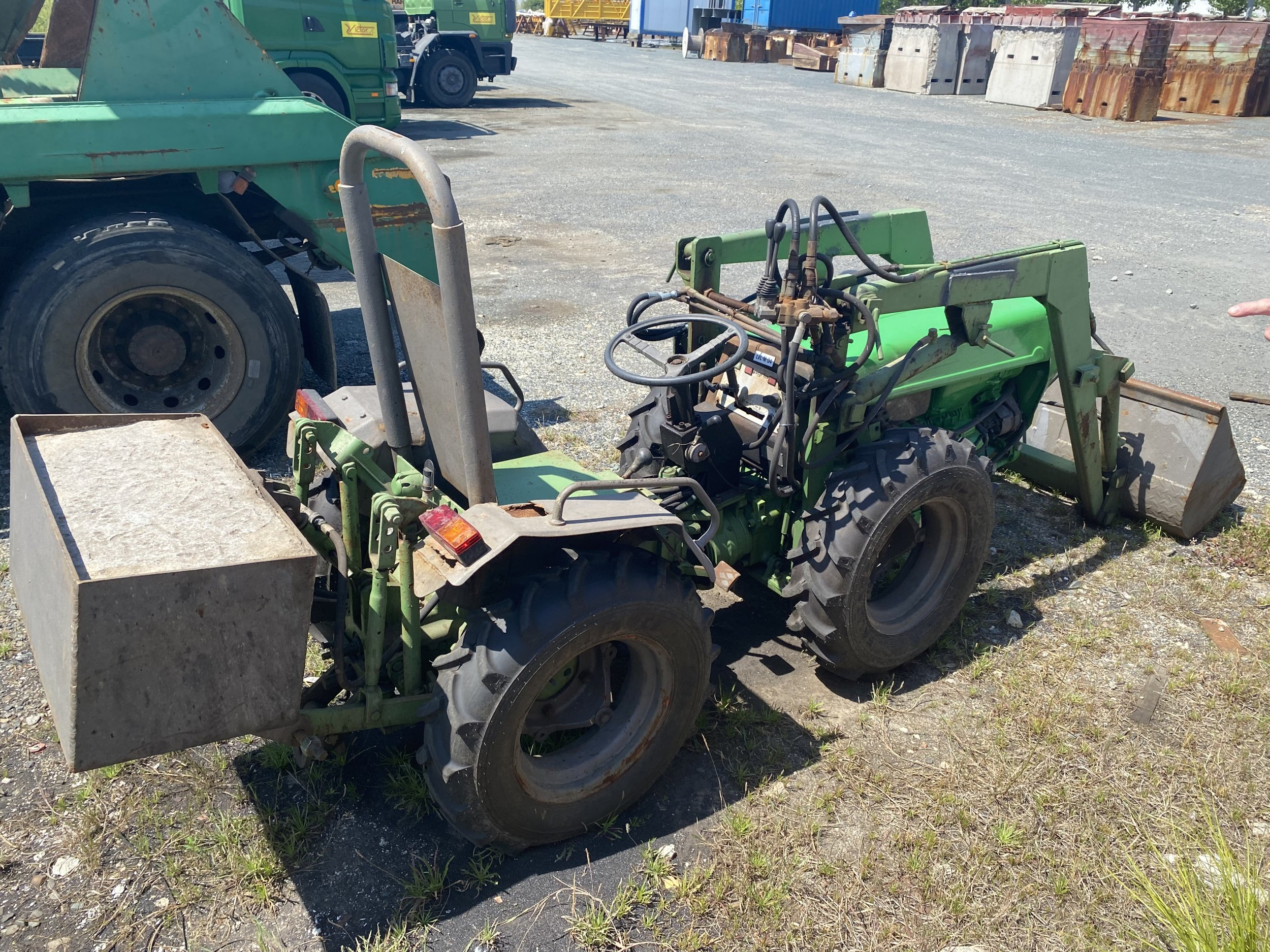

/ Identify this tractor #2
I can't pretend to know the brand, but if it were any more Italian it would be leaking pasta sauce.
/ Identify this tractor #3
It's green. But don't think that helps here. I will say one thing - must be a tough little bugger to handle its own weight in ballast.
Lol. Yes. It is located in Spain. Not sure where it’s origin is however.
/ Identify this tractor #6
European Holder Tractor maybe A30?
/ Identify this tractor #7
Looks similar to an old Ferrari tractor.
I'll see if I can find more info.
/ Identify this tractor #9
Went down the rabbit hole trying to find the brand. Here's some of the stuff I found, but haven't seen the tractor on any of the sites:
Agri
Agritalia
Antonio Carrera Agritalia
Agrimac
/ Identify this tractor #10
Well it sure as heck ain't from around here! :ROFLMAO:
/ Identify this tractor #11
Ok, It's an Agria. Not sure about the exact model but probably a 9900 model. Air cooled Lombardini diesel engine, around 35HP. Maybe 3 cylinders? Maybe 2.
Paint is not original along with the homemade ROPS.
#13
It has agria written on dash if you zoom in….,
#14
Curious as I’d look up the data. In size, it isn’t very big. But these tractors are deceiving in stats.
#15
I see online it’s saying a 9900 has a 25 hp. It does look like that model . I will not get a chance to look at it again. I wish I had taken a picture from the other side as well.
/ Identify this tractor #16
The thing with these tractors, no matter what brand it is (Pasquali, Agria, Ferrari, Goldoni, etc), is that the HP stated on the ads is not usually very accurate. The only way to be sure is to either read what it's on the title or to go with engine model.
The 9900 had a couple variants though.
#17
Ok. Interesting. They are a good design. Odd they never took off in North America
/ Identify this tractor #18
Well, it doesn't make for a good loader at all, so that's probably a big no. We really don't care much about loaders here. It's a great design to work on hills though and crazy capable. Hook a PTO powered trailer, flip that PTO lever to ground speed and you have a 6x6 rig capable of pulling crazy loads of logs over the hills on the woods.
The few that have loaders, have very limited capacity, usually less than 700 lbs, compared to a conventional tractor of the same size that will probably lift 1500 lbs.
The older articulated units were a bit dangerous because if you put the leg in the wrong spot, it could pinch you leg really bad. I guess common sense goes along way but sometimes looks back or something, things can happen.
/ Identify this tractor #20
I can't see it, but you are much closer to the tractor's location than I am.
