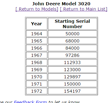

I think your dealer is correct in that your newly acquired tractor is a 3020. Can you post some photo's??
/ Identifying my JD Tractor #4
That should be a 1967 3020 rowcrop gas engine model with Synchro Range transmission. Also would like to SEE PICTURES!!:laughing:
