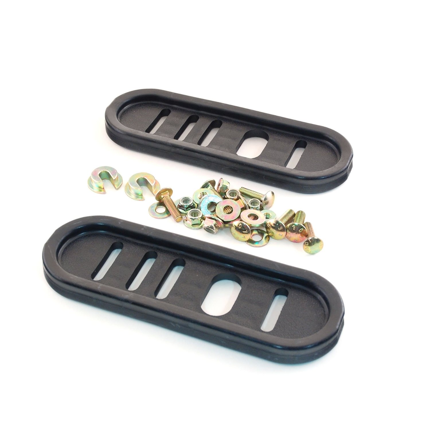

Yes, but the skid shoes would just dig into the lawn.
I'm going to try it in the next snowstorm, which shouldn't be too long.
I'm not seeing how the skids are digging as mine dont with the blade set at 1.5" off the ground (use a 2x4).. But, could you not make 'skis' by bolting the PVC along side/over the skid shoes? Front to back on each side, not across.
edit: I did replace the metal skids with these much larger poly ones:
http://www.amazon.com/Arnold-490-241-0010-Universal-Deluxe-Throwers/dp/B002MRM6KQ
Amazon.com: Arnold 490-241-0010 Universal Deluxe Poly Slide Shoes For Most 2 Stage Snow Throwers: Patio, Lawn & Garden
My stock skids are much smaller than those. The ski idea may work, but would be more work to attach and remove, and I want to be able to quickly take it off for my blacktop driveway. I think this is going to work. If the weatherman is correct, I should have the answer tomorrow....along with another genius idea, to be announced tomorrow...if it works.:)
Ya, my stock skids were much smaller too, and worn.. So I changed to these. They actually fit all the way front to back and dont dig into my sandy driveway. In fact, I have to do a little 'up' pressure on the handles to keep the nose planted :)
if you get a chance, try them out. At $30, they are worth it IMHO.
