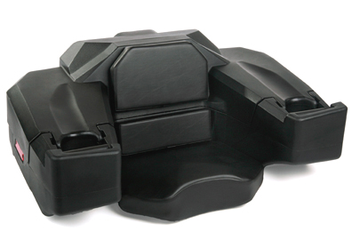

About the tool box issue, this just occurred to me...why not use one of the storage/seat accessories found on atv's?
Limitations or adjustments required might include:
  • It would only work for non-cabs,
  • you'd have to remove the seat on the unit so that your seat can get in closer,
  • you might have to make a bracket of some sort to fit the storage unit on your fenders
Anyway, just thinking out loud.
