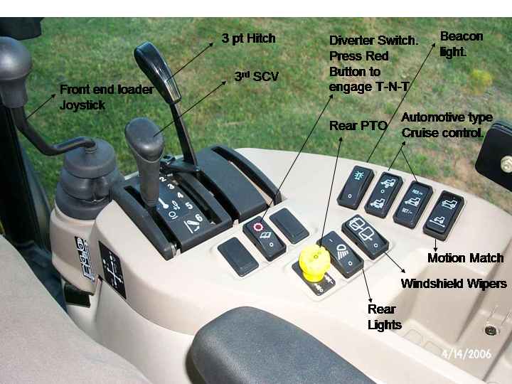

I wish the 3 pt hitch lever and the 3rd SCV lever were reversed. I have gotten used to it the way it is, but I still inadvertently grab the 3rd SCV when I want the 3 pt hitch lever. A couple of extra inches to slide the seat backward would also be nice. Overall, I am one happy customer.

TGlass, I can blend funtions on my Loader Valve. Mine works fine, for lifting and dumping at the same time. It is just a tad bit slower than normal, but it does do it just as well as my older tractors did. I Find that there is a precise sweet spot on one of my diagnals of the control valve. I tested this to make sure it did indeed work, and it does...for the cab model anyway.

JasonMac, sounds like I need to make another trip to my dealer. My 3320 cab model won't on curl and lift, on dump it's a big task to the point of full stop and waiting if I'm lucky enough to tweek the lever in the right position. The service manager told me he thought it was either because of the type of valve or not having the power beyond option that's not yet avaliable for the cab model. I know this has been a complaint on non cabs, but never heard the cab models would. Please re-confirm this and I'll be off to the dealer.

   / If You Could Change/Want/Miss Anything On Your New JD? #26
tglass:
There is a small black lever on the right hand side just below the joystick for the loader. The position of this lever will either lock the joystick so it can't move any direction, allow the joystick to move in any direction, or allow the joystick to only move in two directions.
Your's appears to be in the two direction setting. I believe you push the black, angled lever just below the joystick in all the way on the cab tractor to allow in to move in all directions. This will allow you to lift and curl or whatever function you want at the same time. If what I told you doesn't work pull the lever out slightly (middle position) and try again.
   / If You Could Change/Want/Miss Anything On Your New JD? #27
tglass:
My 4320 Cab will definately also do both functions in either direction at the same time although the valve is a bit touchy about finding just the right spot and as Jason has stated, it ain't no speed demon while performing both functions. It (the valve) certainly doesn't perform as well as most small TLB's I have used.
   / If You Could Change/Want/Miss Anything On Your New JD? #28
Hmmm, thought I'de tried that, but maybe not. I'll try again. When I first bought the tractor neither I or the dealer realized there were three positions. We thought it was another safety feature to lock the lever out. That might explain some of the other minor problems, and thanks for the help.
