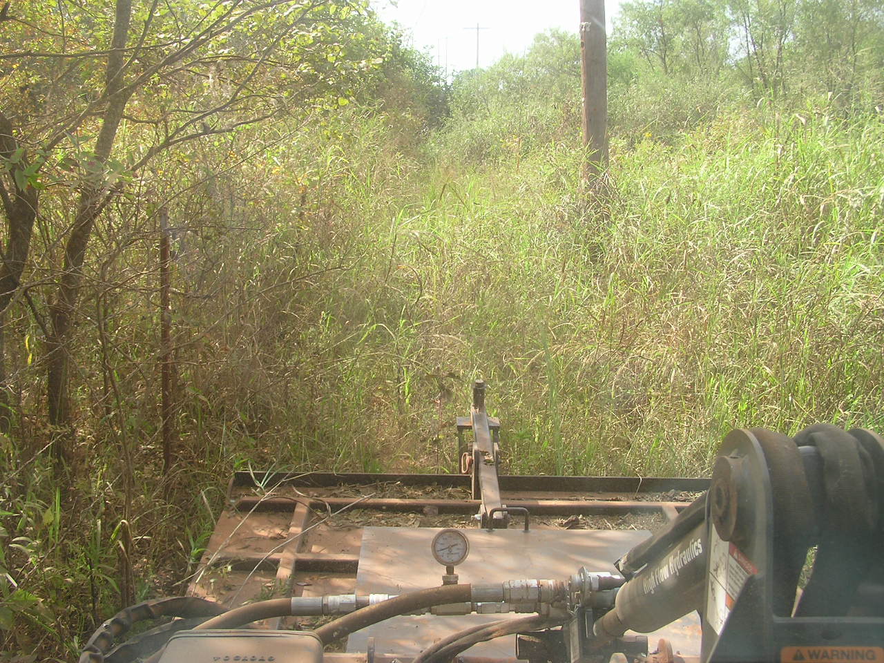

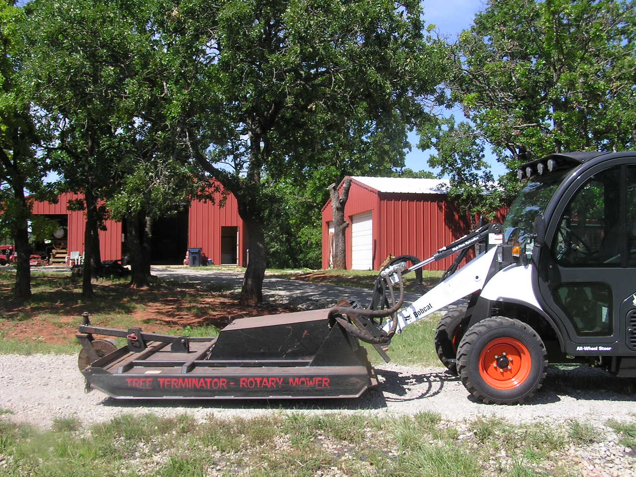

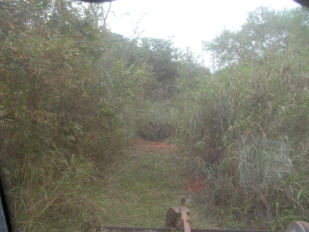

No experience with a mulching head. We use a 7' brush hog, out front is much better:
Mowing close to the barb wire fence, notice the T post:
