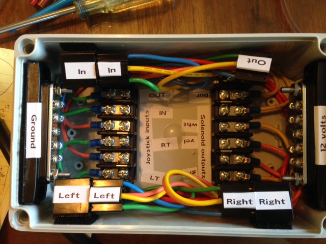

Bill, glad you figured this out. I swear we almost never ever sell a ignition switch for a 15/16 series....so something odd had to be happening. I put some big Cibie lights on my new Jeep. I upsized the wiring and installed relays. My switches only provide a signal to the relay, almost zero amperage goes through the switch. BTW, if you switch those halogens to LED lights your load will go way down, but your wallet will hurt! I installed some big LED's on the Jeep as well, and just for grins I put those through a relay as well but I probably didn't have to do that. Good for you for figuring this out. I dislike running much power through any switch, especially since relays are so cheap.
Here is a relay set-up I made to run my stump grinder. I attached this relay box to the grinder, then I just have a simple electric joystick in the cab (skid steer) that sends right/left and in/out commands to the electric/hydraulic valves. I have one hot lead going to the relay box, and decent size leads going to the valves. Everything else is light duty.
