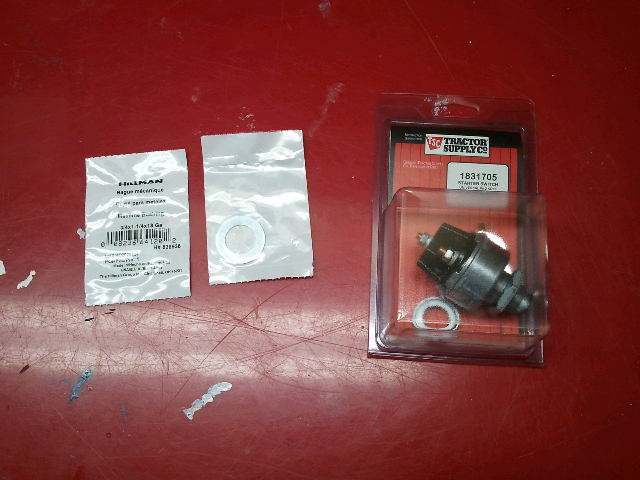

Well here we go AGAIN! Its 15degrees out, its a snow storm, tractor has worked fine all year, go to start it,.....NOTHING!
Troubleshoot it. Failed ignition switch AGAIN!
Just got home from town, had to go find an ignition switch on a Sunday night. Not a happy camper!
   / Ignition switch is junk on my 2615
#13
So I bought a universal ignition switch and some washers to make it fit the existing hole in the dash. I bought it at Tractor Supply for less than $20. Well see how long this one lasts.

By the way I only have about 50 hours on the last OEM ignition switch. DO NOT BUY A MAHINDRA/CUB CADET IGNITION SWITCH FOR YOUR TRACTOR!

Yeah I sure do. I dissected the first one that failed. I have pictures of it somewhere. Basically there is a plastic shaft that run down through the center of the switch. Copper plates or copper plated metal plates have a hole in the center of them for the plastic shaft to go though. From vibrations and what not the plates wear into the plastic shaft creating a groove. Then instead of the plates making good contact they are stuck in the grove and you have no ignition power.

I appreciate the good description. That would sound like a switch with a bazillion starts or a very old switch, which obviously isn't the case on your rig. Do you have extra lights wired into the system or anything of that nature that could be putting an extra load on the switch which might heat things up inside the switch and cause the plastic post to get soft or something? I'm just curious since we see this so rarely and have sold so many of them. We do not have much cold weather, but even so I can't see where that relates to what you saw in the first failure. If you take the second switch apart, let us know what you find, if you haven't already tossed it. Thanks!

Wyld Bill, since you are blowing snow, do you have a hydraulic or electric chute rotator? If electric, is it totally isolated from the switch somehow? Are you using relays? Something out of the ordinary is happening here, even if we aren't smart enough to figure it out. Meanwhile, use cheap switches and carry a spare.

So we have 6 extra lights, electric chute rotator, heater, etc. Obviously you are a sharp guy, but I just think that somehow the extra electrical loads are causing the switch to be used beyond it's designed duty cycle? Not sure, just guessing. BTW, sounds like a nice setup!
