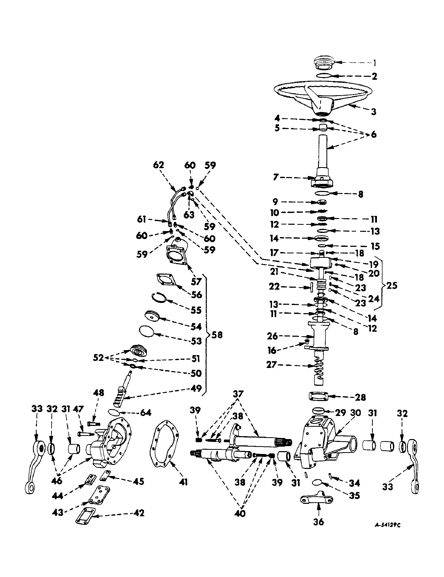

Already posted this in the repair forum, but I haven't gotten much response. Figured I'd try here!
The power steering gear assembly. These tractors are apparently notorious for steering problems. I got the tractor this summer, and it ran great except it was leaking hydraulic oil from the power steering gear assembly (I was going through more H Oil than gasoline!). But it actually WORKED just fine. Tore the tractor apart to get it off, and sent it to a local guy to overhaul. He said he couldn't find anyone who carried a needle bearing (#5 in the diagram). He packed it up and said it wouldn't leak at least.
Now that I have been able to test it, I discovered I don't have the full range of rotation in the steering wheel anymore. Basically, without adjustments, I can only make normal sharp right hand turns and just barely veer to the left. There is zero resistance issues, it just stops prematurely, and completely when I turn left.
My question is: Could this be the needle baring, or something completely different?
It doesn't sound like a bearing to me. Could it be a mis-calibrated gearing somewhere? Like, it was reassembled improperly so something bottoms or tops out too early. If you agree, does anyone want to take a stab at which one?
I don't want to ask the guy that rebuilt it, I don't trust him.
I think I can readjust everything (arms and tie-rods) to balance the steering so I can turn an equal amount in either direction, but its really not going to be enough to be useful. I had the wacky idea of extending the steering arms to get more tie-rod movement for what little rotation I have left. Not sure if that will be good enough.
Any thought would be much appreciated.
-KB

Is the steering valve a orbital valve? As in when you turn your wheels to the left and the wheels stop turning can you still turn the steering wheel to the left?
/ IH 460 Power Steering.
I can't turn the steering wheel any farther to the left. It just stops solid.

I suspect the control rack and the two sector gears were probably assembled incorrectly. You will need to remove the case housing #46 and both sector shafts, #37 and #40. Center the control rack #49, then install the shafts each in center of their respective tooth contact paterns. If there are no marks or stamped gear teeth to match, it may take a trial or two to get the position correct, but doesn't look too complicated. It appears the process could be done without removing the unit from the tractor
I think I got it near 100% now. Thanks for the help. Just a little more tinkering.
