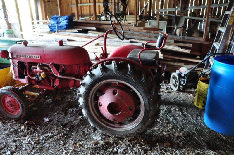

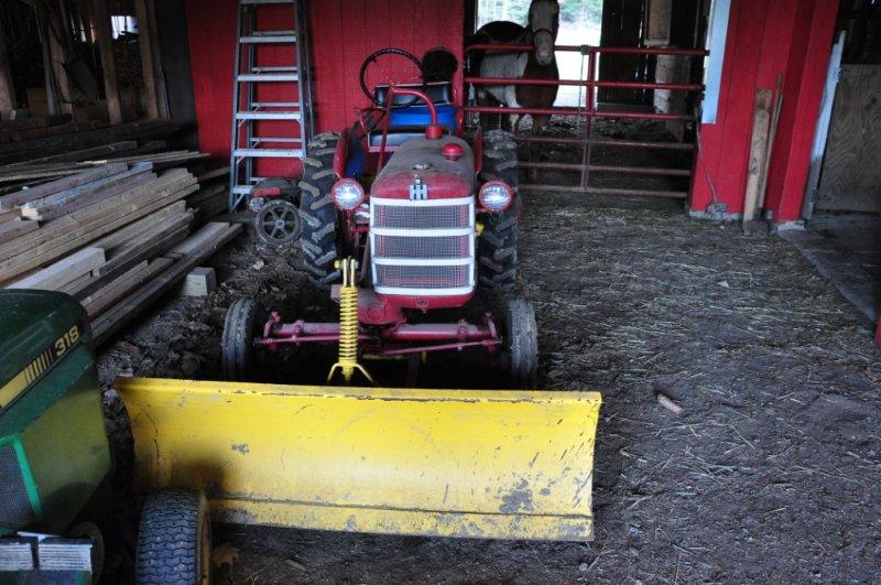

I got over and took a few pictures last night. Serial number is 14389. I think that makes it a '61. The horse wants it gone. )

Get it if you can. Lots of Cubs out there but you don't see too many Cub Loboys. That's the original style seat. Same tractor as a Cub just lower to the ground.

You are right that it is a sixties and they are good tractors.

I did notice that it had an alternator on it fitted to a generator bracket. From the serial number FAQ I found this should be a '61 but the FAQ says the switch to 12V didn't happen until mid '64. It was getting dark and I didn't have time to pull the battery cover. I also want to see if the starter and other items are 12V. My guess it was converted from 6V to 12V. Or it was 12V and someone just changed out the generator for an alternator.

Don't worry about the starter...an original 6V starter works great on a 12V battery...also, no worrys with bad regulators as the alternator is most likely a GM "one wire" with internal regulator...I've been running one on a 57' 230 Farmall for a bunch of years...on the same battery..(uh oh...I guess that means since I said it, it'll die tomorrow...) Get the tractor...great little units BobG in VA

66 was a switch to a 12v GENNY.. someone just scabbed a 25$ junkyard alt on because it was cheaper than the 80$ genny rebuild and 40$ regulator.
I have a 66 IH cub.. oem 12v genny.. etc.
as long as you have a 12v coil.. or 6v coul with proper resistor ( assuming battery ignition ).. then you are good to go.. the 6v starter will take 12v for a long time.. just don't grind on it forever.
manual rod switch don't care either..

Nice machine, glad you are getting it. Any chance you can also get the Deere 316 I saw in one pic? Also a very nice machine.

Thanks all. Actaully thats a 318 in the pictures. Its my brothers mother-in-laws and off limit. Her favorite. Just fixed the starter in it for her. I have a 455 and 4410 now. I did have a 322 a few years back. I really liked the engine in the 322 but parted with it in favor of the 455.

You need to get on over to Farmallcub.com. TBN is for new stuff. FC has all the info on these tractors. Have your S/N ready and possibly casting codes since bolsters were commonly changed out over the years and the S/N plate may not be original.
