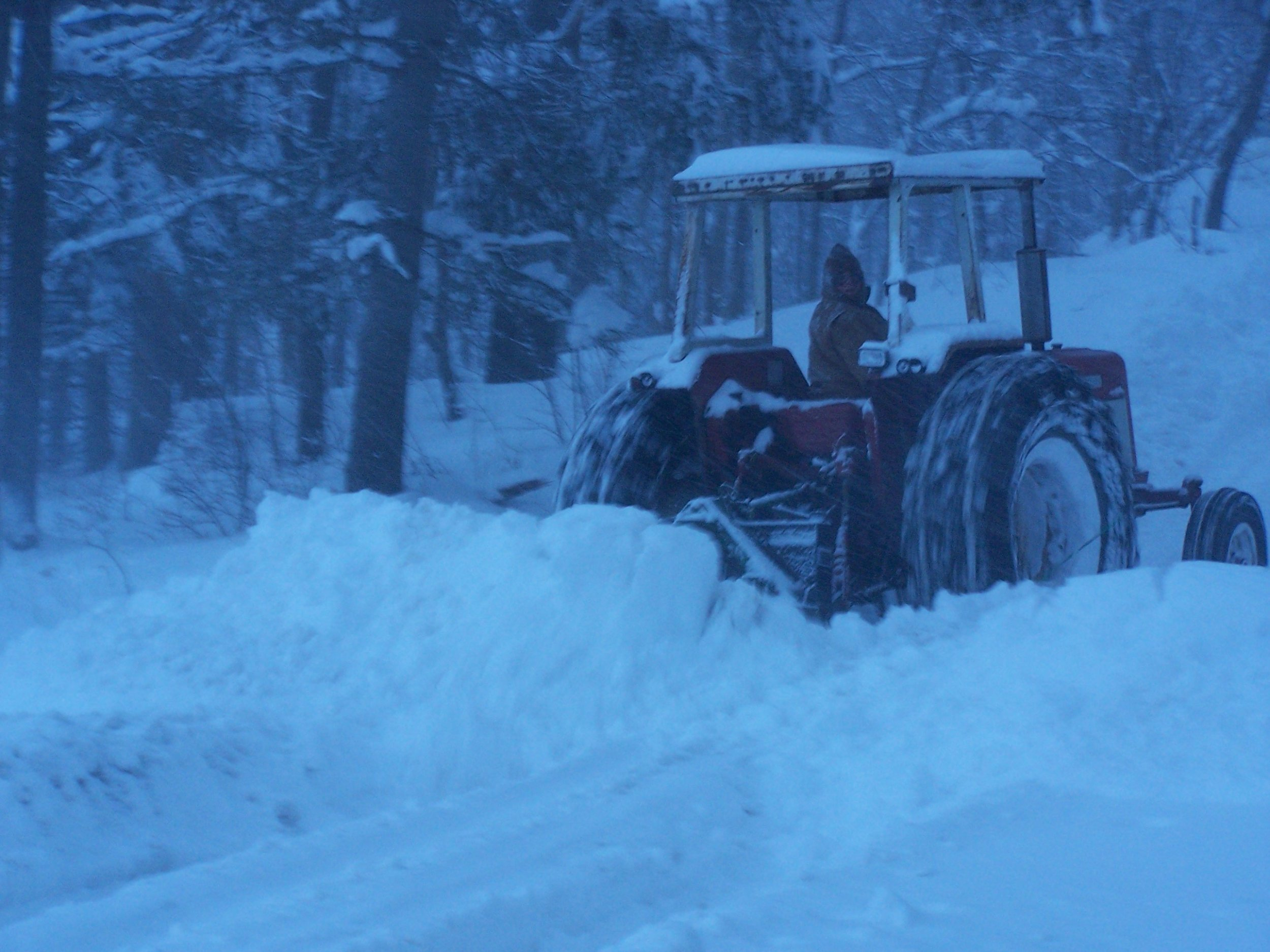

Here's an old pic of my 574 pushing snow with a back blade;
