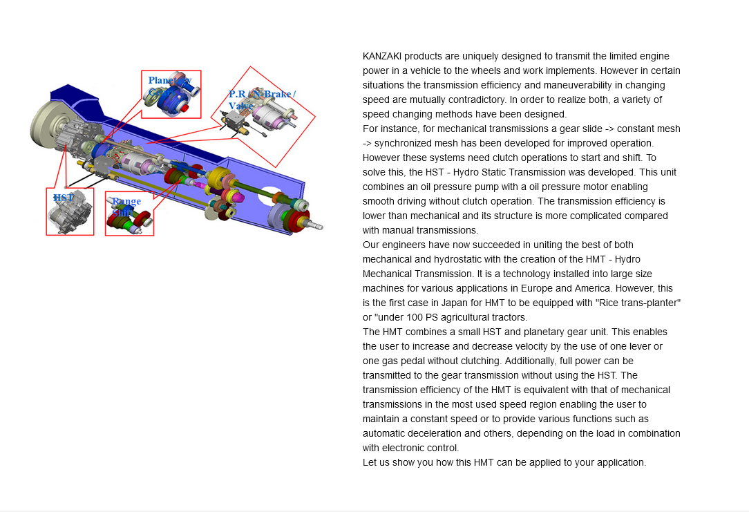

You're thinking of the planetary gears as the ones on the final drives that some tractors have, which only shows you didn't even bothered to learn how those CVT (including iHMT) work.
The key part of combining the hydrostatic with the mechanical transmission, is a planetary gear set. It's all there in the videos and literature, it's just a matter of reading it.
Straight from Kanzaki website:
I've tried my best to hopefully make you understand how the transmissions work, I guess I wasn't successful.
To be honest, I really don't care anymore and I'll keep referring to it as a scaled down version of the Vario, because it's exactly what is. If that wasn't the case, I don't think Yanmar would have the slightest interest on putting "Vario" in their website as well, yet they do. This helps people finding more about these transmissions as there is very little info about the iHMT out there.

It is not a scaled down version of the Vario. I have tried over and over to get you to stop spreading false information. As for your clip, it is a hydro mechanical transmission developed by Kanzaki. It is not the i-HMT, also developed by Kanzaki. Vario is a nice word, but if it used Vario and copied the transmission don't you think there would be a lawsuit? The i-HMT works on the single shaft and has a transmission ECU and draft controller (not to be confused with draft control of a 3-point hitch) that offer precise control. I am not just a technician at a shop, I work with these every day and have a pretty good idea of how they work. As stated in my previous post, the pump and motor being on the same shaft differentiates how the transmission works. They are not the same. Please stop spreading false information.

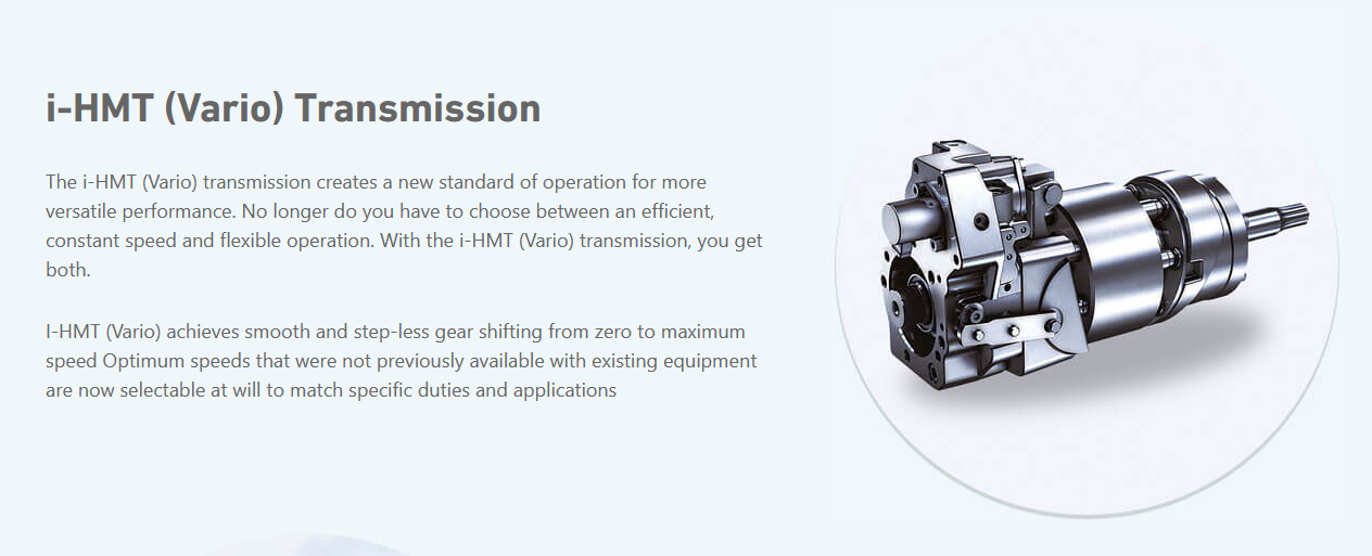

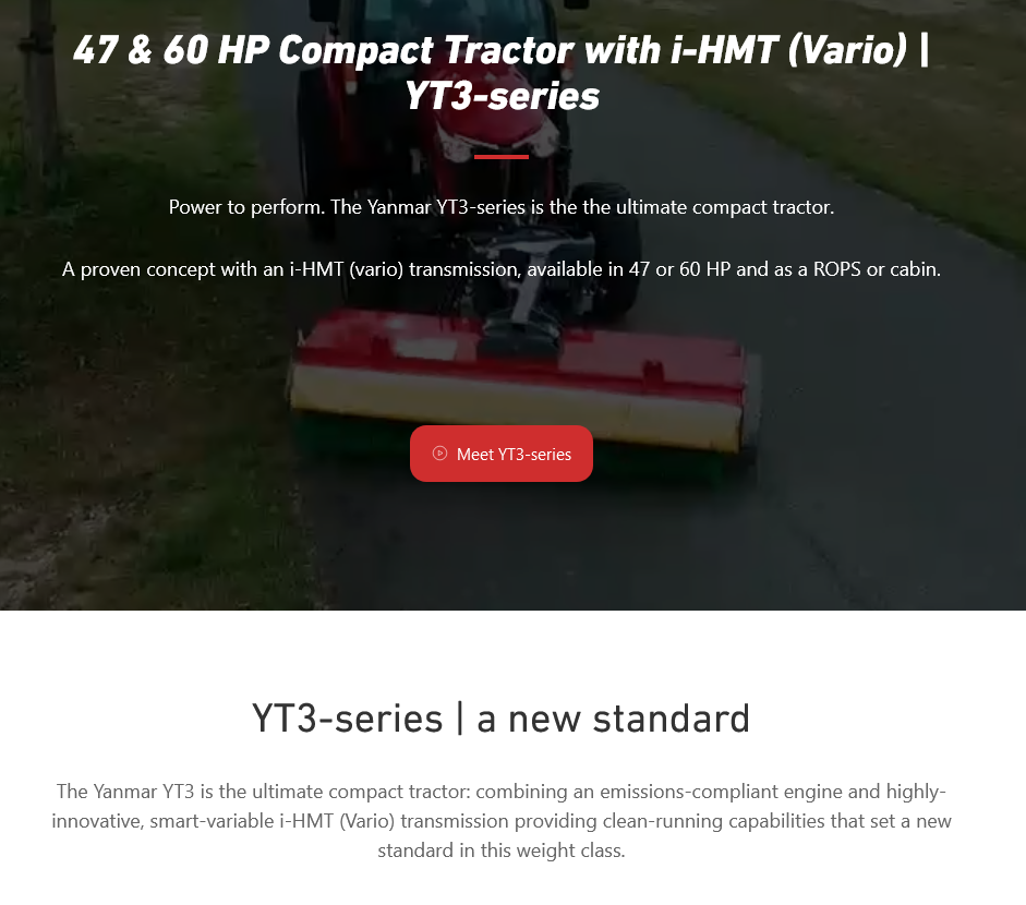

Accordingly to you, even Yanmar seems to be spreading false information on their own website. 🤷‍♂️
Page from Kanzaki, now mentioning "iHMT", since that seems to be a big deal.
Straight from Yanmar website:
I'm sure it's all false information. It would be nice if Yanmar would do a proper video and maybe animation, explaining the i-HMT properly. That video with the guy holding the HST part of it, doesn't even come close to do a good job explaining it.
